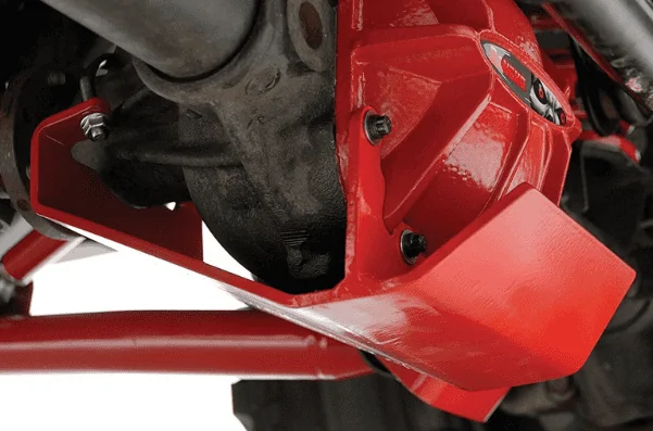

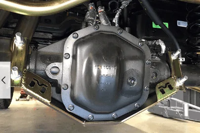

I think you mean a rear truss.
This:
Jeep Wrangler JL Rear differential Skids 1696741111979
mixed with this?
Jeep Wrangler JL Rear differential Skids 1696741140427
I can see where the brackets would be an issue.
