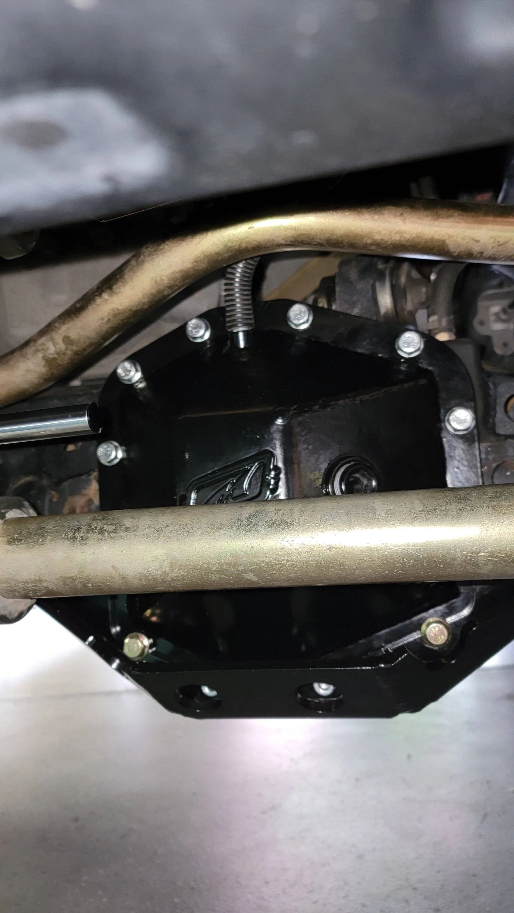

I kept it in house….. went with Dana.. and a Rancho skid, that I color matched……
Jeep Wrangler JL Differential Covers 4E196728-9CF4-4215-83E4-98880D9CCD48

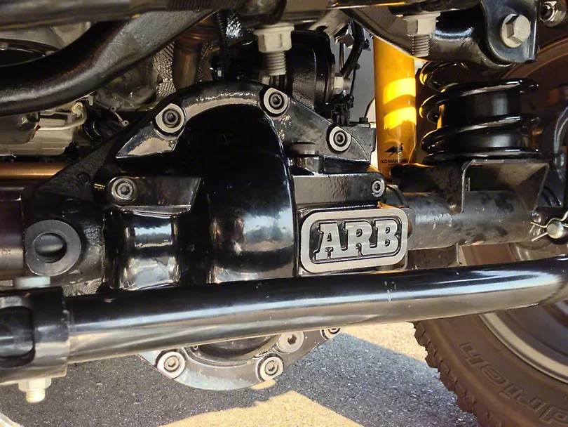

I’ve got the ARB front and rear. I thought they were pretty easy to install and I think they look real nice.
I did have two issues though. On both Jeeps, the bolt holes in the diff housing that straddle the axle tube weren’t threaded deep enough. I needed to use a tap to get the new bolts all the way in. You may not have to do it but be prepared to.
One of the covers also had the wrong bolts with coarse threads included with it. Recommend pulling one factory bolt to compare threads before taking them all out.
This pic is after scwacking it on a rock and I ain’t even skurd.
Jeep Wrangler JL Differential Covers 86F0EEB7-ABAC-4D6F-86F2-978C175B8C9B
Damn, for some reason I thought the Dana covers only fit the U44 axles. They look nice.
