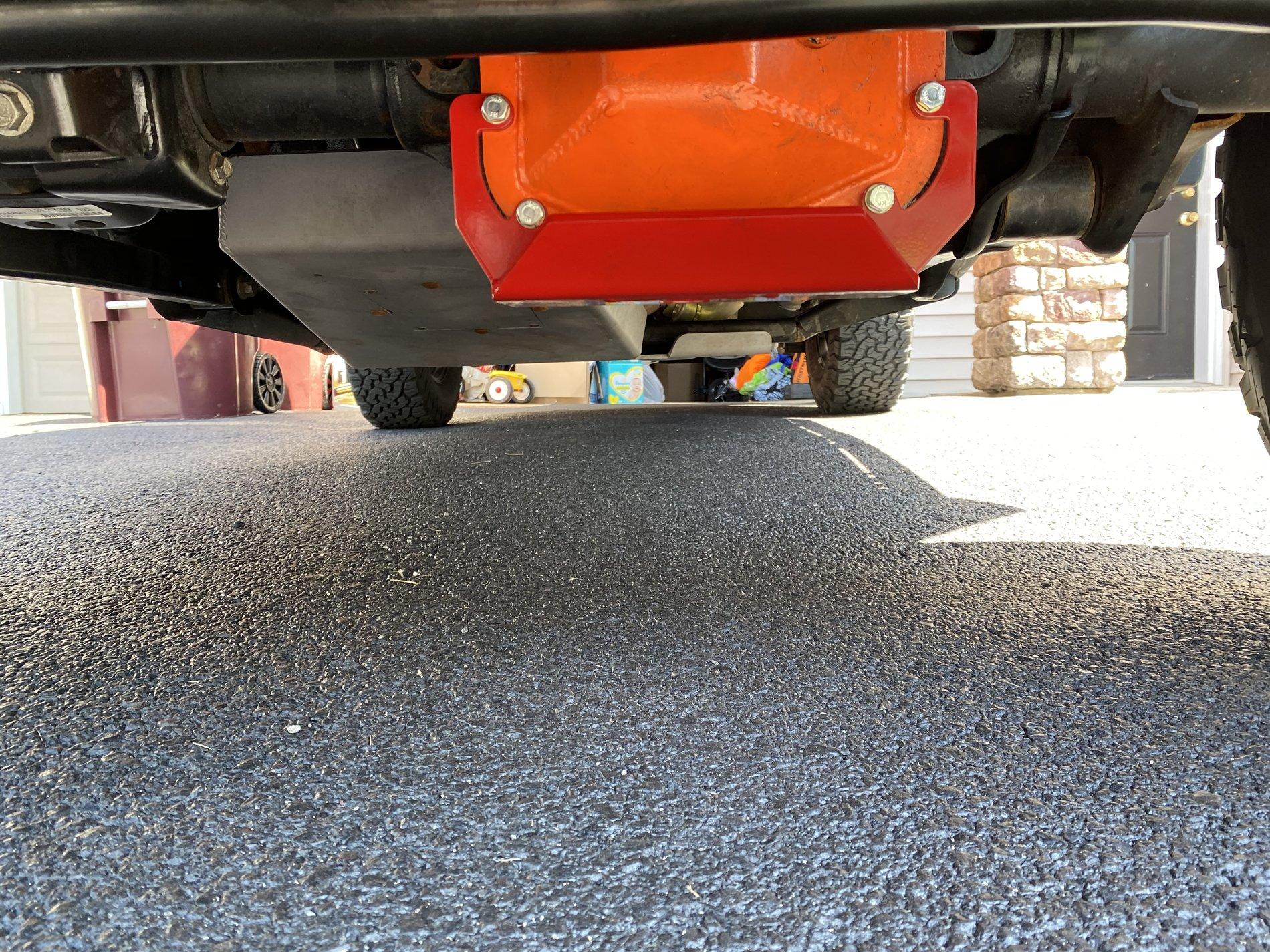

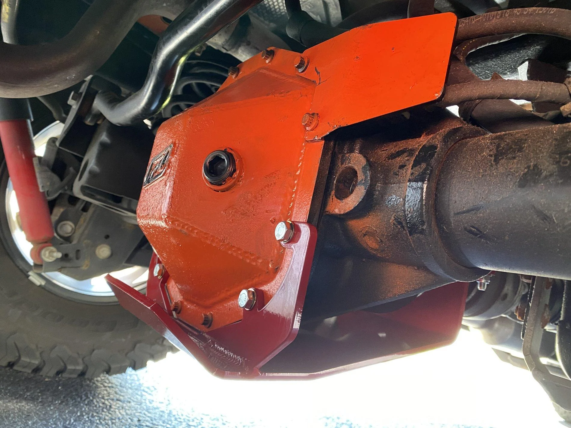

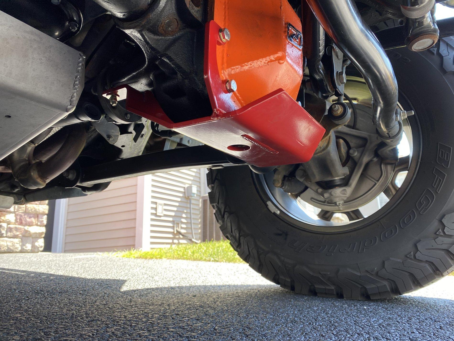

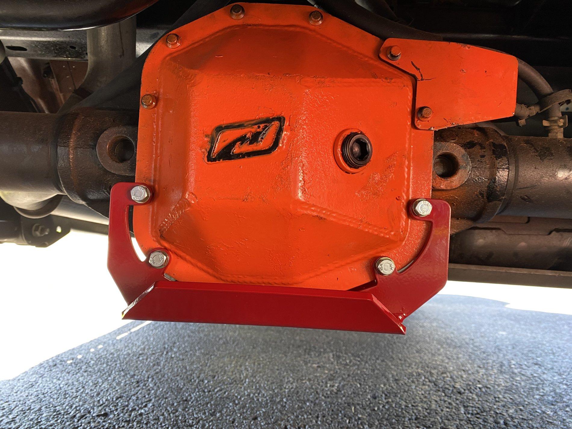

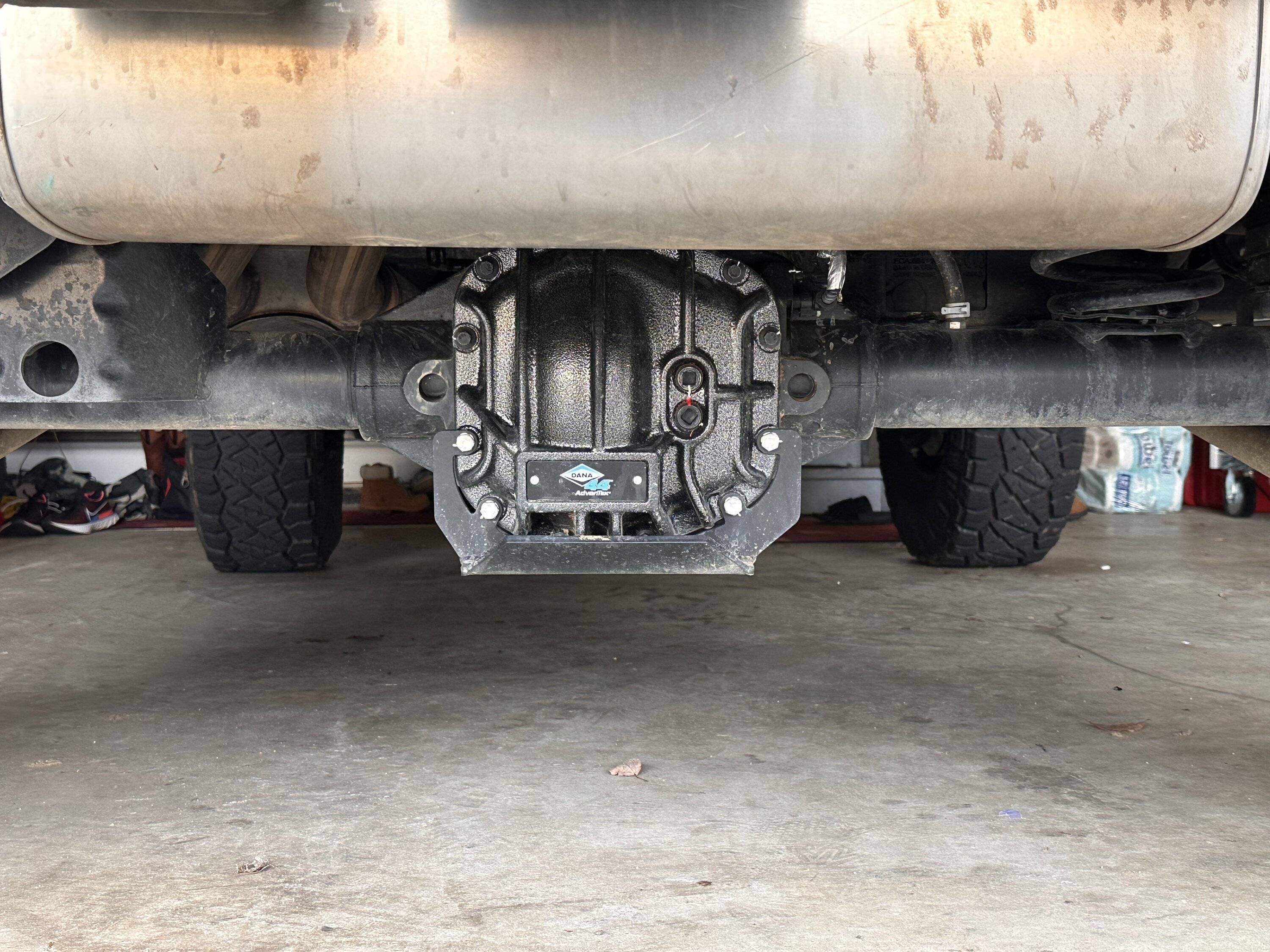

Locker solenoid Guard and rear diff skid finally installed.
Pic of the front Diff skid clearance.
Skid clearances
I also went Motobilt, with Rancho Diff diapers.

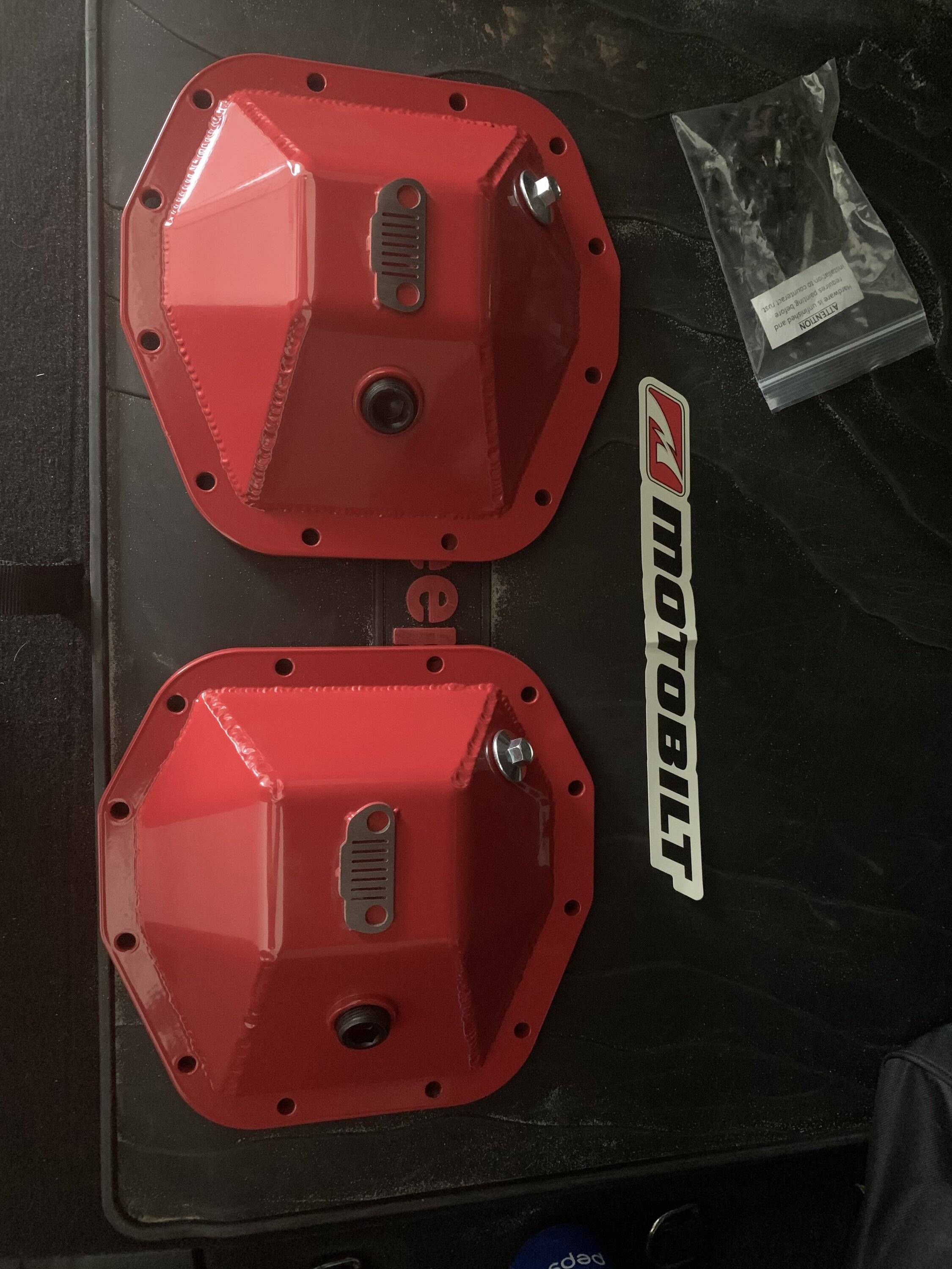

These are a motobilt kit. Tig welded and powder coated red (of course). I added a fill point in the upper corner using Jeep JL oil pan plugs. The grill logo is a stainless steel keychain that tack welded on then sanded
Pretty sure if you fill to your new fill point you will have too much oil in there. The allen plug is the fill point. Add oil until it comes out of that hole. These need to be removed to drain the old oil.
Or am I wrong?
Or am I wrong?
Technically yes, you are correct- but some of the early JL's had drain plugs in the bottom of the pumpkin/ housing- so you could technically do a fluid change without removing the cover. Mine has that and that's basically how I drained it before swapping covers.
Or am I wrong?
I know how to put oil in the diff. Yes the big plug comes out. I fill from the other side because I find it easier. Thank you for your concern.
