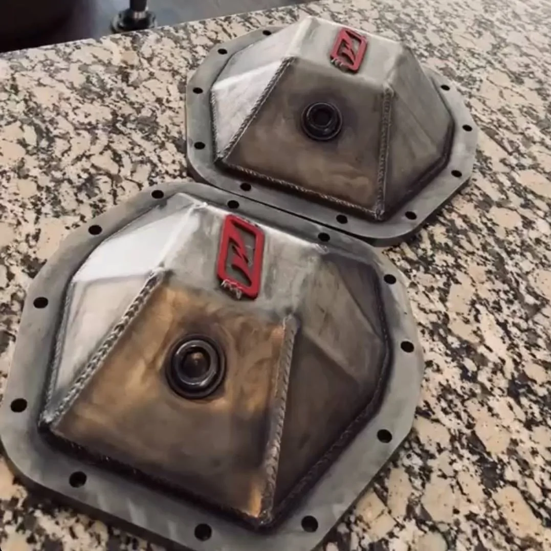

Just a bit about the metals used in various covers.
The stock stamped steel cover is pretty durable. It will take a pretty good hit to damage it. A front diff cover hit could deform it, but likely not puncture it. It's malleable. The other damage is catching the lower edge and peeling it. Still a good chance it won't cause loss of fluid. If it does leak fluid or rub on the ring gear, you can remove it on the trail and beat it out and flat with a hammer.
Cast covers like the Dana and ARB are made from much thicker material and might take a harder hit to damage. But when they do get damaged, it will be a brittle break/fracture. Not much to do on the trail to repair it, except duct tape. The plus side is that it won't likely peel the edge.
The more custom fabricated steel plate types, give the most protection.
Agree, because even though the OEM cover may not puncture, what it can do is fold in enough to hit the ring gear or worse smash the ELD module.
