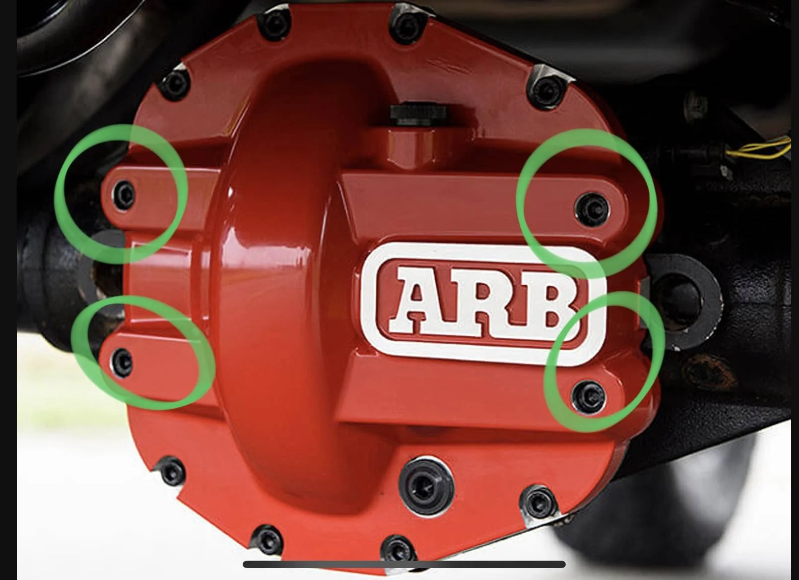

I’ve got the ARB front and rear. I thought they were pretty easy to install and I think they look real nice.
I did have two issues though. On both Jeeps, the bolt holes in the diff housing that straddle the axle tube weren’t threaded deep enough. I needed to use a tap to get the new bolts all the way in. You may not have to do it but be prepared to.
One of the covers also had the wrong bolts with coarse threads included with it. Recommend pulling one factory bolt to compare threads before taking them all out.
This pic is after scwacking it on a rock and I ain’t even skurd.
My ARBs came with different sized screws. The longer ones go into different spots on the diff then the short ones. Basically where they have more steel behind them. Kind of hard to explain. You shouldn't have had to drill and tap anything.
Right, there are 4 that are about 3/8" longer if I remember correctly. I think all of the holes except the 4 that straddle the axle tubes are through holes. Those 4 are also blind tapped (holes have a bottom). The diff cover is also thicker there so I assumed that was where the longer ones were supposed to go.
Lol, well now you have me second guessing but it's colder than a witches tit outside so it will be looked at this spring.
I used the longer ones that weren't through holes IIRC.
Lol, if only there was a way ARB could have passed on this information to the final consumer. ;)

I considered using the longer ones in other positions but they were poking through the casting and it didn't look like there was going to be much thread engagement in the tube holes.
