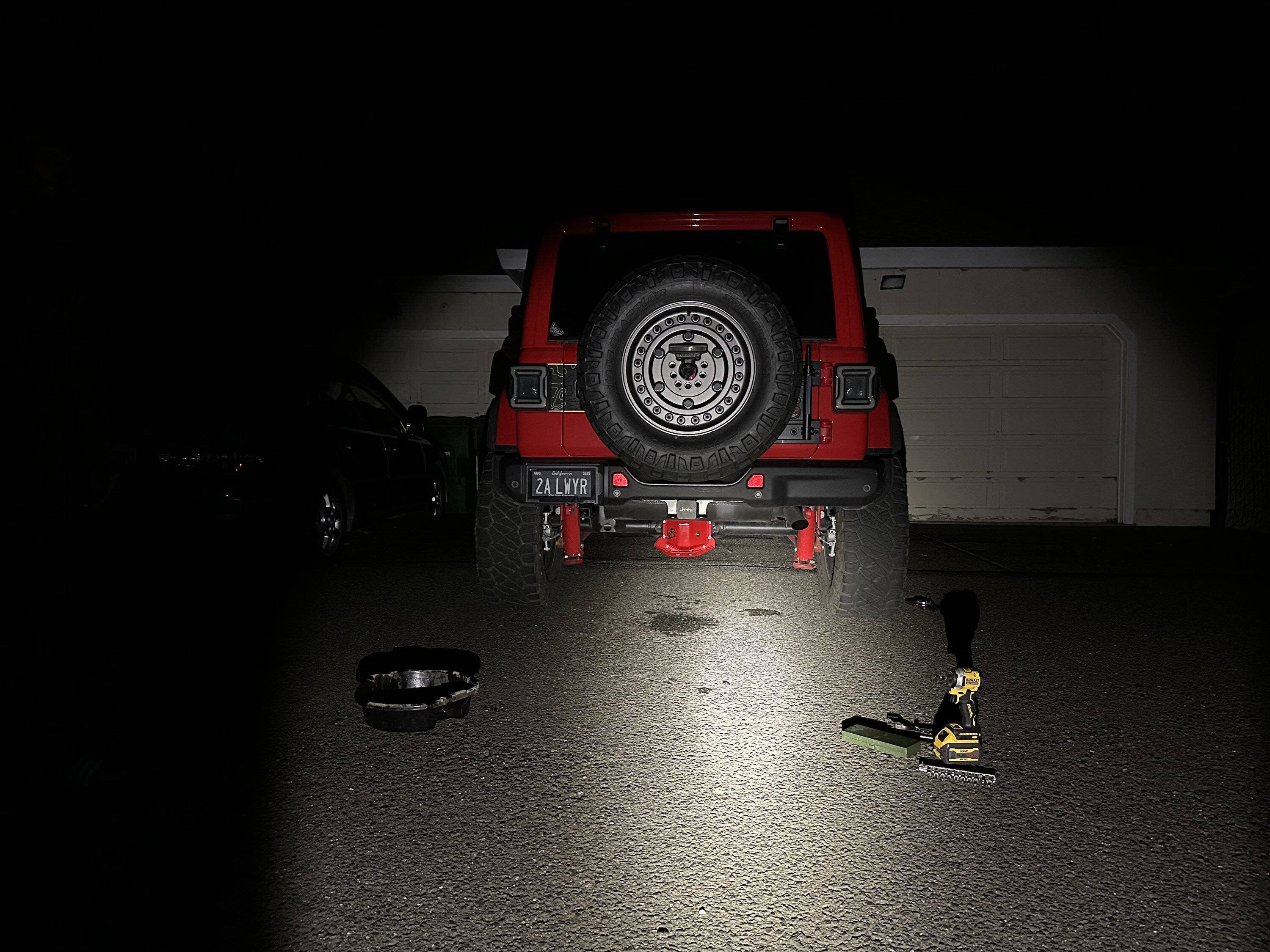

The wide tube front axles on the XR's don't have a drain plug. Just installed the ARB covers front and rear that Santa brought me- definitely a step up from stock!

23 rubicon
I took that as both drain plugs where eliminated. off the top of my head I remember from last week the rear has one, but yet, he's right the front is gone.
wonder why they took out just the front. in any case. the diff skids will make short work of rocks.

I’ll be putting my Metal Cloak skid on the rear diff once I have a nice day to paint it black. The rear diff on my ‘22 XR does have a drain plug on the driver’s side of the pumpkin.

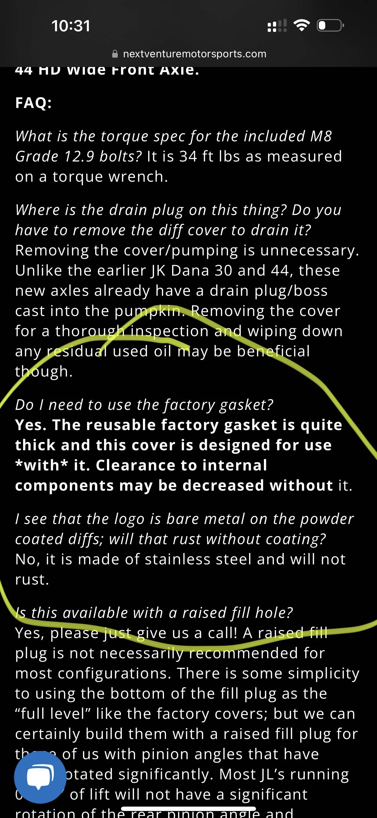

The next venture diff covers are stainless steel. Anyone know what difference that makes over the iron variants or aluminum?

Unless something has changed NV covers are made of carbon steel and not stainless. If they are stainless, they would be no different than regular steel, just more corrosion resistant and perhaps slightly softer depending on the grade of stainless.

Here’s their website FAQ but that may just be the logo the weld to it
