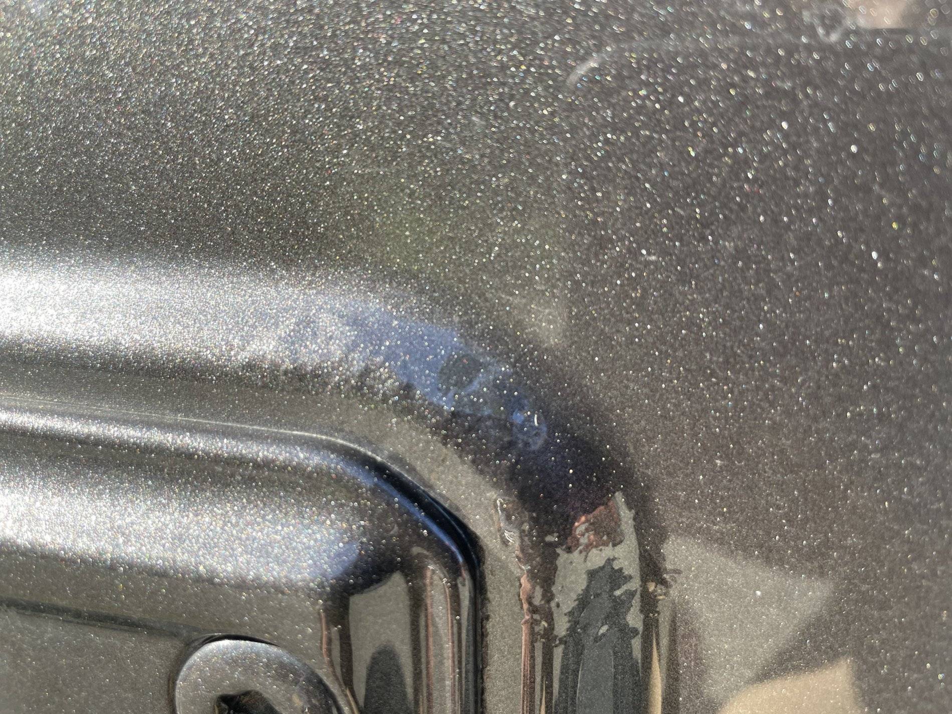

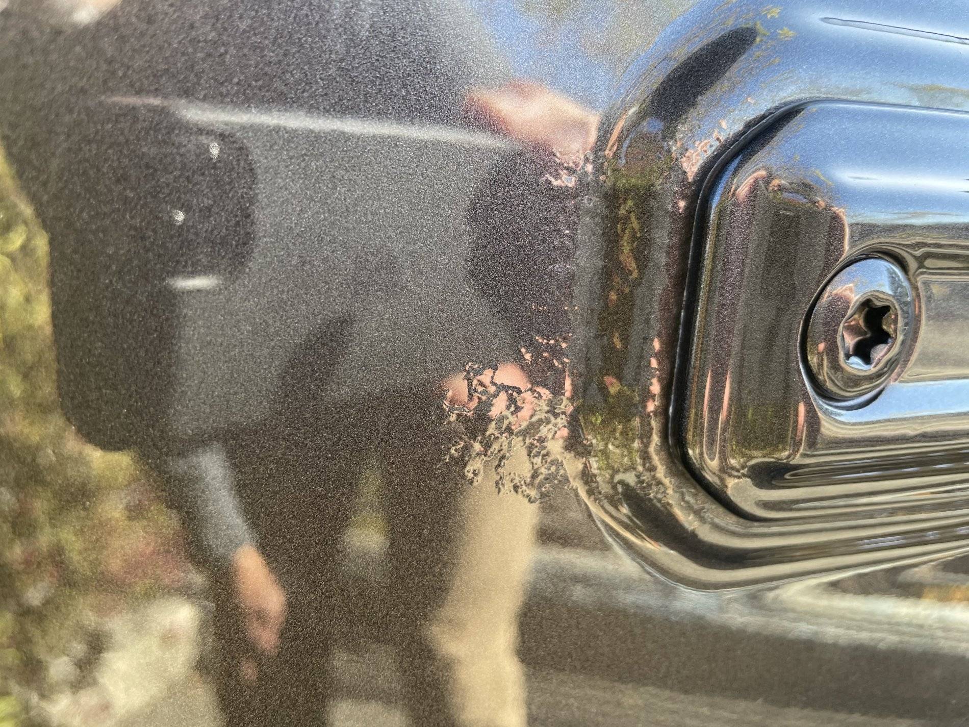

All four doors on my '18 Wrangler Sahara appear to be rusting, which seems crazy given that I live in CA and the vehicle is garaged half the time. I bought it new and have had for 2.5 years. The best the selling dealer would do was direct me to Chrysler Capital or a local dealer. I'm unable to navigate the Chrysler Capital phone tree because I paid cash for the Jeep and don't have a lease/loan account. I cannot get the service manager at the local dealer to return my call. I've been a pretty loyal Jeep owner over the years, and had been contemplating a Grand Wagoneer purchase, but this whole situation really gives me pause about the brand. Any advice?
I would get it real good and dirty on a mud trail, then trade ‘er in (dont wash it afterwards so the dealer won’t see the corrosion)
