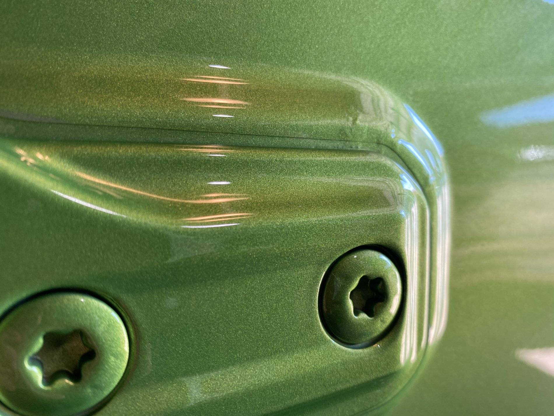

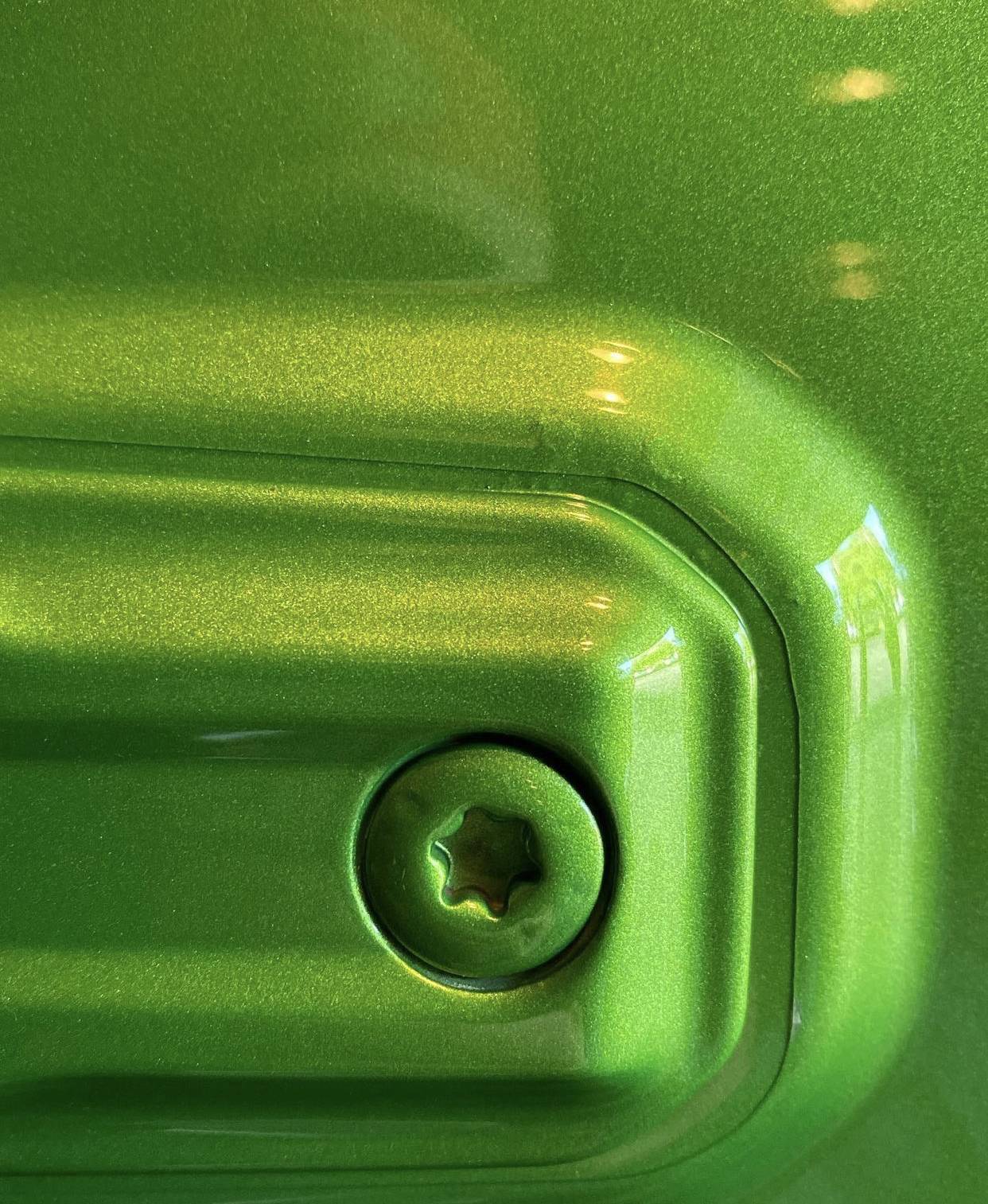

Gonna go ahead and go forth with the fix on mine
June 2020 driver side front door

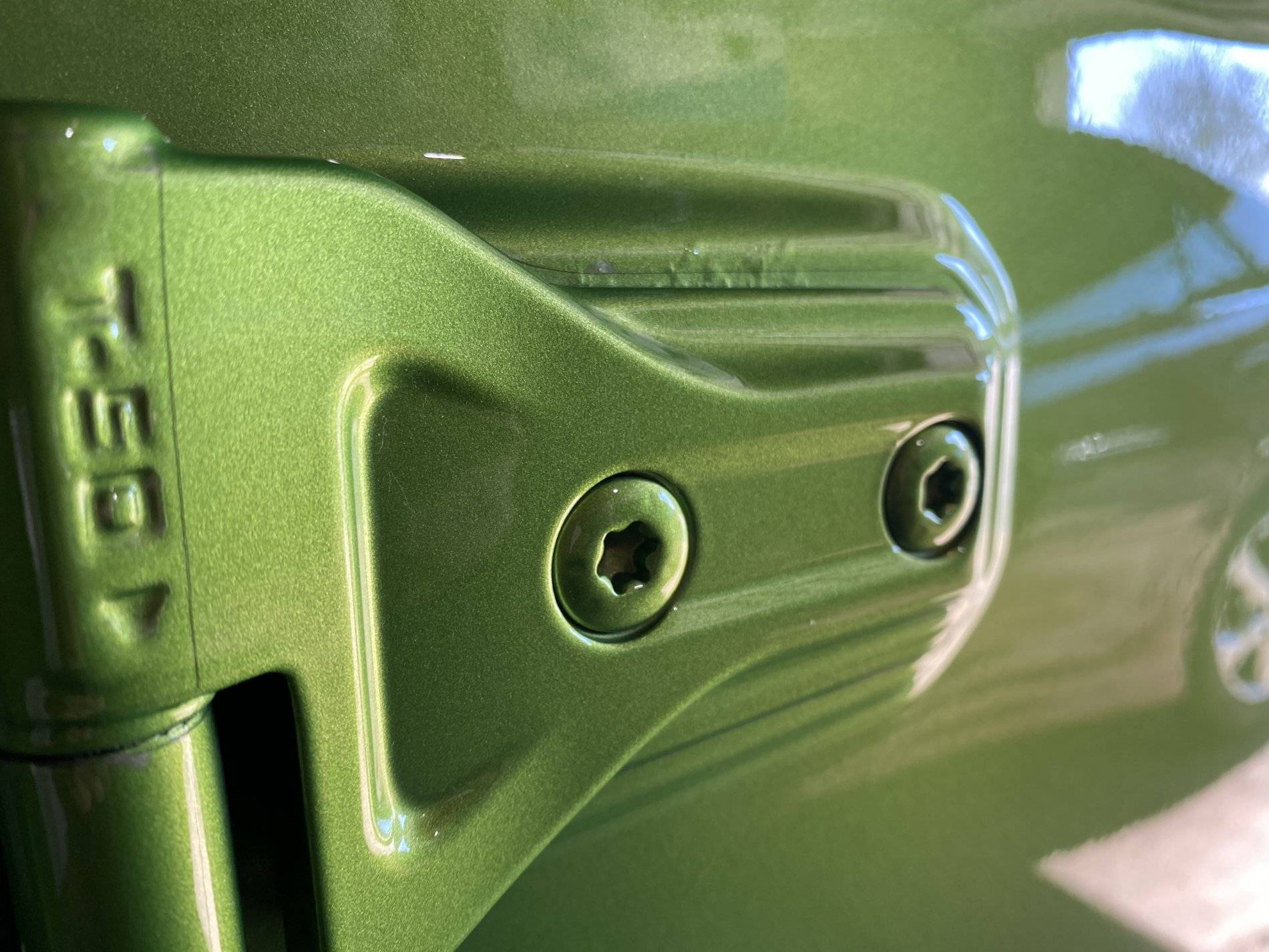

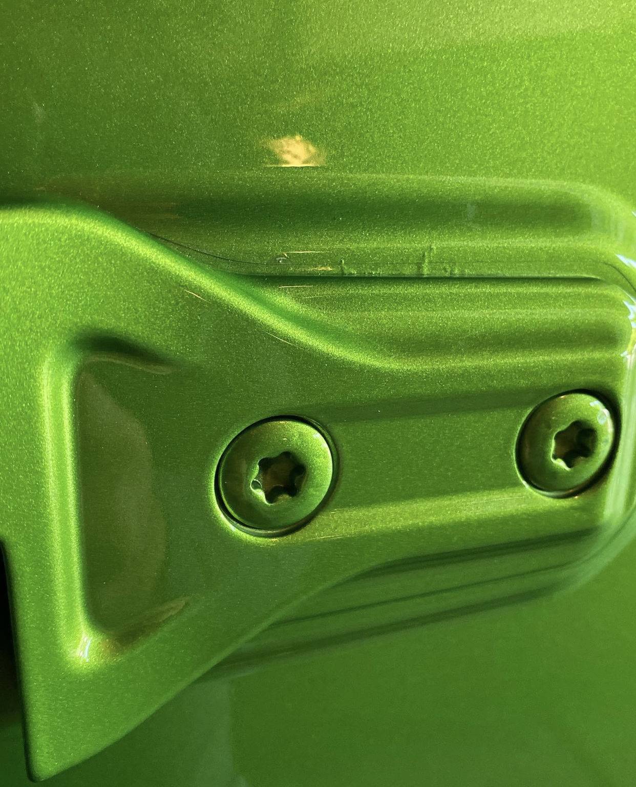

March 2021 Diver side front door
Jeep Wrangler JL Bubbles in Paint at Door Hinges 458BD8E3-48B1-448C-912E-986B3E466C08
Jeep Wrangler JL Bubbles in Paint at Door Hinges 9CEBAF5F-6507-49E7-A1C8-2B70B5C58E2A
For sure growing!!! Jeep has 12000 miles on it. Always garaged.
