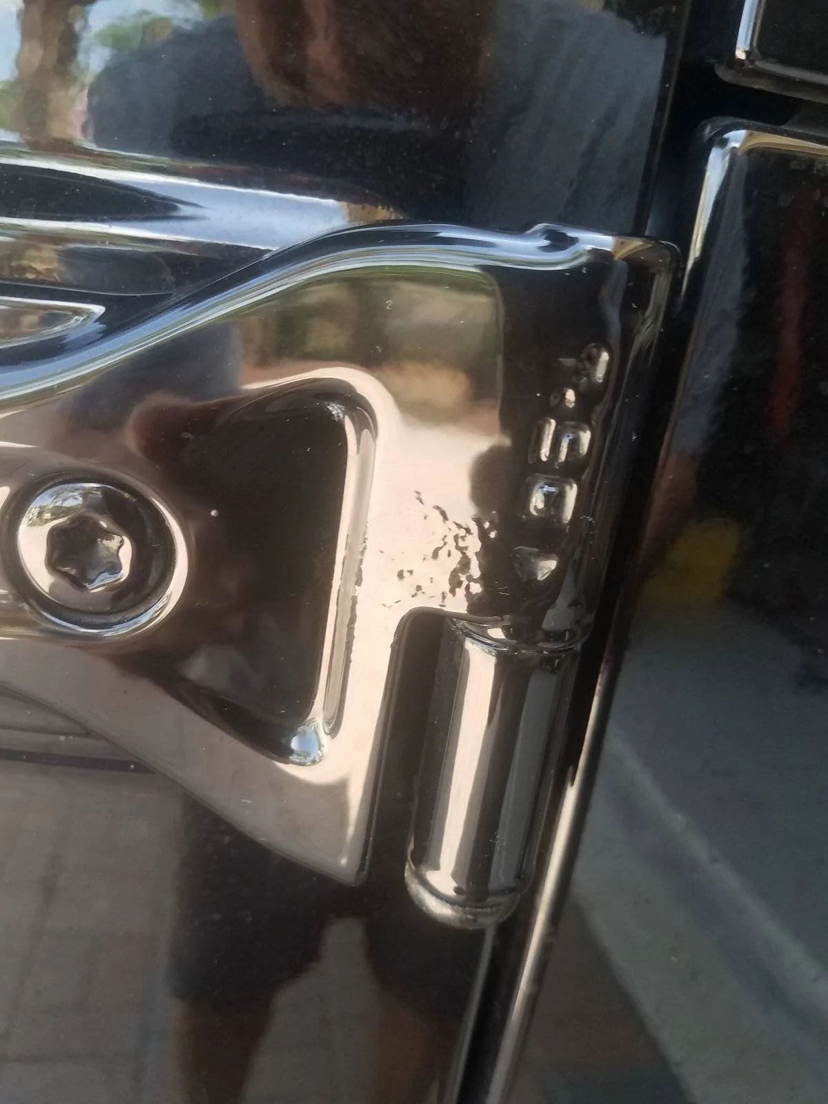

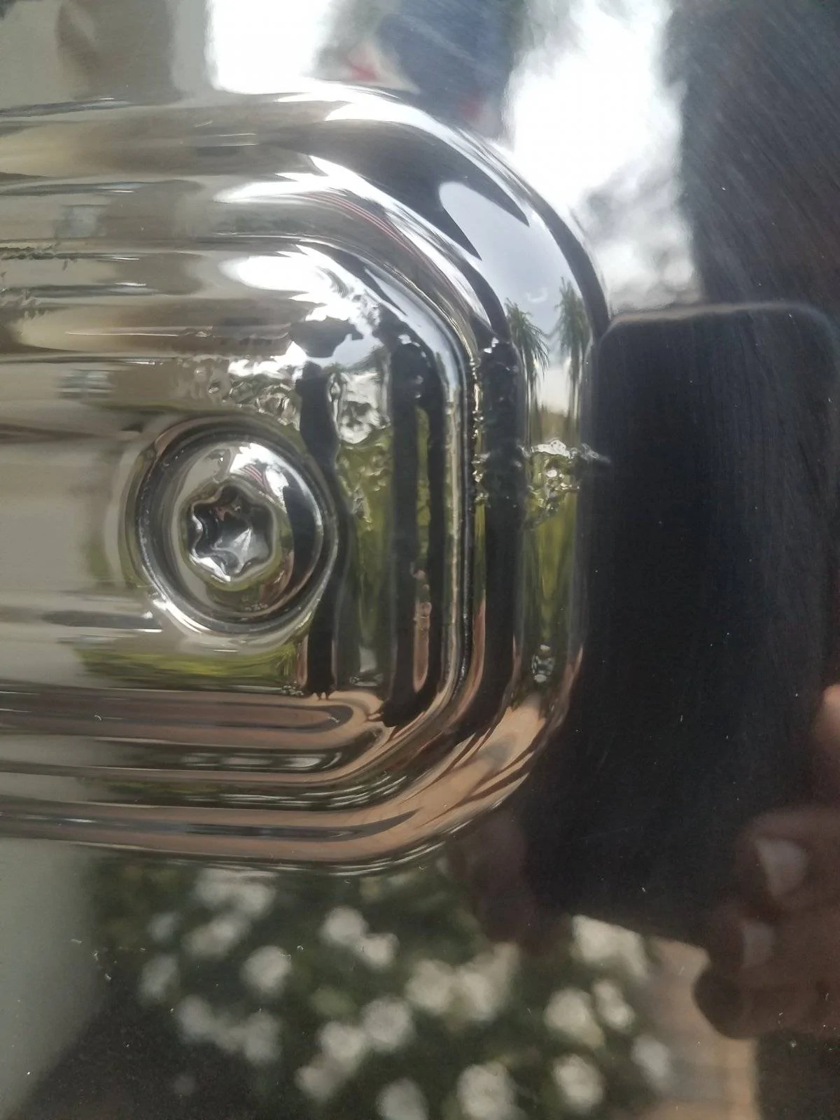

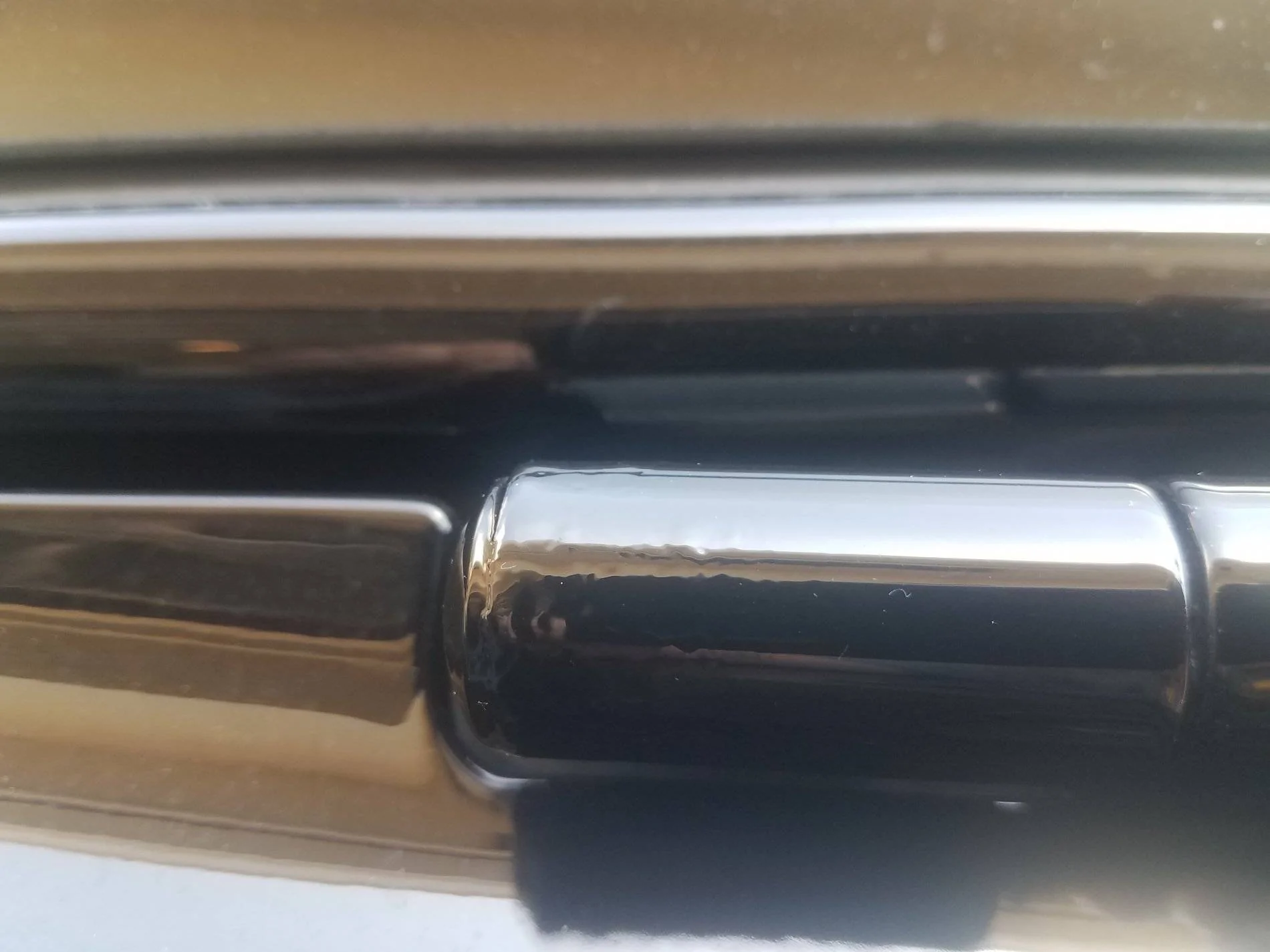

Noticed mine today 40k on 2018 Sahara 3 hinges and door paint bubling. Check your windshield fold down hinges too, mine have it there as well. Great..I sense another dealer battle coming.

Took a ride to nearby dealership this morning. He says I should be covered under warranty but in order to match the color he will need to blend the fender. If they fix it right and solve the problem great. But I have a feeling my Rubicon I worked so hard for is going to look like a turd after repaint. I'm sick to my stomach over this
I'm feeling the same way..Who knows where else these spots will begin popping up, a 53k jeep, garage kept, immaculate, yet repainted..in spots. Good luck on the resale.
