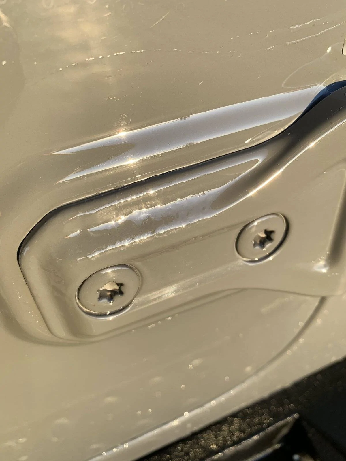

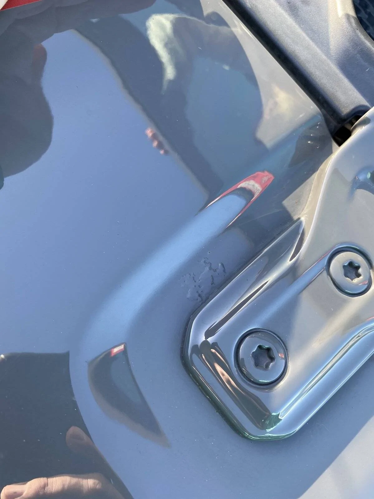

I just discovered bubbles on one of my hood hinges today, I'll be going to the dealer for this to be covered under warranty.

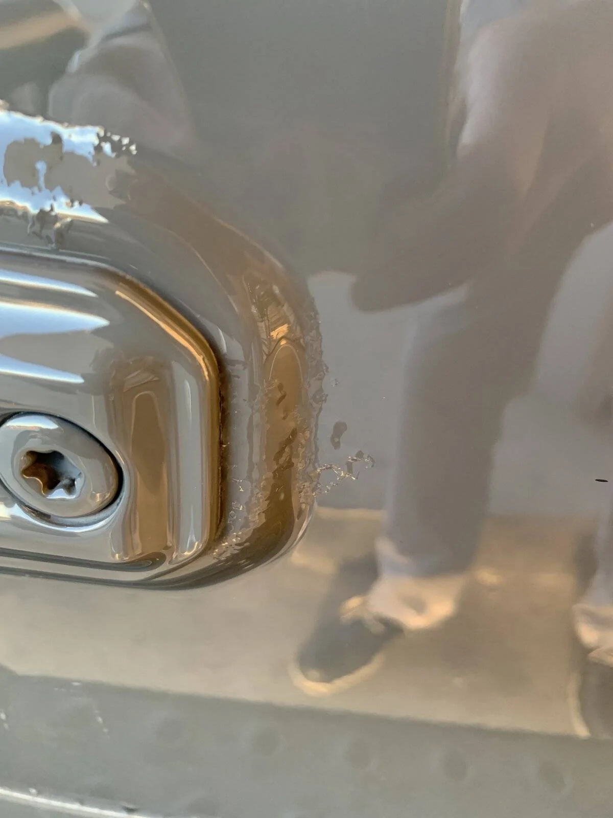

I have a 2018 Rubicon Sting Gray and had several doors and the hood repaired a year ago. Now my jeep is going in to repair new paint bubbles in new places and in areas that were already done. I had about 34K miles when the first repair was done. I have not noticed an issue with the hinges (will check tomorrow). Mine has been along the bottom and sides of the door and hood.

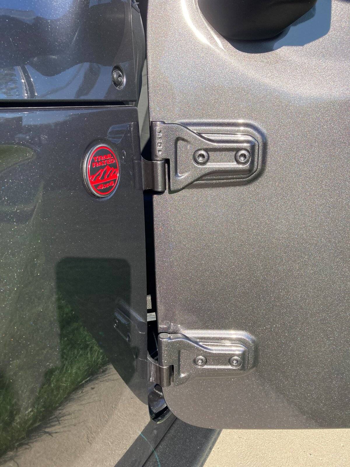

FINAL re-spray. Still a couple spots of dirt in paint and they owe me Jeep emblems for front fenders. Can't believe they removed and were not even going to reinstall until I pointed it out!! Paint match is much improved - not perfect - you can still tell difference in sunlight between b-pillar and doors and the tub and doors. We'll see how it holds up. Everything was painted UNDER hinges.

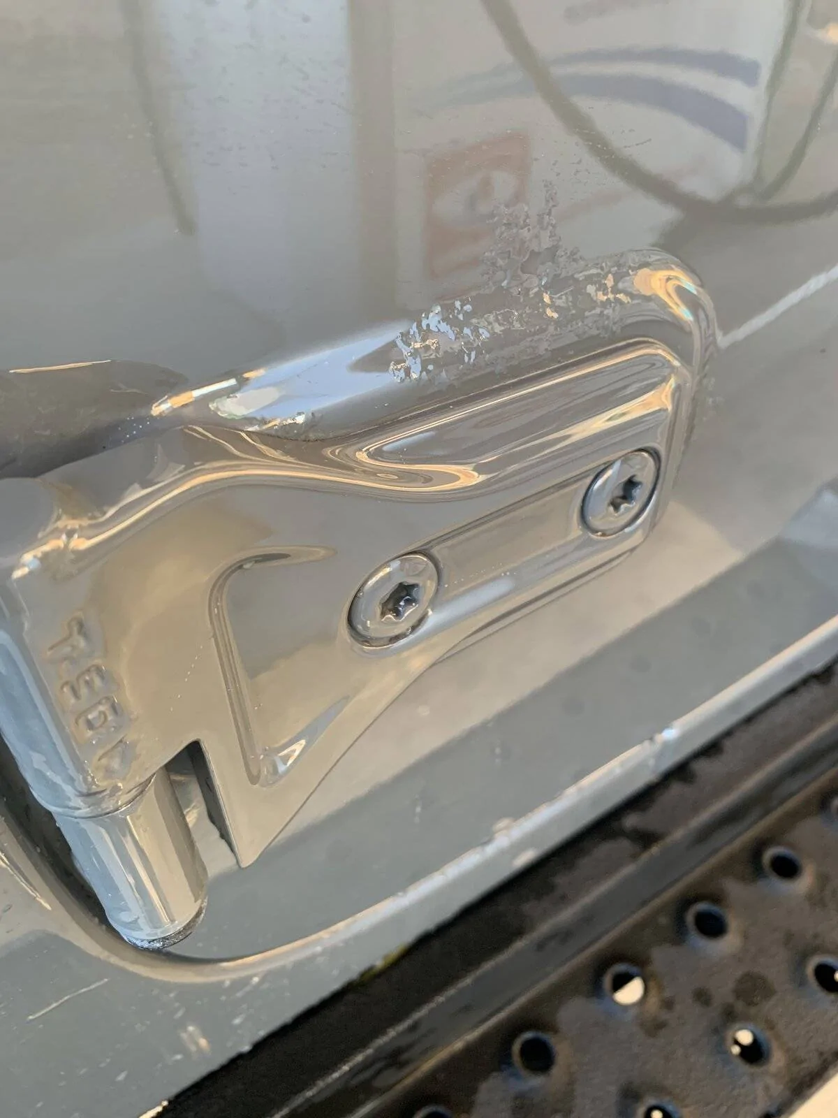

On the JK it was just the hinges. Far easier and cheaper to fix. Now its the doors, hood, tailgate, and hinges.
