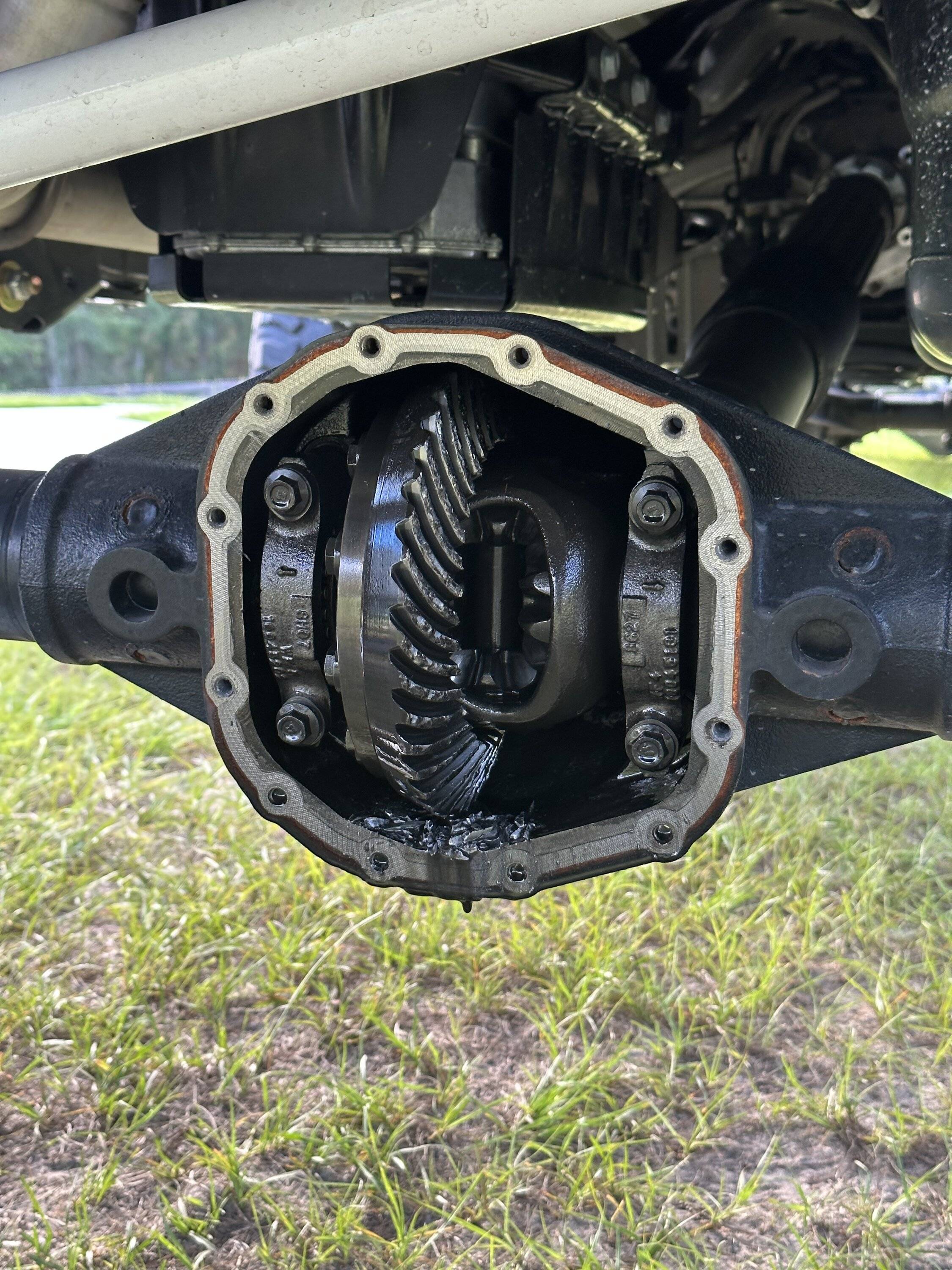

I have a 2019 Sahara Unlimited with 32k miles on it and I had the ring gear absolutely shred to pieces while driving on asphalt…..never off-roaded. I went to my local dealership and was told “any modifications void warranty,” and I said that’s not true, that you have to prove it, I found the act “1975 Magnuson-Moss Warranty Act.” Explain to me how I am denied by a dealer before they even look into the issue. @JeepCares

Your post doesn't provide sufficient information for us to offer an intelligible response or to join you in your outrage. What size tires were you running? Stock? 35s? 37s? 40s?
(As an extreme example, you can obviously shred the ring gear on pavement with 40" tires and that wouldn't be a warranty issue.)

42s. I get it’s 100% possible and that’s not what I’m arguing. The problem I’m having is it needs to be proven according to the law and that was not done.
If you are running 42's and 3.45 gears, there is not much to prove as to whether or not the design capacity of the axle has been exceeded.

As you know, running 42s is a lot more friction and requires a lot more force on your ring gear than stock tires do. I am surprised that your teeth lasted as long as they did. Look at it as an opportunity to now re-gear to a better ratio for your 42s.

Lol you might as well have driven it off of a cliff and asked for warranty repair. No. This is because of your mods.

Lots of deleted posts by the OP in here. Anyway…… 42s on stock axles and you want a warranty claim…..????????????????????????????????????
What I don't understand is that even if the warranty did cover him, his new 5.38 gears will probably arrive before the dealership has the replacement 3.45s installed anyway.

But...5.38s will not save him either. The extra 3.5" of leverage of 42's versus 37's combined with the width will still exceed the capacity of the axle. Wrong use case...
