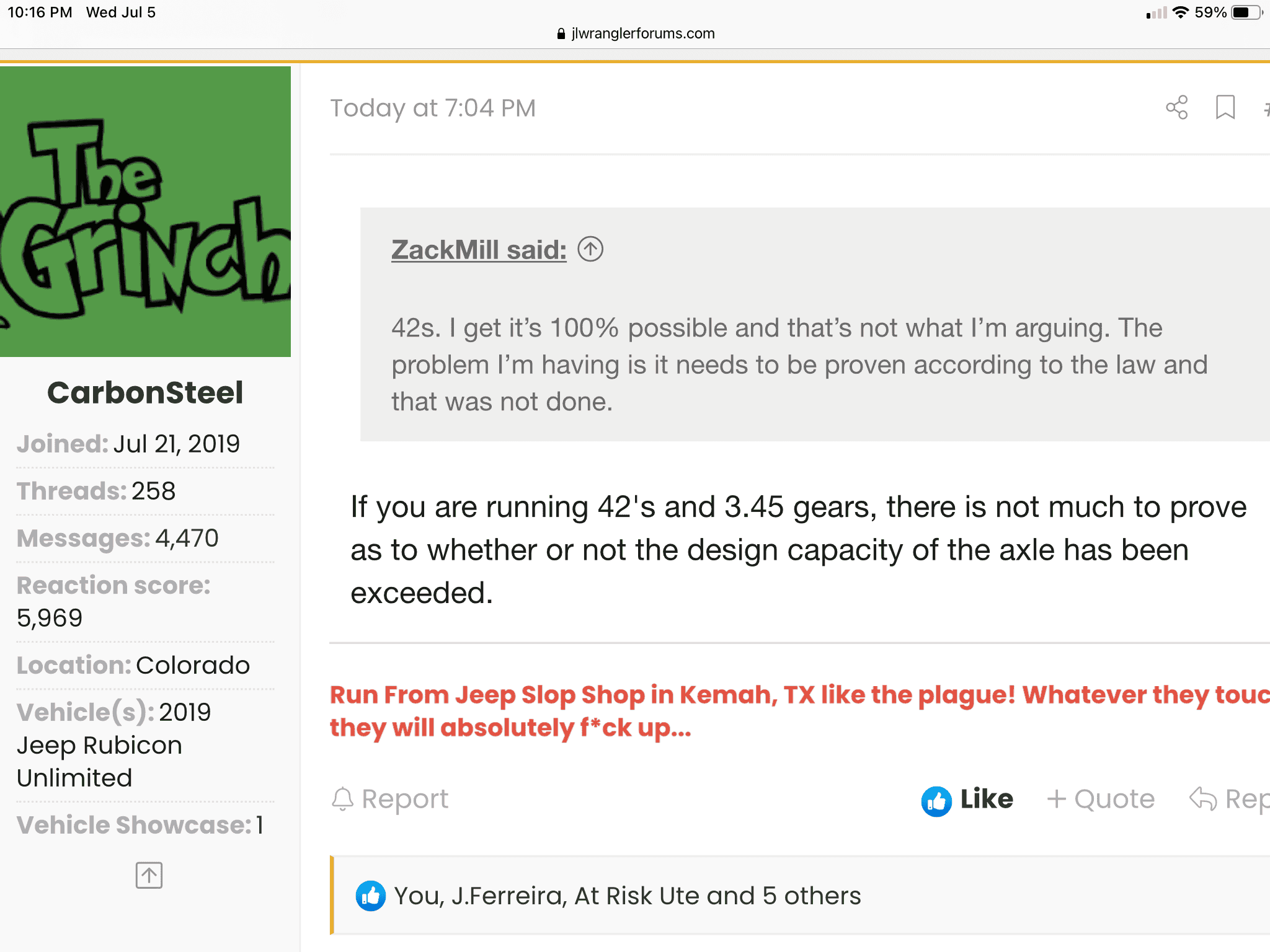

If you are running 42's and 3.45 gears, there is not much to prove as to whether or not the design capacity of the axle has been exceeded.
Thanks for capturing the OP’s quote for us to see; apparently it has subsequently been deleted.

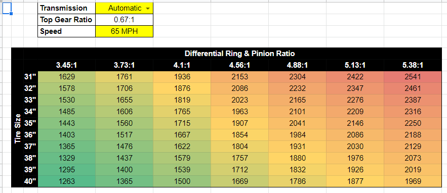

RPMS will be almost the same as a rubicon on 33's with 4.56 gears. Thats the correct ratio for a 35" tire. RPM will be fine. Much better then not regearing and thinking its running fine when all you've really done is turn your 8 speed trans into a 6 speed because it never leaves 6th gear.
Here I thought I was rolling dice running 40's on fully built rubi axles lol.
Ton's of charts out there that will show you exactly what your RPM. Wow you were even over 1700 RPM with the 42's and those gears. Was it in 5th gear all the time?
Also a JK chart……
I see you updated it….

Also a JK chart……
touche - I should have just used Andee's spreadsheet. I had that one saved from my JK and wasn't paying attention good catch!
Damn you would have been even lower on 8th then what was highway gear with 42s and those gears running in? I don't even know what gear that would cruise in on the highway.
Updated chart.
