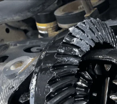

Nearly everything these days is 2 cut.
Most failures are due to setup or abuse. Easily 95%+, anyway.
proper setup is always key to a smooth running gear set
The latest 2-cut manufacturing process, which benefits manufacturers by speeding up production, is not optimal for gear loading.
I'm not surprised that the teeth are failing at the top.
at this stage, I expect them to.. just take a look at the patterns below

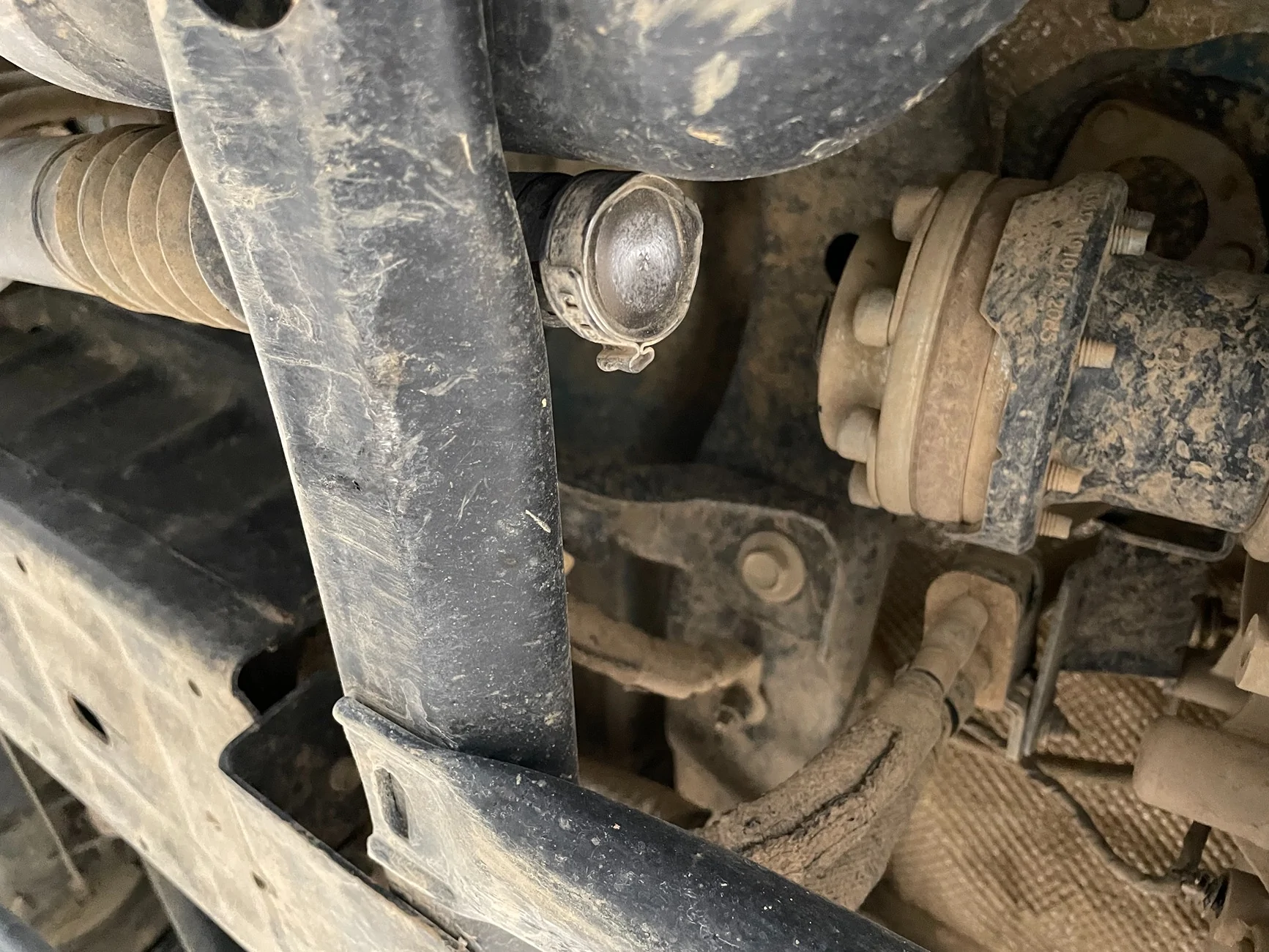

I did some bouncing around one time (Honey Badger)... broke my driveshaft clean. This was at the top of Top of the World trying a stupid line I knew better than to try. Lol. It bounced one time and snap. I thought it was the gearset at first but was relieved to see it was just the driveshaft.

Most likely occurred from bouncing then hooking up. I had similar breakage on mine (around the outer edges of the teeth) and the shop said that typically occurs from a bounce to a full on hook up.

@kah.mun.rah Zoiks! Reminds me of driving home from our first Rubicon trip, my buddies Toyota Xtrracab with front IFS, 4" lift and 35s...after hitting pavement, air up and starting up highway 89 his trucks sounded like a heavily loaded helicopter coming in hot! Pulled over couple times and knew the rear gears were already done, so he drove couple hours back to my house, where he stayed for couple days while getting a new ring and pinion setup to reinstall and drive home. Sometimes ya gotta do what ya gotta do and we were just happy to make it all the way to my house. :/
Edit: and after looking at two cut vs five cut it's easy to see why 2-cut is way inferior.
