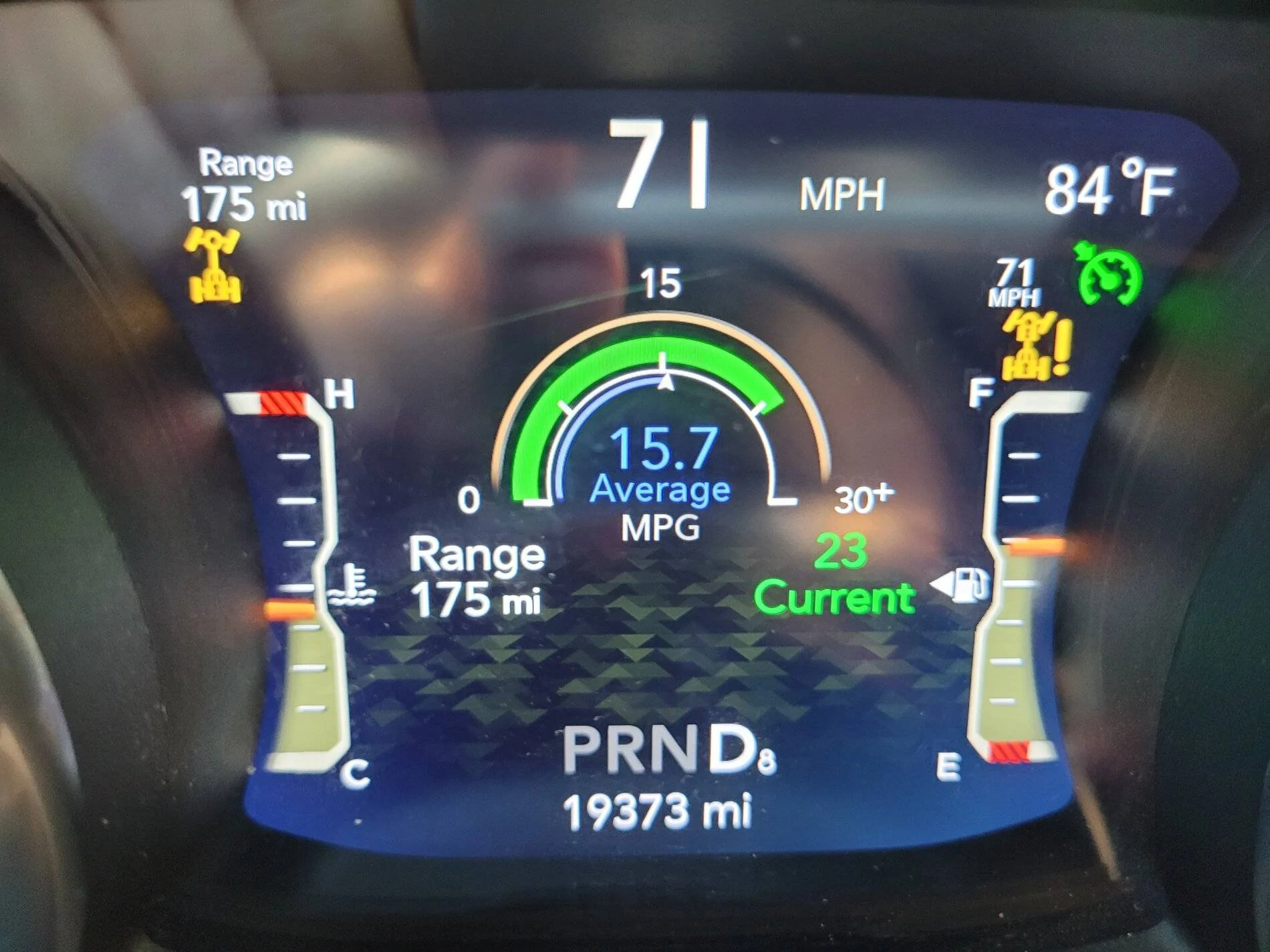

Rear locker blinked occasionally in the past week and now this ??‍♂
The absolute minute you get your brand new Rubicon home, pot the sensors...
Yours may be a little too late, but this should be a warning to all new Rubi owners...
Every week someone new is posting about their locker lights coming on.

The dealer won't know you've done it. If they do discover you've potted the sensors or broke into the axle housing, they may not cover that axle any longer; very similar to a re-gear. This all depends on the dealer and could go a dozen different directions.

All Rubicon's as of right now. Up to this point, there is no documentation saying the sensor has been improved upon.
