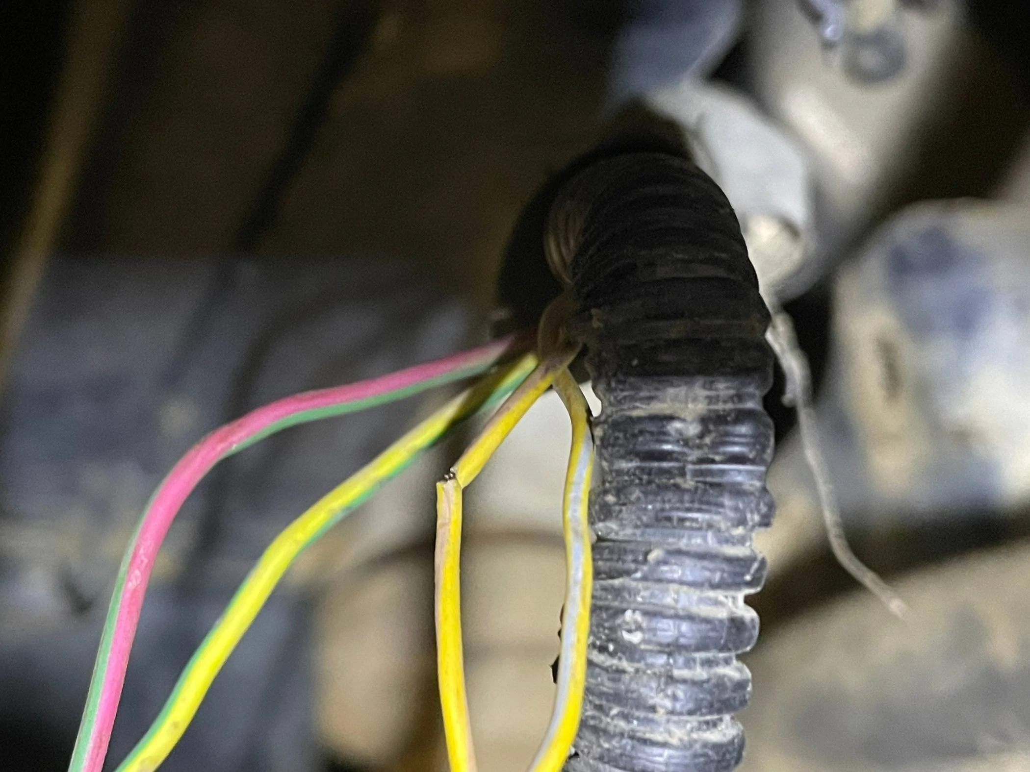

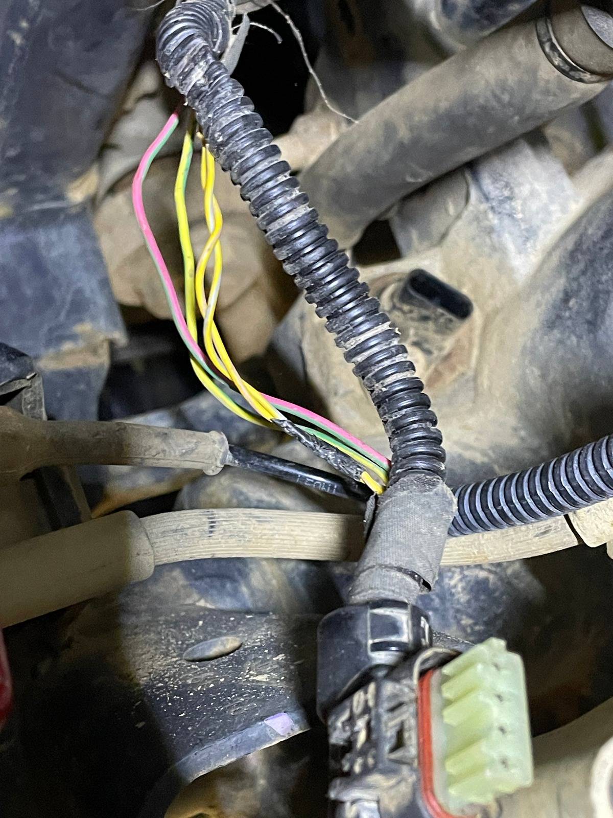

2018 JLU Rubicon 59000 miles and out of warranty. I had the warning light and ding come on for a while now. There is no clear information on how to fix this issue. I searched the forums and finally decided to try the Z Automotive sensor bypass and it did not work for me. I put it in front and rear with no luck. Ran it for a week in both places. I have read It does work for some but not for me. After months of relentless dinging I finally bought the replacement sensors on ebay and oil and put them in. I still had the same issue plus I had the locker warning light on now. The lockers would not lock and the sway bar would not disconnect. I had read of the wiring harness at the front locker can have a break at the connection point on the upper control arm where it is zip tied. As you can see in the pic I had a break in the wiring. Could have come from flexing the front but not 100% sure. Replaced the sensors to the original ones and fixed the wire. All good now. The wife is happy so I am happy. For clarity the black tape on the yellow wiring near the plug in the full view pic was there when I opened it, my break is not shown in that pic it was higher at the zip tie point.

Also I want to tell you that both factory sensors were about half full of differential oil but I put them back in just like that and it has worked fine since.
