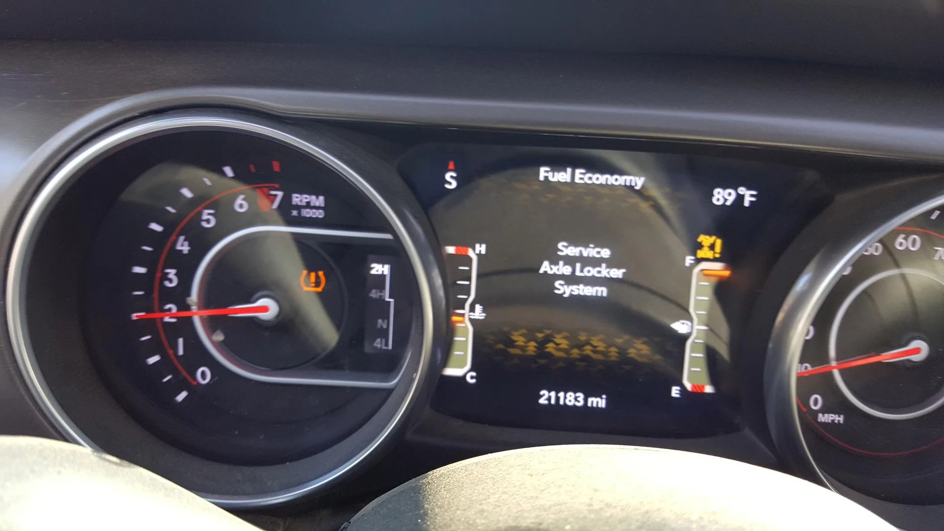

Anybody else have an issue with "Service Axle Locker System" warning coming on then off after a few seconds?
Mostly happens while off-roading of uneven terrain, but lately it shows up sometimes in 2Hi when staring out on streets.
Took it to the dealer and they cleared the stored codes and went through the checklist, but didn't solve the issue. I'm taking it back next week but i'm not hopeful they will find it :(
If I could reliably reproduce the issue maybe they could dig in deeper.
Anybody know of any service bulletins that might relate this this?
Mine did the same thing today, i checked the locker acuator plugs on fron diff and found 1 loose, the lock clip was not fully seated!! Light went awat
