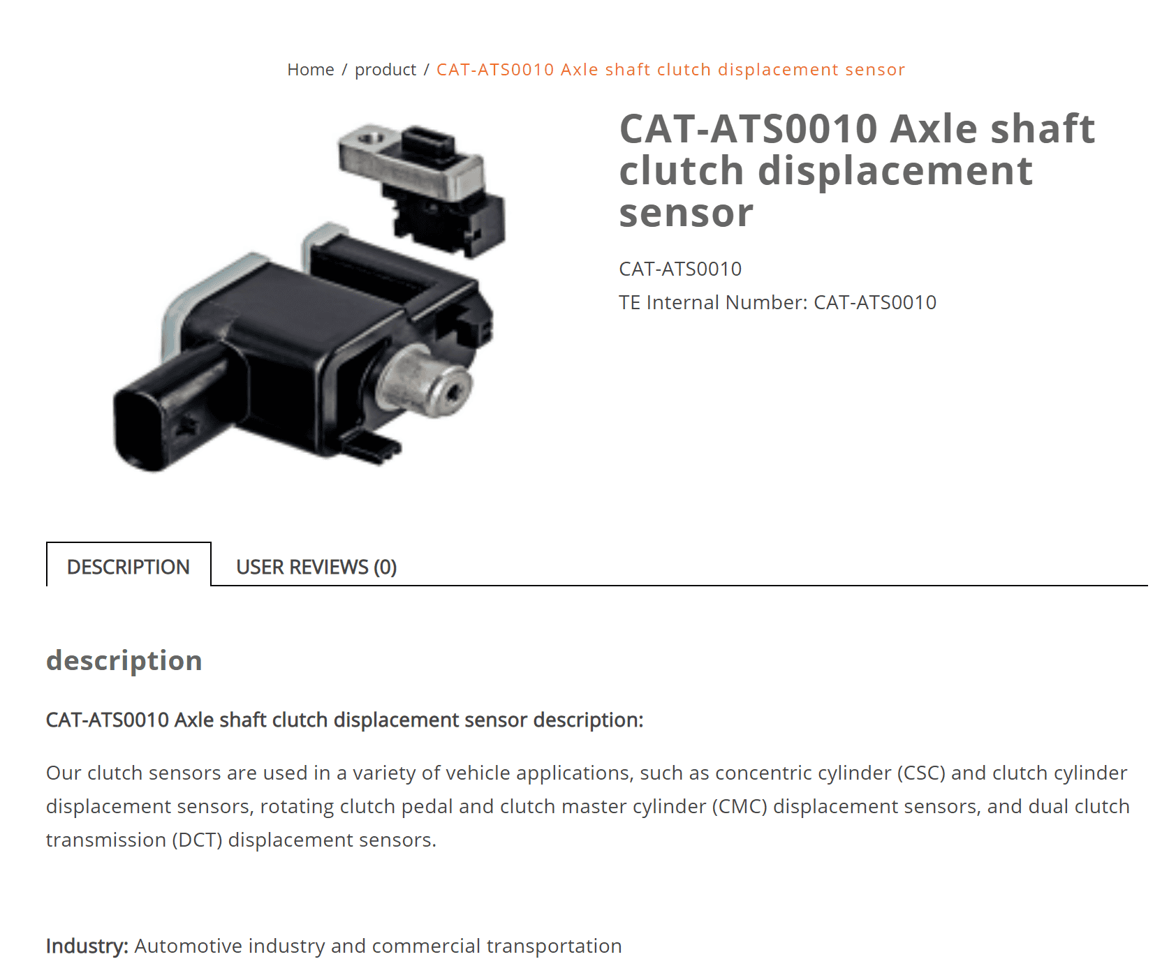

We all need to find a way to place a group order for like 1,000 sensors. It is listed in many on-line catalogs (and lots of Chinese sites). I'm willing to contribute to a crowdfunding scheme to buy them, if anyone can find a place to order them from.
http://www.rihongt.com/shop/cat-ats0010
Jeep Wrangler JL Service axle locker system 1621187048191
@chevymitchell - didn't you or someone else look into this and they wouldn't sell it?
Yes… I’ve responded to 4 or 5 different posts now about acquiring this sensor.
TE Connectivity will not sell it. I tried to get a quote to buy 100 of them. 2 brokers couldn’t even quote me and they all said the same thing TE Connectivity said; not for sale. It’s a proprietary part.
I think someone reached to TE and they wouldn't sell it. But I think reaching out to the Chinese TE distributor sites may actually yield a different answer. I tried some Alibaba supplier (with little research to see if I could get a quote for qty 1)with no success.
I think the key would be to do a crowd funding and go to a distributor with an order for qty 1,000 and ask for a quote.
