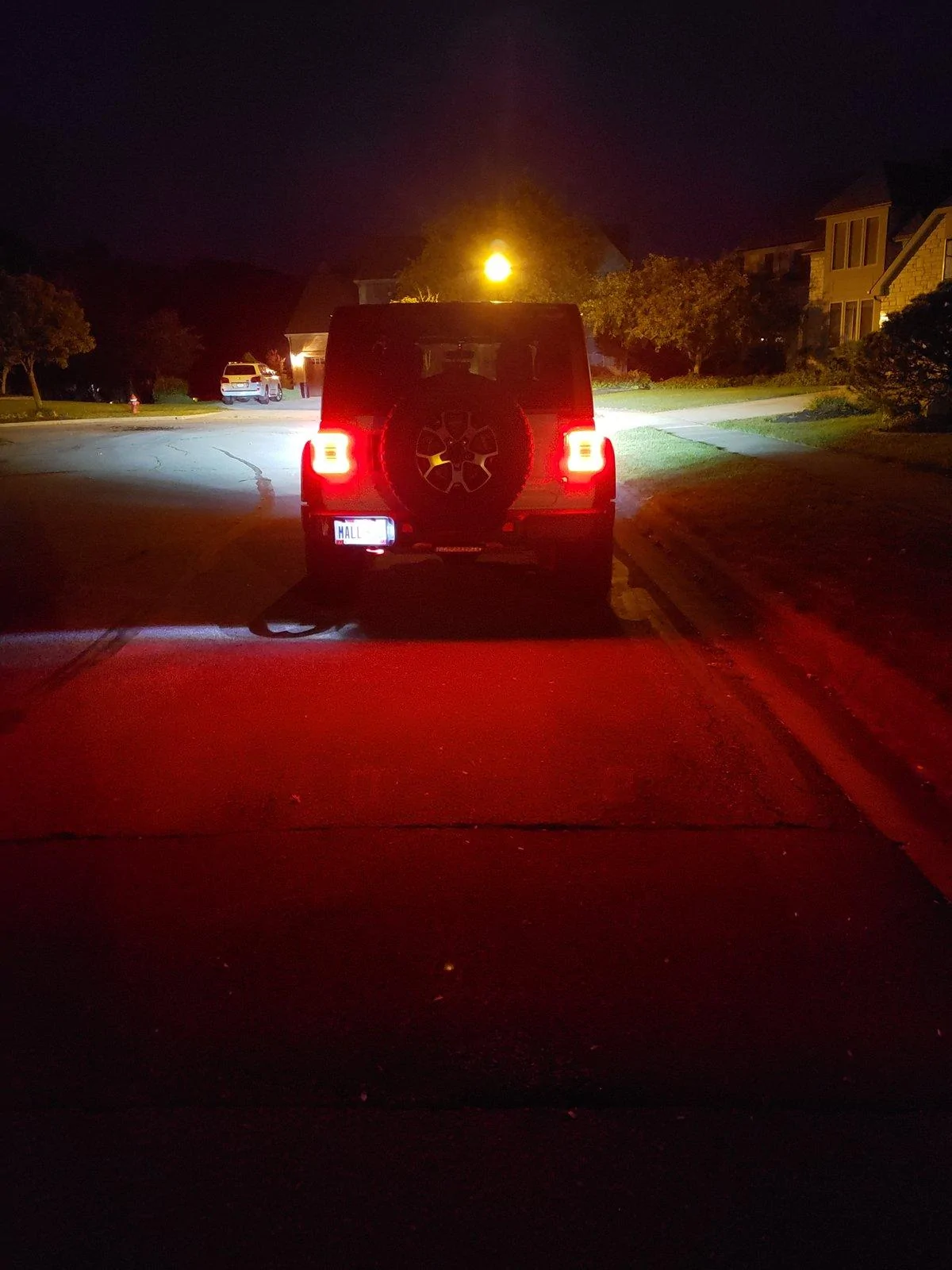

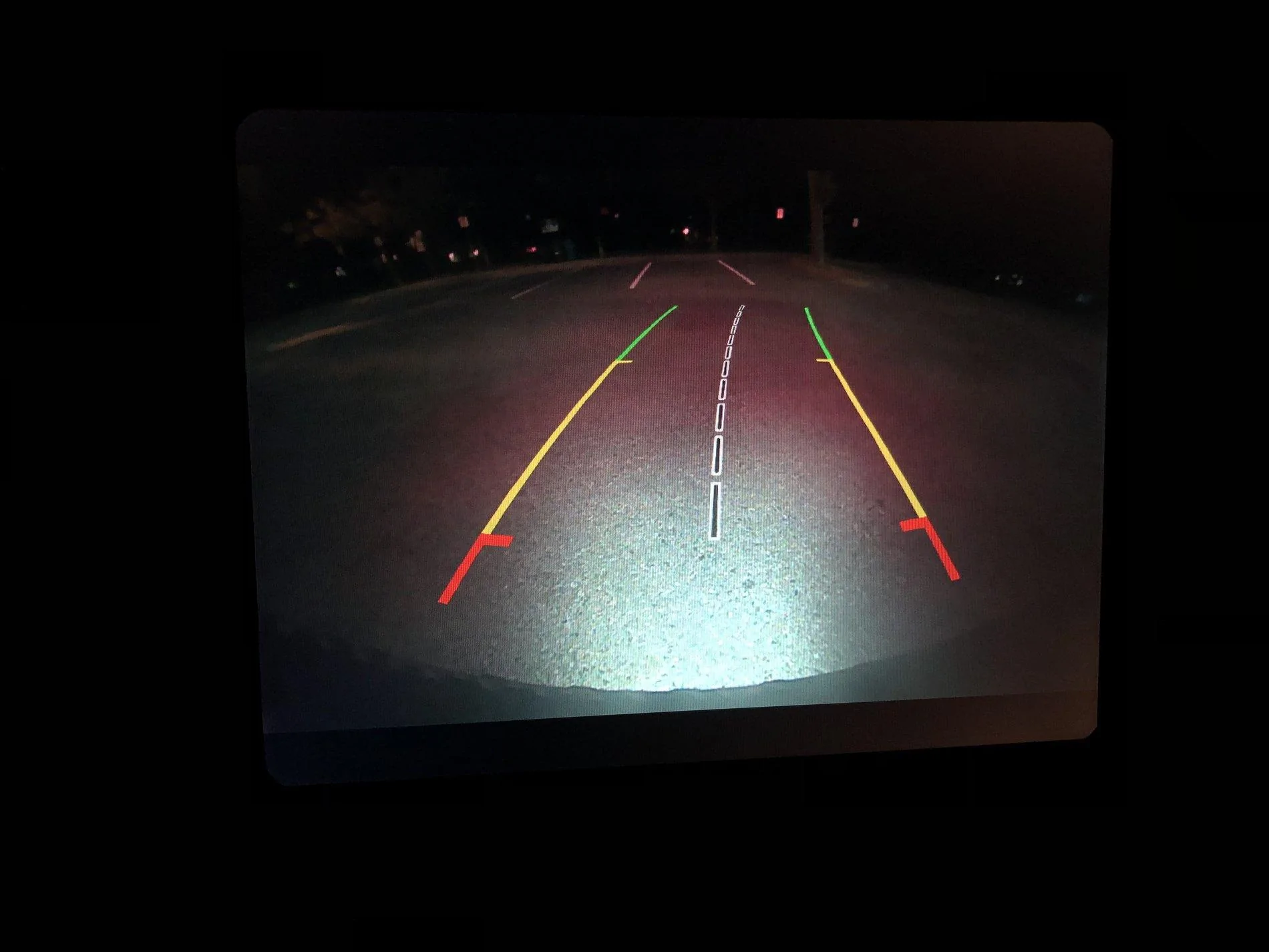

Following up on a few requests I've received for pictures of light output at night. I can report back that I absolutely love this install. Some have suggested that if I hitch up it could be a problem. Sure, maybe. If I'm hitched up, though, I'm not sure I would be relying on the camera in the first place.
Here are some pics for those who have asked...
Just wanted to share that I installed a Rigid Scene Light (1100 lumens) on the underside of the hitch and wired it following the double diode idea to Aux 3 and the hitch plug wire for back up lights. It works great, puts out a ton of light and is very discreet. I also really liked that I didn't need two of them and could center mount the single. Happy to answer more questions about it.

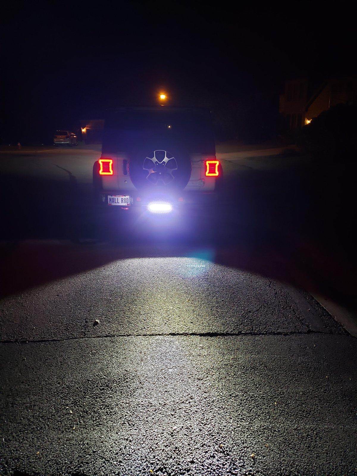

I can finally see when I back up! This is actually wired to my aux switch so I can potentially use it aside from when I am reversing.
The light is the zroadz rear bumper mounted 10" LED
