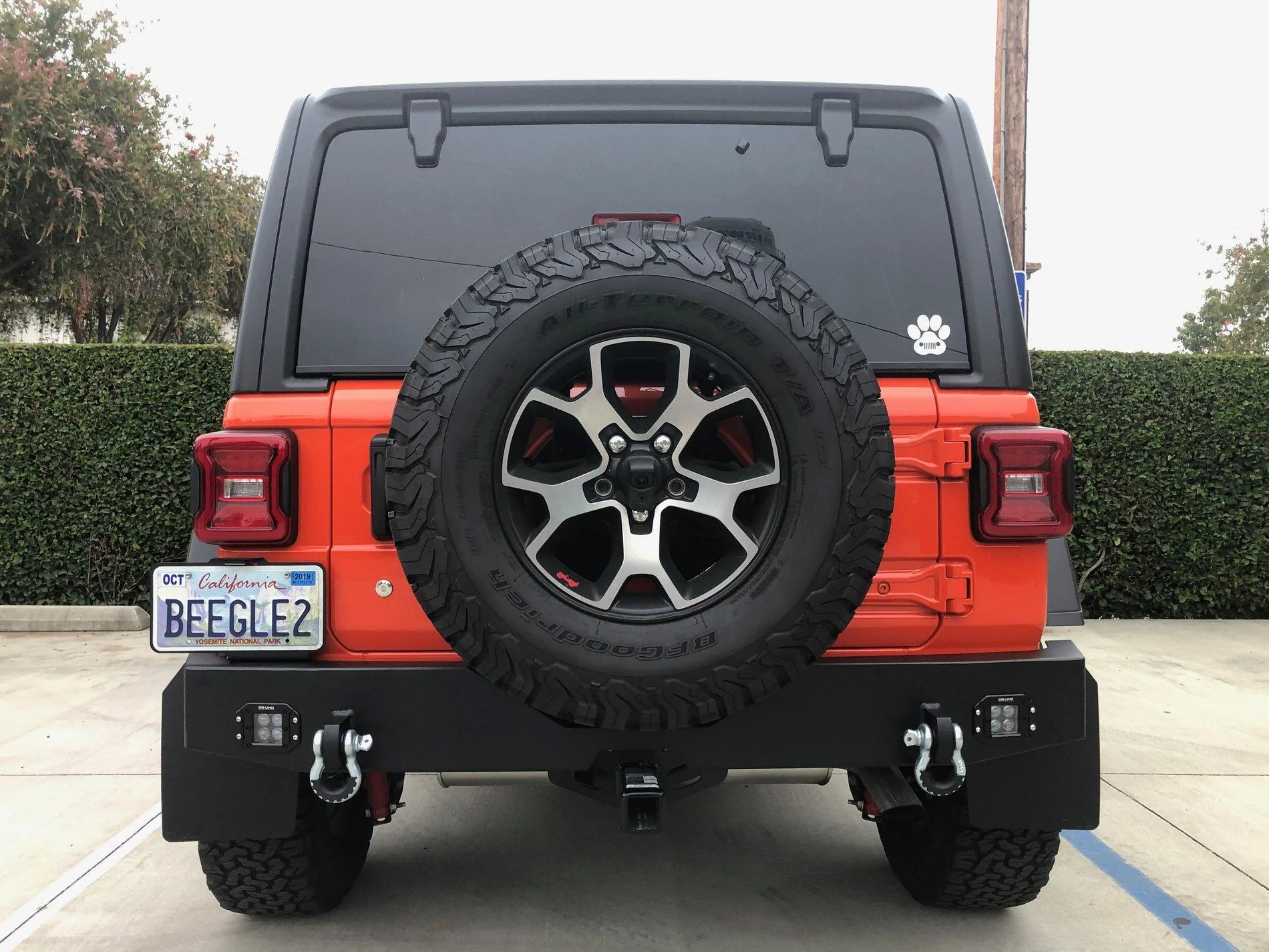

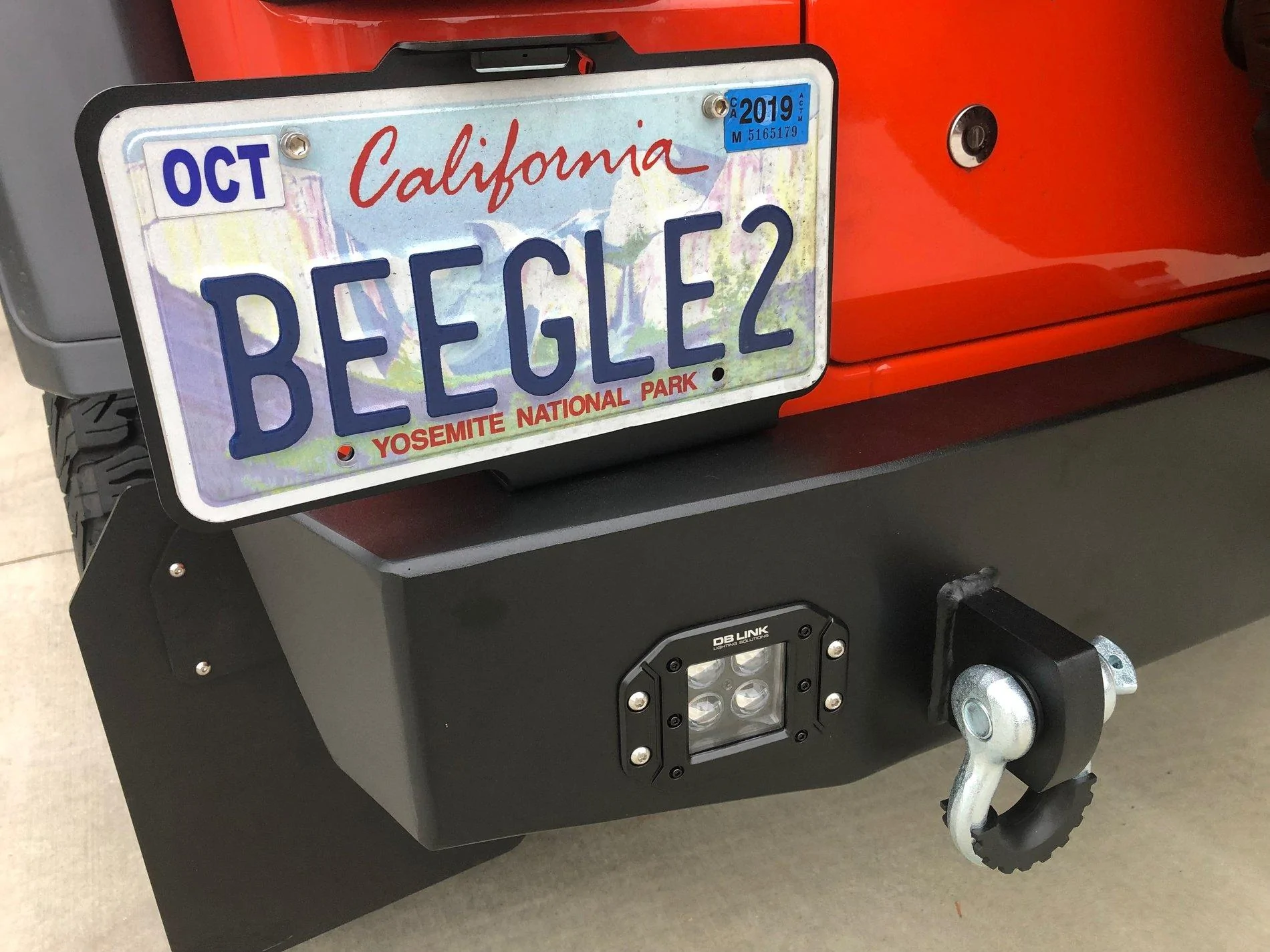

Found an interesting option for aux reverse lighting. These DB Link flush mount reverse/brake lights. So far I've only connected the reverse light function, need to find a brake light wire to tap in for the brake function. Not sure if you could flush mount on a factory bumper, but many aftermarket bumpers have cutouts for 4" flush mount lights.

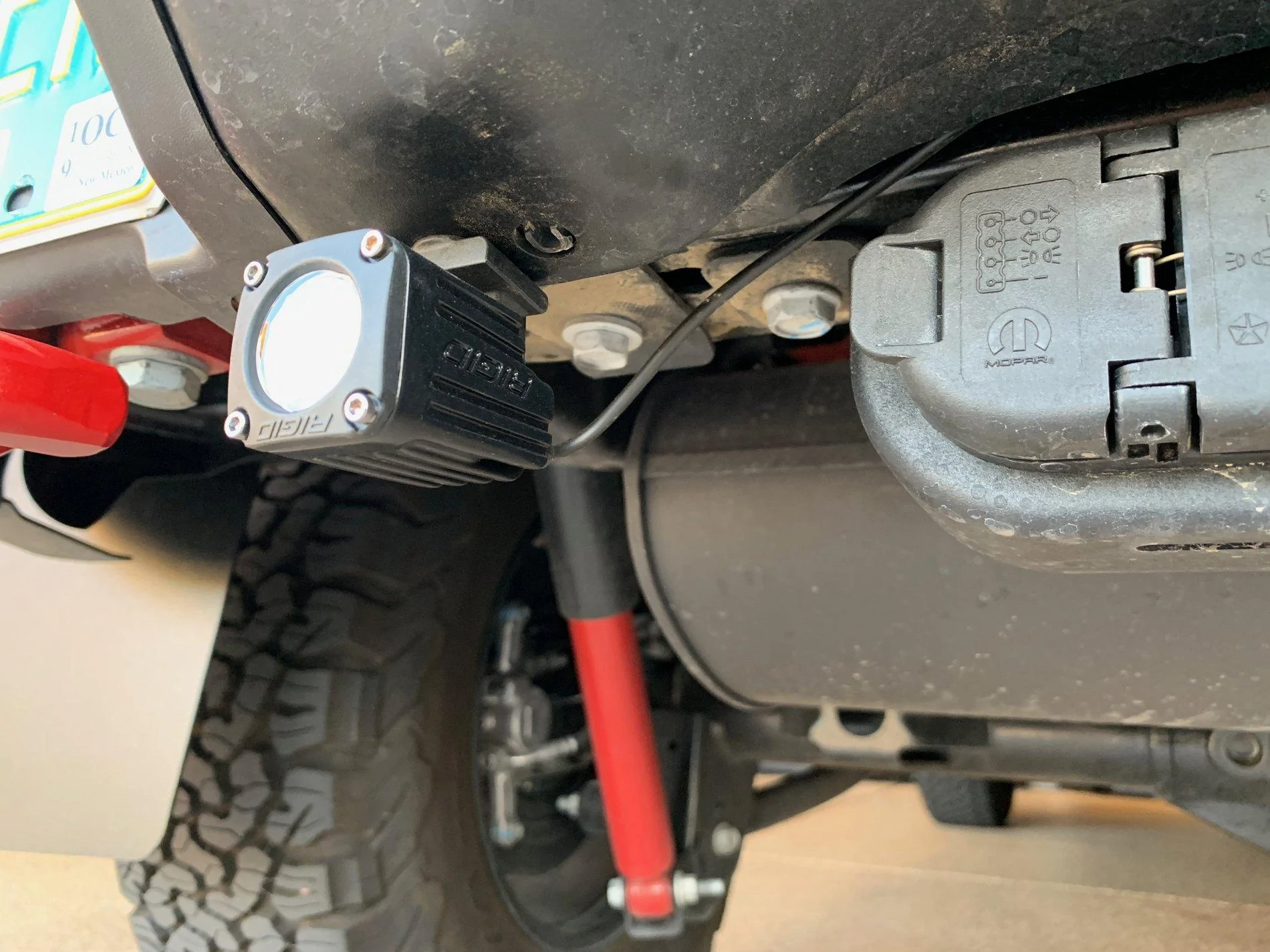

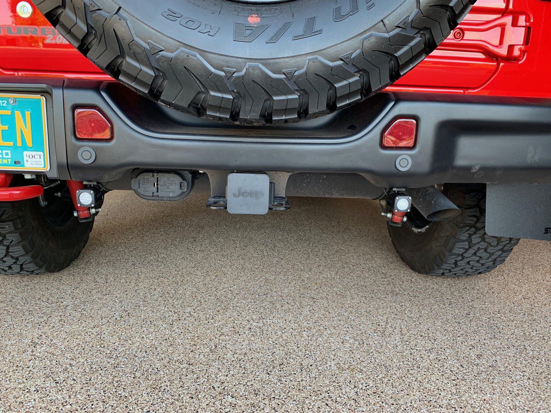

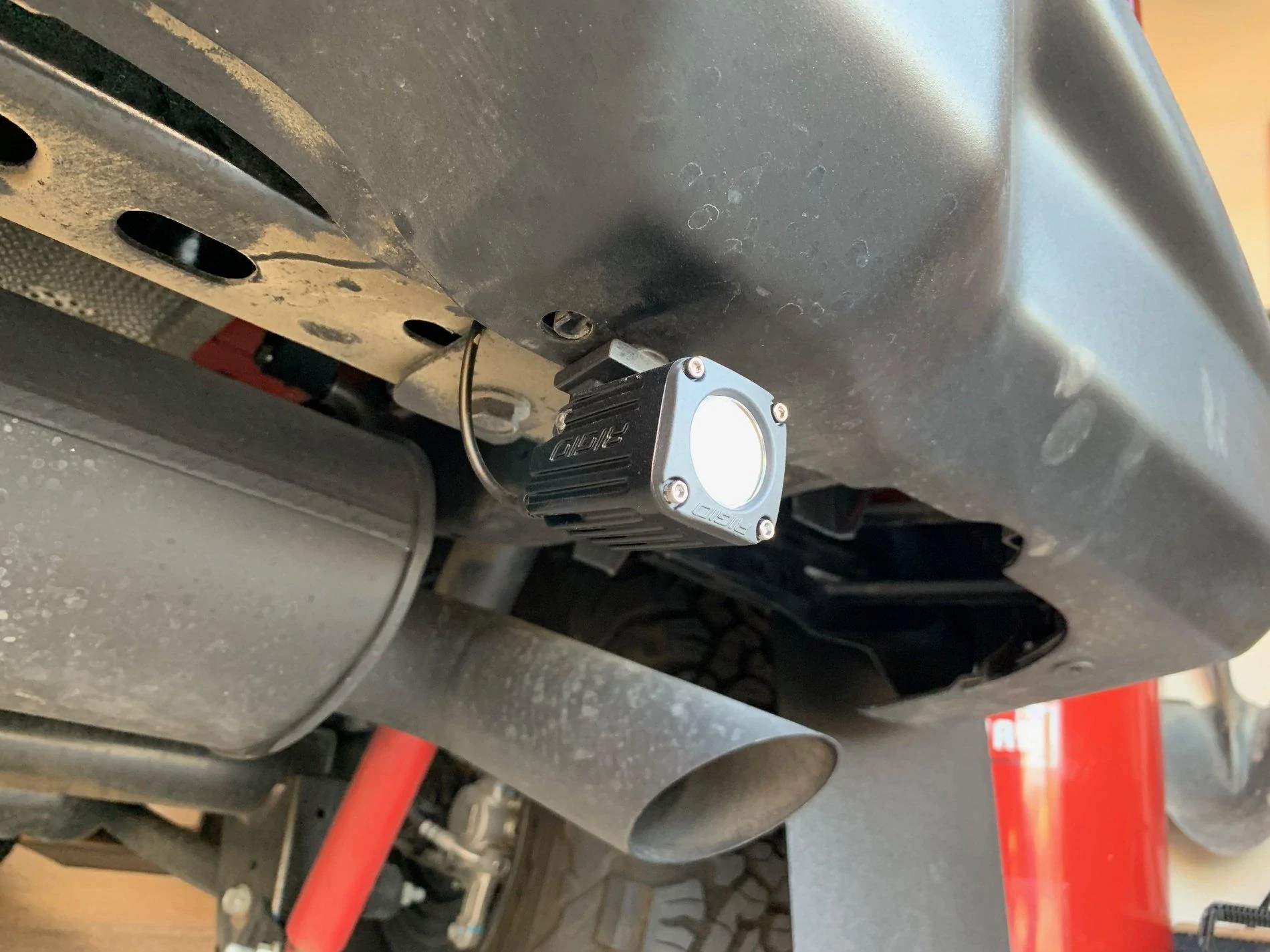

On the steel bumper there were two bolt holes that I removed the bolt and used
IGNITE BACKUP KIT SM from Amazon. Had to get 1/2" longer SS bolts from Lowe's but put out a lot of extra light plus I added the diode for use with BU and Aux switch. Sit a little lower than I like, but install was easy for now.
