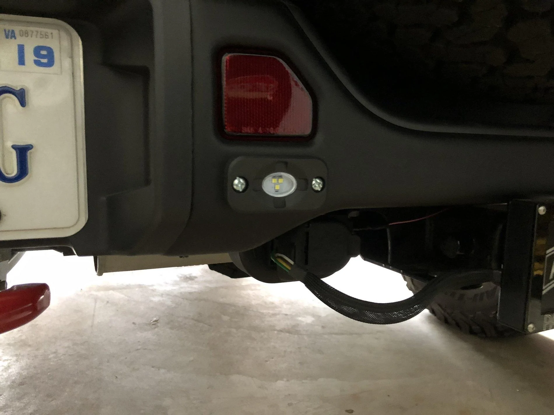

Finally got around to installing my rear lights. Very happy with them.
What brand and model are those lights? They are nice and compact; if they give off enough light, they might be a good solution.

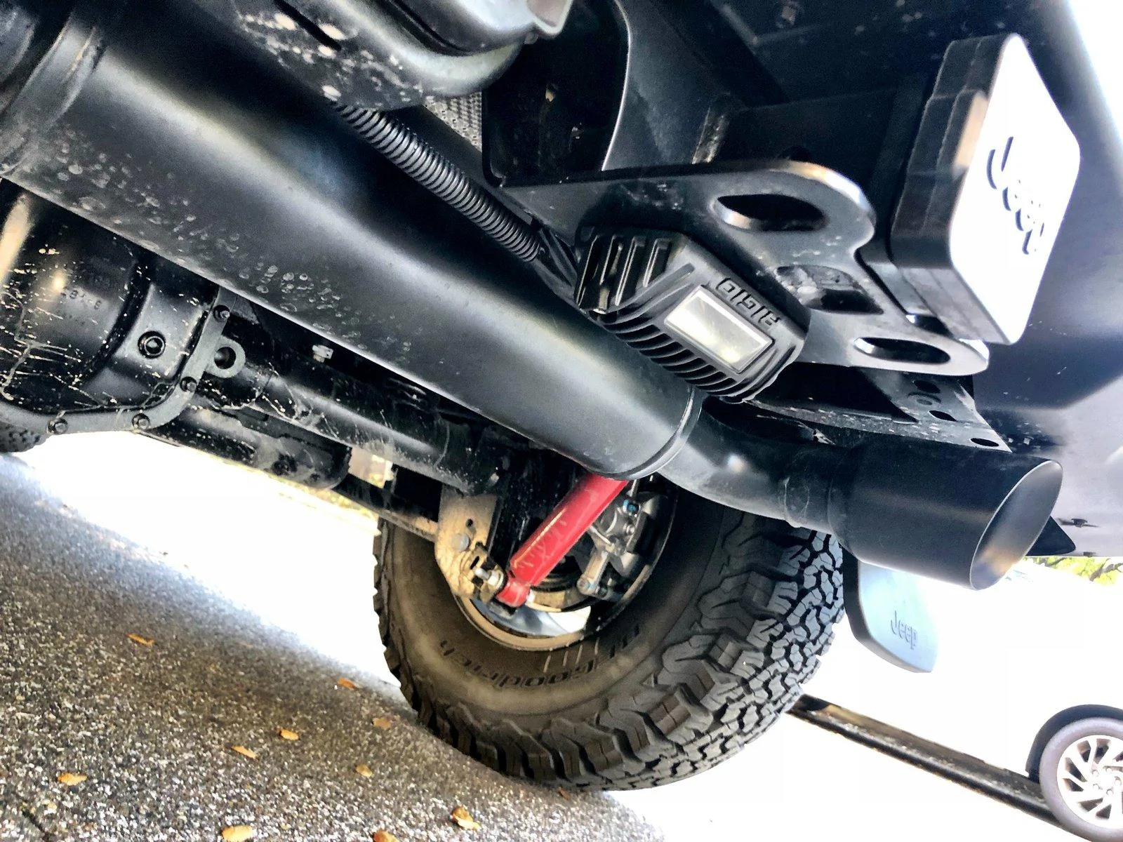

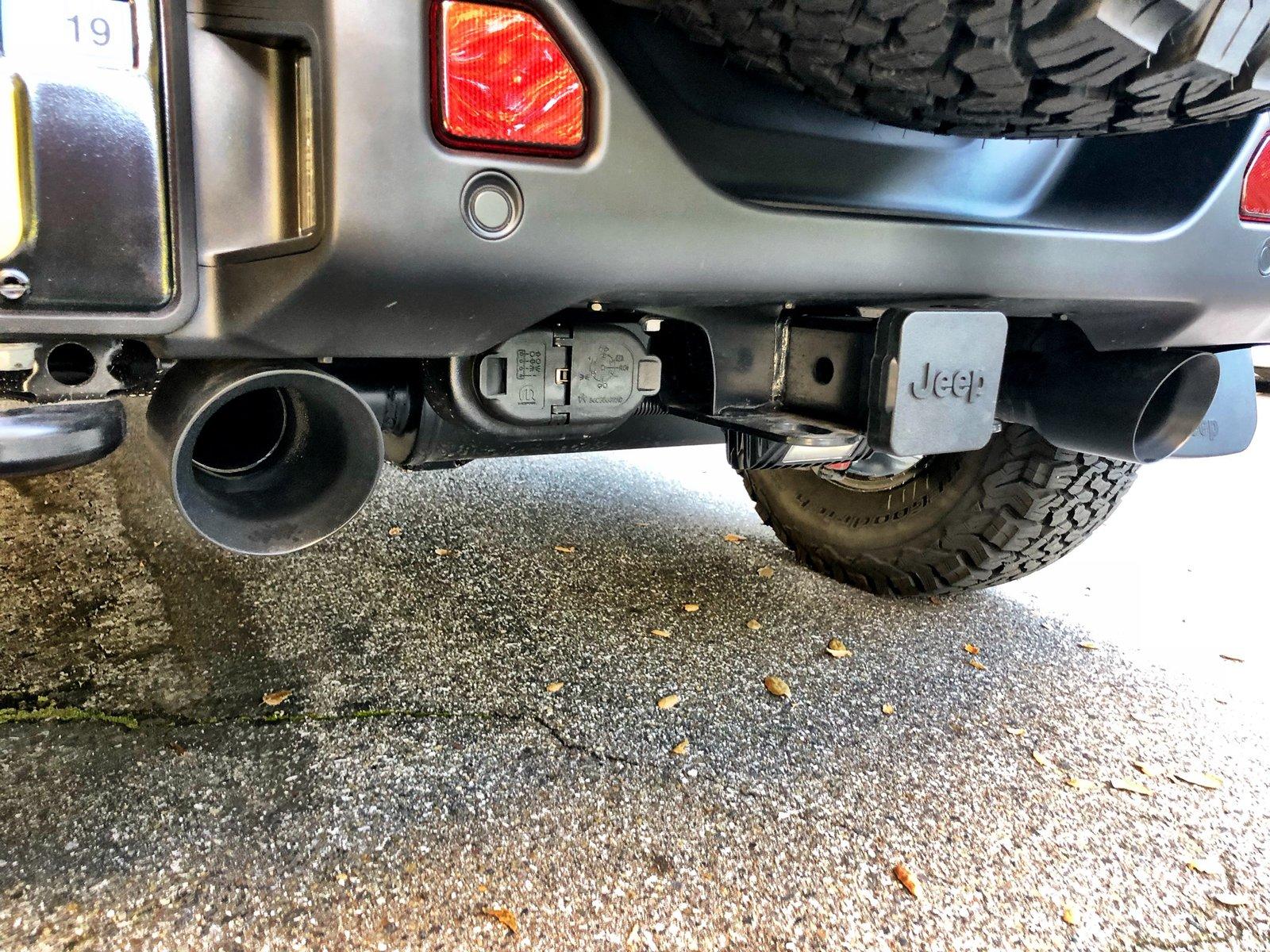

Just wanted to share that I installed a Rigid Scene Light (1100 lumens) on the underside of the hitch and wired it following the double diode idea to Aux 3 and the hitch plug wire for back up lights. It works great, puts out a ton of light and is very discreet. I also really liked that I didn't need two of them and could center mount the single. Happy to answer more questions about it.
I am following this thread with interest, because I’d like to add more reverse light power, but one thing puzzles me here. Not trying to single you out, but this is one of many examples on this thread of mounting locations where it would seem to be easy to rip the lights off on the trail. Dragging the back bumper area as you come down off a ledge is one of the most common scenarios - seems to happen at least once every outing. Why does it seem like no one is worried about this? So far the only mounting location that would appear to be off-road proof is the inside-the-reflector mod. What am I missing?
