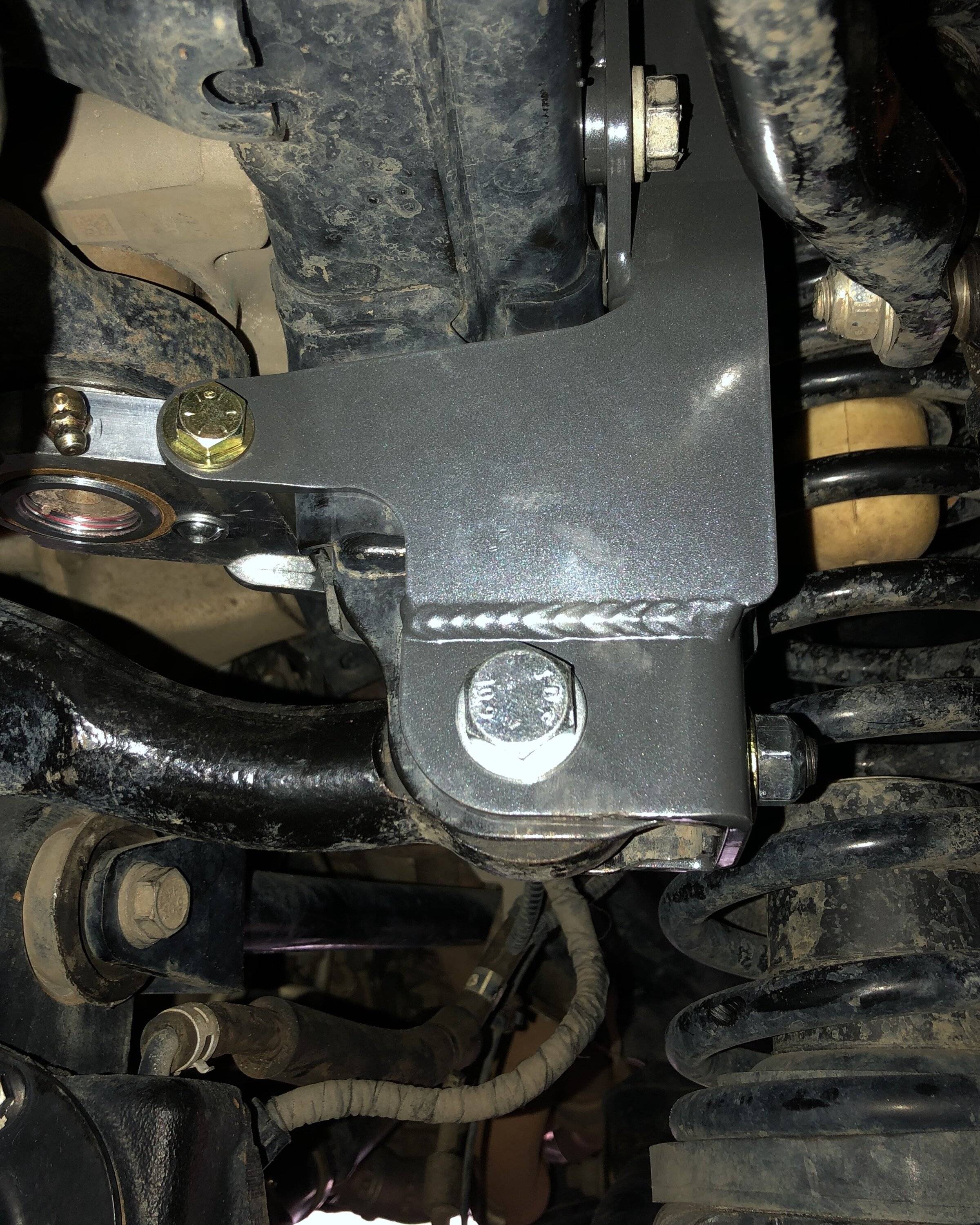

I got my synergy brace a few years ago, and it was close to when they first came out. Back then they had trouble with the brass bushing spinning in the housing which would misalign the grease fitting with the hole in the bushing resulting in no grease in the bushing….. I don’t know if I was the first to do it but I fixed mine and about another dozen of them after….. I emailed Dave with synergy and showed him the fix, he said I could’ve just used red loctite….:facepalm: ……. Shortly after that, they came out with a revised version with two set screws in them, a little different than mine but basically the same thing………mine is still working great, but if it ever fails, I’ll likely replace the bushing with the new sealed bearing….
https://www.jlwranglerforums.com/fo...bar-and-sector-shaft-brace.50148/post-1159126
I appreciate your contribution to the improvement of this product! Many would have just stopped from there and you sir put extra effort into solving the problems for our followers to benefit these days.

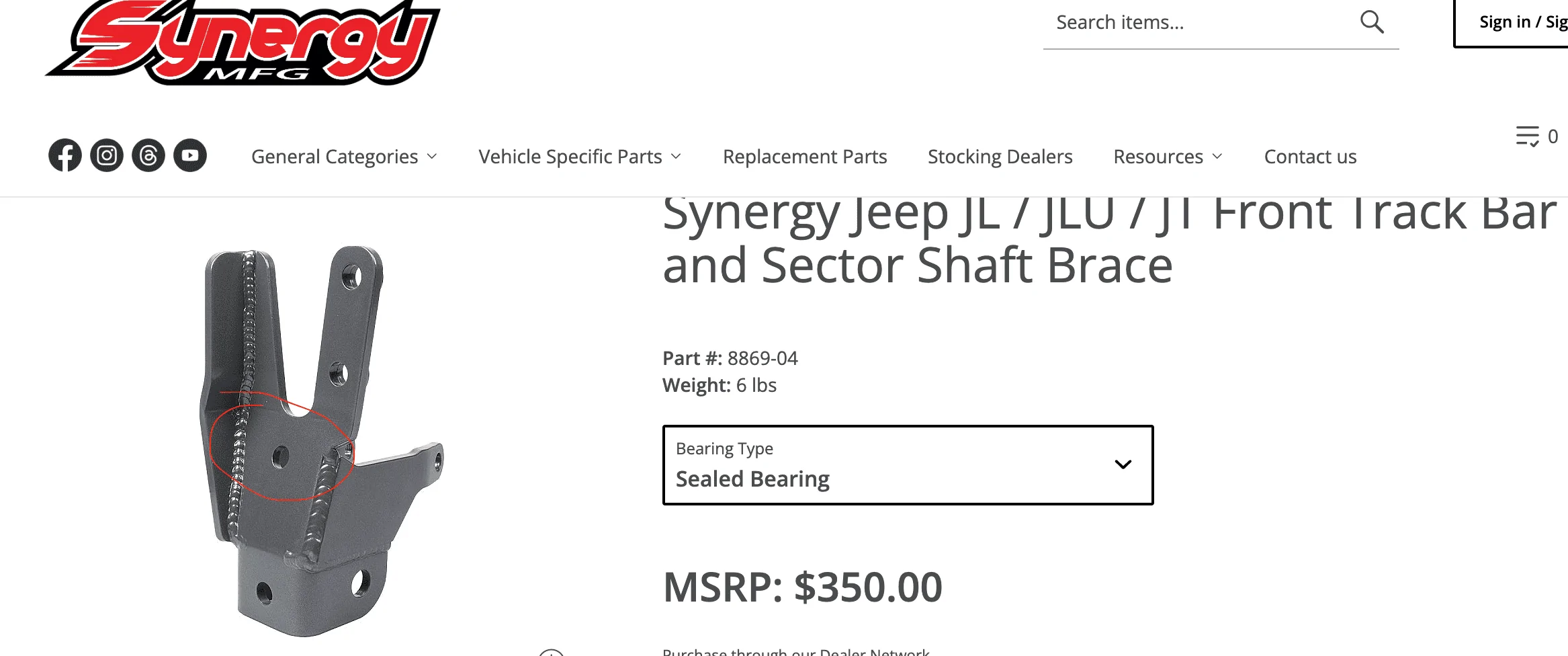

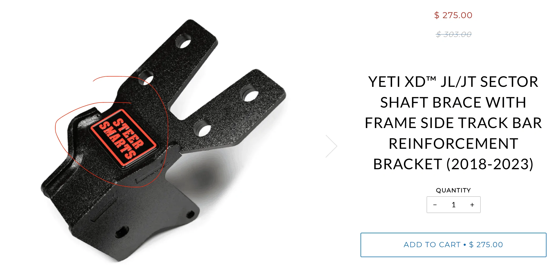

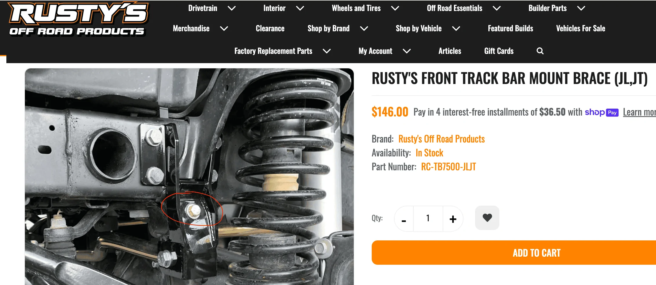

Today I added the Rusty's Front Track Bar Mount Brace into my consideration too, thinking the sector shaft brace may be not really needed since the new JL has cast iron steering box. And I also noticed the center bolt hole that Synergy has too but SteerSmarts doesn't. This design difference makes me think that bolts to the factory bracket for extra strength.

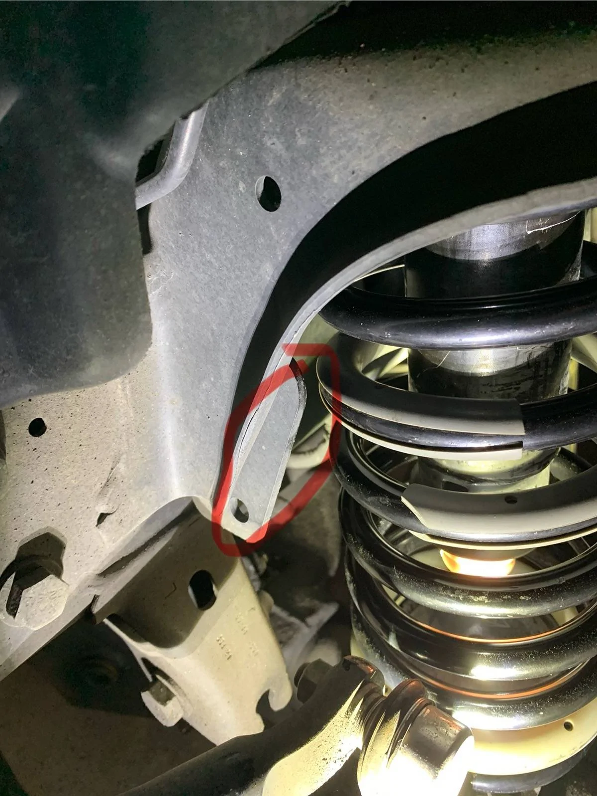

Noticed this extra backing metal plate, and some members reported install issues and they had to trim that piece with Rusty’s brace. Wanted to post it here to give viewers more info. The early JLs (before 2022MY) didn’t seem to have this piece.
Jeep Wrangler JL All track bar reinforcement bracket options IMG_8522
The Metalcloak brace seems clear this metal piece by looking at the pics from https://www.jlwranglerforums.com/fo...ft-and-track-bar-brace-first-thoughts.123970/

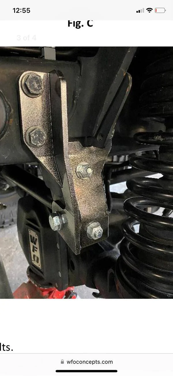

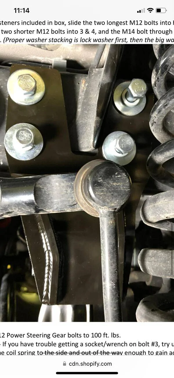

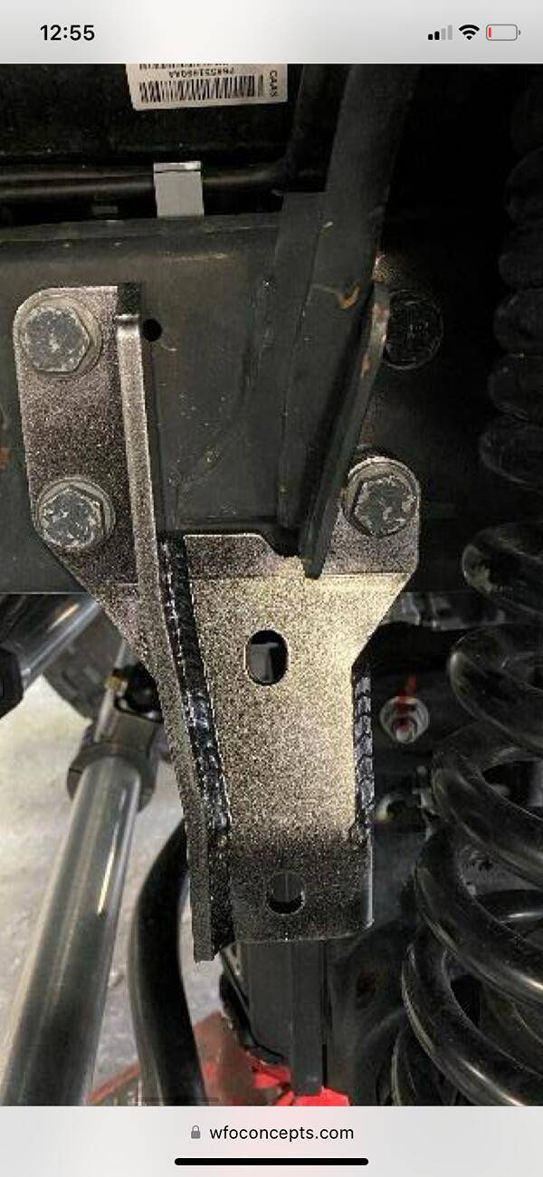

WFO Concepts also makes a bracket and it clears the extra metal plate. Their bracket uses 3 of the 4 bolts to the steering box, which is less ideal and the two lower holes to secure to the factor bracket may cause binding, possibly due to variations of the welding.
Their version does clear that extra metal piece welded to frame.

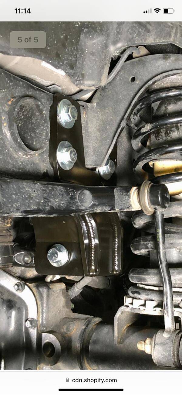

I think I’ll go with the SteerSmart bracket (without the sector shaft brace) due to their 4 hole design and 1/4” beefy material. They don’t use extra holes to secure to the factory bracket and this doesn’t cause additional binding force. I may have to trim the extra metal for clearance.
