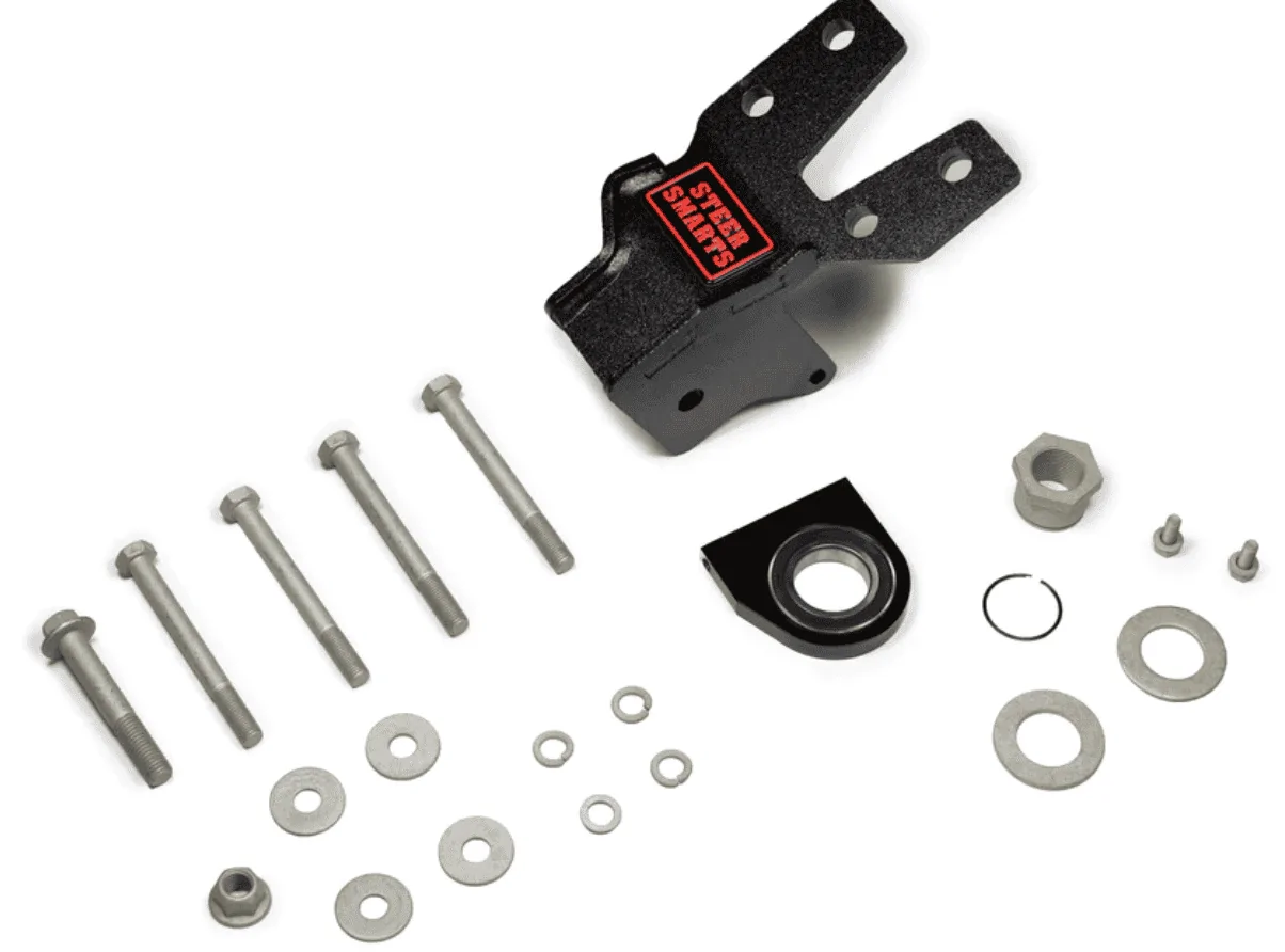

I was doing research on the steering improvements and saw lots of members installed the Steer Smarts Yeti XD Sector Shaft Brace with Frame-Side Track Bar Reinforcement Bracket.

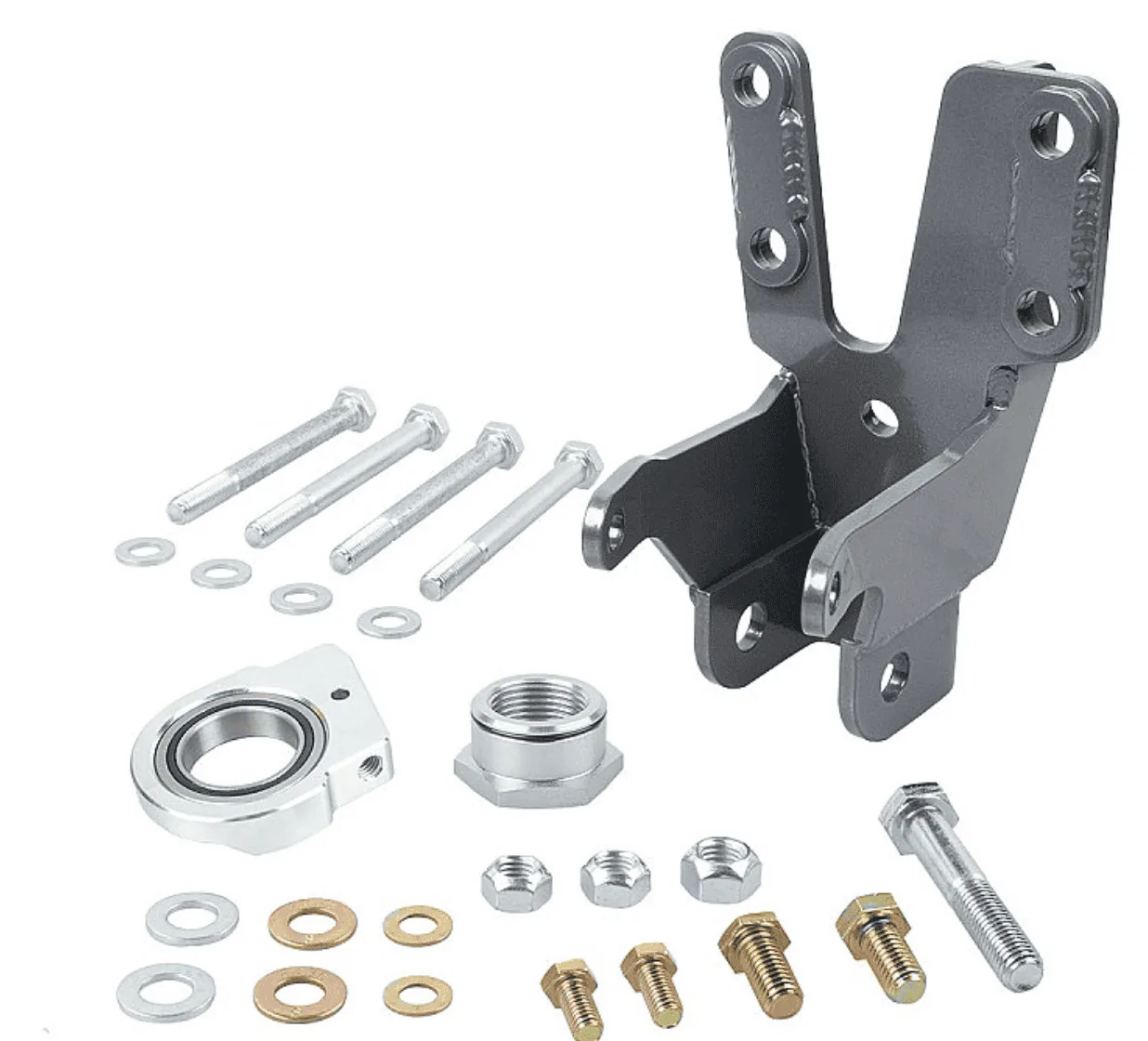

Recently Synergy released a new version of the brace with several improvements to address the issues found on their first version.
Competition improves breed. Are you gonna choose this new one over Steer Smarts?

I run the Synergy brace with the old style bushing. I've modified it to add a set screw to keep the bronze bushing from turning. Mine is similar to one of the new styles Synergy is offering, in addition to their sealed bearing. I might upgrade to the sealed bearing, but honestly have had zero issues with the bronze bushing so far.
I really like the Synergy as it reinforces the frame rail at the PS box and the track bar mount. Yes, it takes a bit more time to install than the Metalcloak, but you get more for your money. I haven't looked at the Yeti system since I've been using the Synergy since 2019.
IMHO, if you're running 37's or larger then a sector shaft/track bar brace is important to use. It takes one less variable out of the equation of getting a shimmy or death wobble. I've had ZERO shimmy or death wobble on my rig.

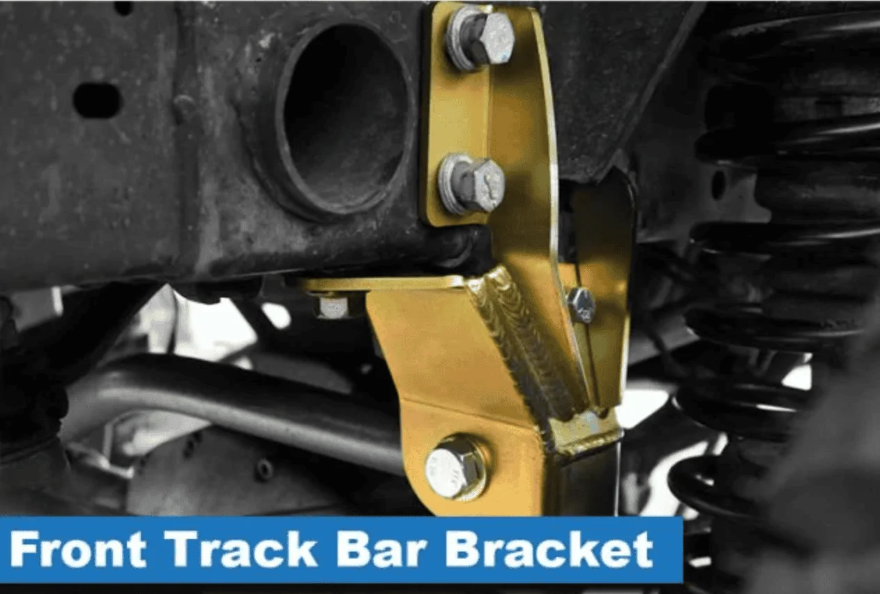

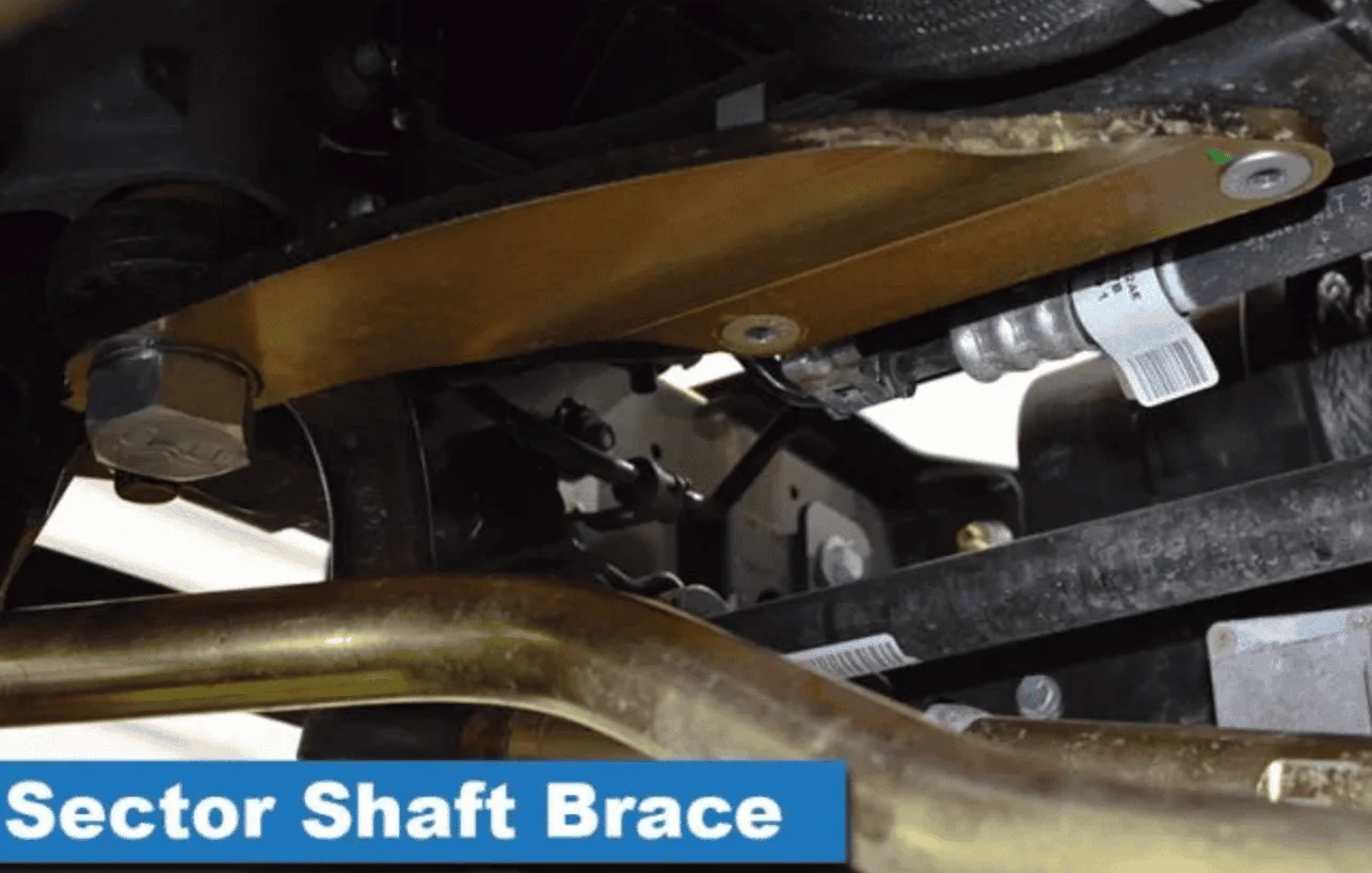

So I did a bit more learning on the MetalCloak version, essentially we need two pieces to achieve the same goals. And the sector shaft brace requires to drill two holes and use rivet nuts for the two screws. This can be a deal breaker.
The MetalCloak 3/8" steel sector shaft is indeed beefy, their front track bar reinforcement bracket is 3/16" steel and it has bottom bolts too! Both the updated Synergy and Steer Smarts track bar brackets use 1/4" steel.
