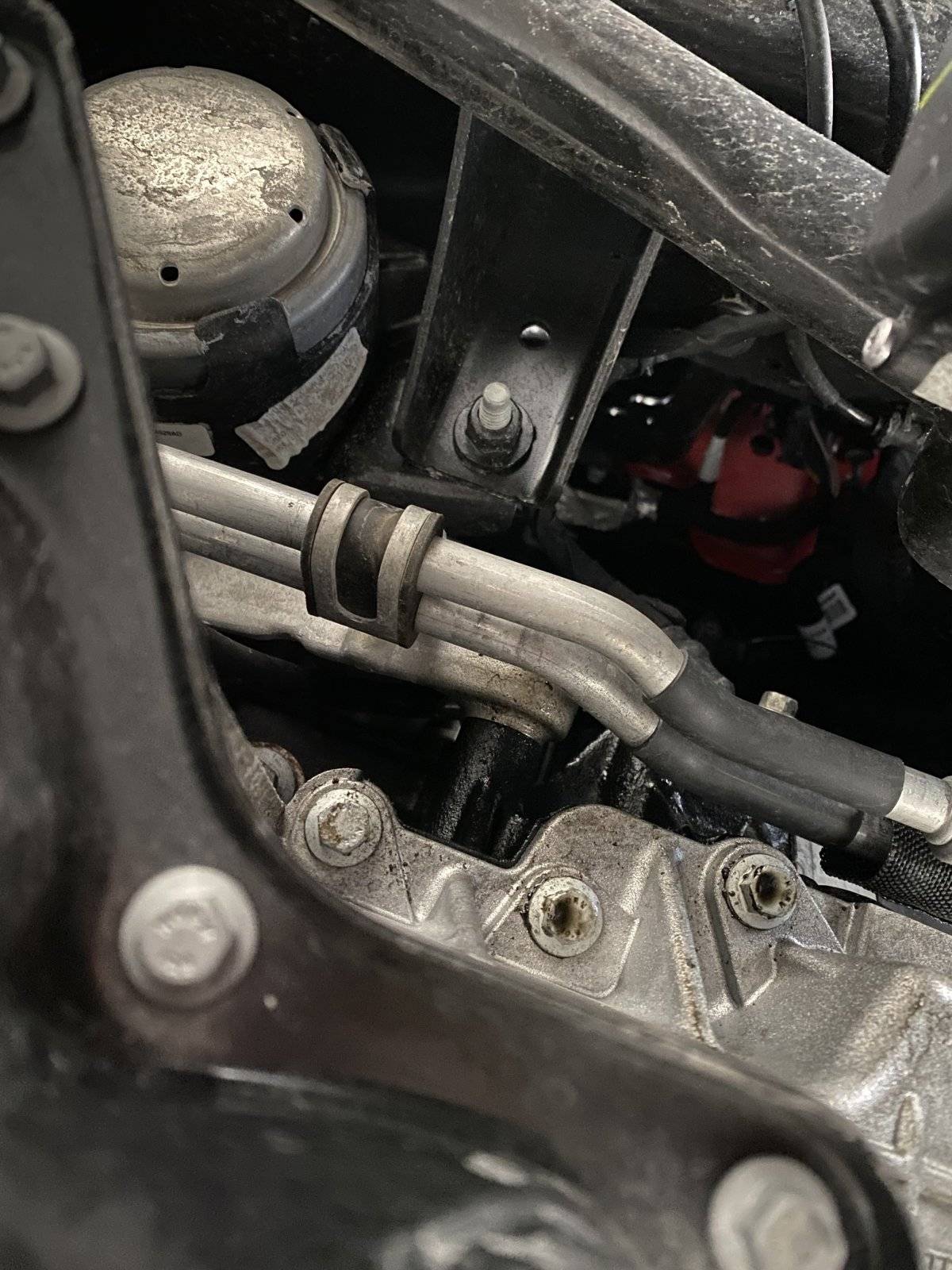

Hey all. The brandy new 2021 Willy's 3.0 is in the dealer's lot as of yesterday.
It's been cold here, but not anything below 15F. When remote starting this morning, I noticed that the initial idle was REALLY rough. Had a different pitch than normal.
I went out there and pulled the oil dipstick, and it was covered in soot. Wiped it off, sunk it back in, and pulled it out BONE DRY.
I have no idea how long it has been running dry like this, my last oil check was done at 2K miles. Everything seemed fine at that point.
The engine seems to have been running pretty well, and I didn't notice any power differences. Maybe a bit more of a rough shifting, but figured it was just the engine marrying to the transmission and getting in its groove.
The only other indication was 24 hours before my oil check and drive to the dealer. The oil temp (my main display is always on oil temp) was running up to 112F, instead of the normal 203F that I'm used to seeing.
Here's hoping that the dealer finds a simple fix. I'll be checking the oil every 10 miles or so from now on.
This is the second time I've got a Wrangler with oil issues. My JK had a rear main seal bust TWICE.
This diesel has never left the pavement (yet), and I'm kind of a fuel hawk, so I drive it nice and easy unless I'm merging onto the highway.
Dealers diesel tech (yeah, they said diesel tech...like singular) is busy for at least today, maybe the'll get to look at it by tomorrow.
At least I have a Ram 3.0 courtesy vehicle. It's making me appreciate the power match of EcoDiesel to Wrangler all the more.
Keep yer fingers crossed for me...I love this engine/wrangler.
Probably dripped out like mine is doing.
