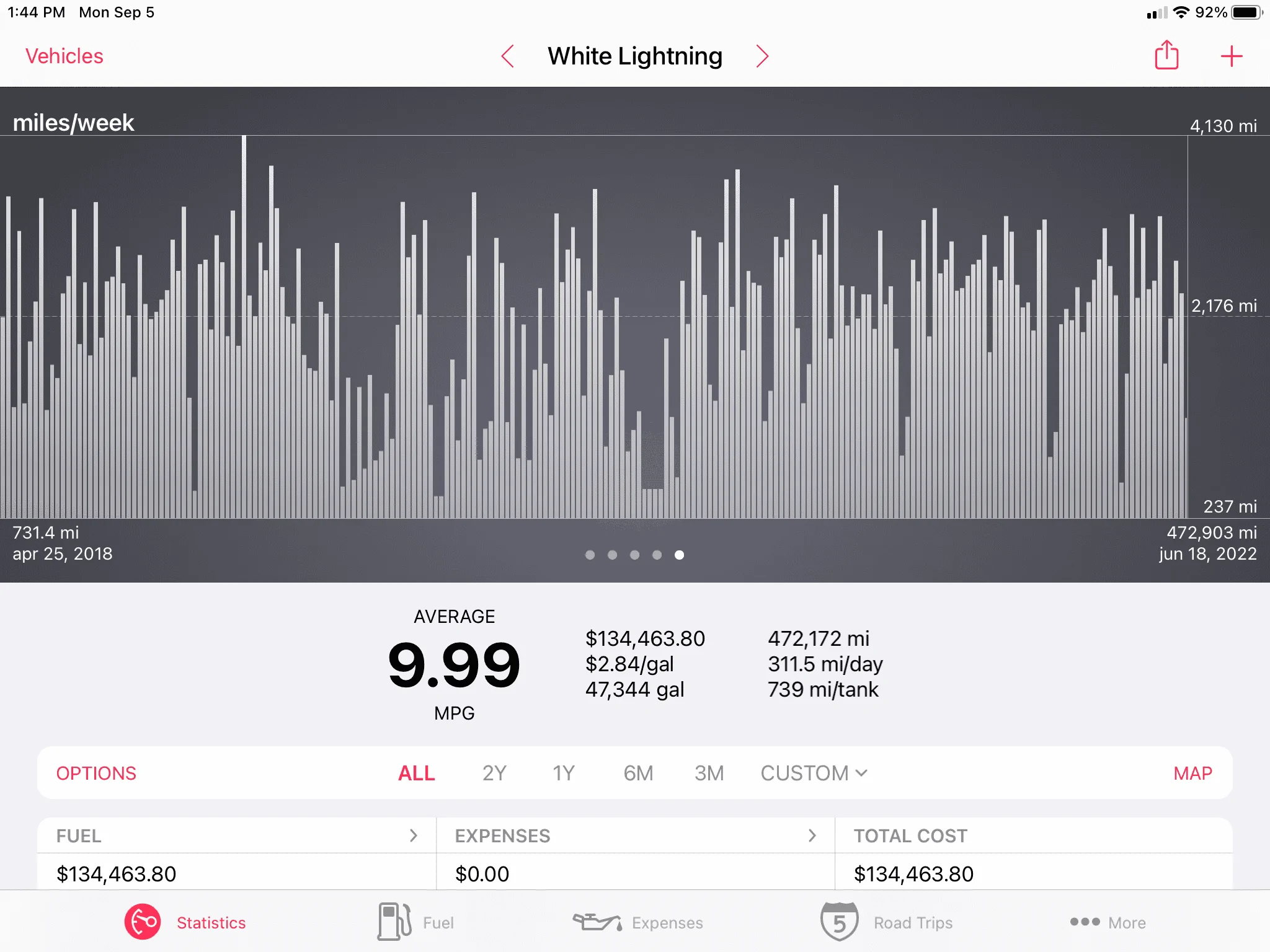

Having owned RAM / Cummins pickups with HPCR fuel systems since 2003 MY.....the CP3’s are tougher than nails.
Long story short.....the CP4’s are a mistake....so much so that RAM tried them in their 2500/3500/4500/5500’s between 2019 and 2020.....and it is currently biting them in the asssssssss with recalls and TSB’s.
My previous 2018 RAM 4500 was sold at 473k miles......on the OE lift pumps (it had the 22+52 gallon tanks) CP3, and injectors.....all by performing maintenance by the book with quality Fleetguard and MoPar fuel filters.
Additionally.....I used that truck for running hotshot, below is the amount of fuel that was ran through that truck during my ownership....all 47,344 gallons of it.
Jeep Wrangler JL Retitled: Fuel Pump Failed 4200 miles 70B1DF16-C3C2-4C47-AB57-65D4B30659D4
Thankfully......RAM went back to the CP3 in 2021. My 2022 RAM 5500 has been rock solid through 24k miles.
