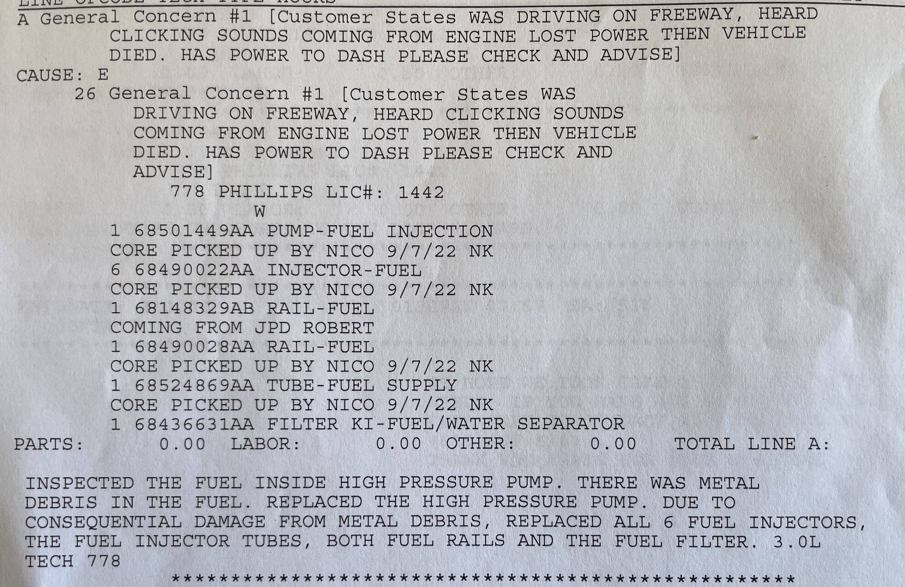

Did they put another CP4 pump back in?
And I’d say they are having lots of CP4 issues because my Service Rep called me yesterday and to my complete shock and surprise they had everything in stock at the dealer to swap out my entire fuel system. I might get by Jeep back as early as tonight. The bad news is I will still have a CP4 fuel pump
Unfortunately, it looks like they did.
Yup. I double checked the part number of the pump installed and it’s the CP4.
Just gonna cross my fingers, try not to think about it, and hope it makes it until they get an official fix. I’m definitely gonna still drive it! They say lightening never strikes twice…

I got the Jeep back They replaced the fuel pump, all the injectors, both fuel rails, fuel supply tubes and fuel filter. They washed it which was a bonus but also refilled all my tires to 40psi which was very noticeable ha. Engine seemed OK coming home. Let’s see how it rides over the next few days. Happy to have it back and hopefully with a longer lasting fuel pump.

i think ours already have the latest version of the CP4.
did they also replace the Fuel Pump/Gauge module? (they did for mine; this was the part that i had to wait the longest for.)
be aware that one of the first things the dealers will do if there are any future problems is look at the fuel and try to blame any additives.
this is why when i decided to run an additive after they replaced the entire fuel system after mines failure i chose to use only the Mopar diesel fuel additive; sadly, this has alreaady saved me some grief on the latest issue.
Are you having another problem with the replaced pump?
There wasn’t a mention of the module being replaced on the invoice and the pump Mopar PN wasn’t new so I think I have the same one. They didn’t ask me anything about my fuel/additive usage but that is something to keep in mind. Thanks for the heads up.
