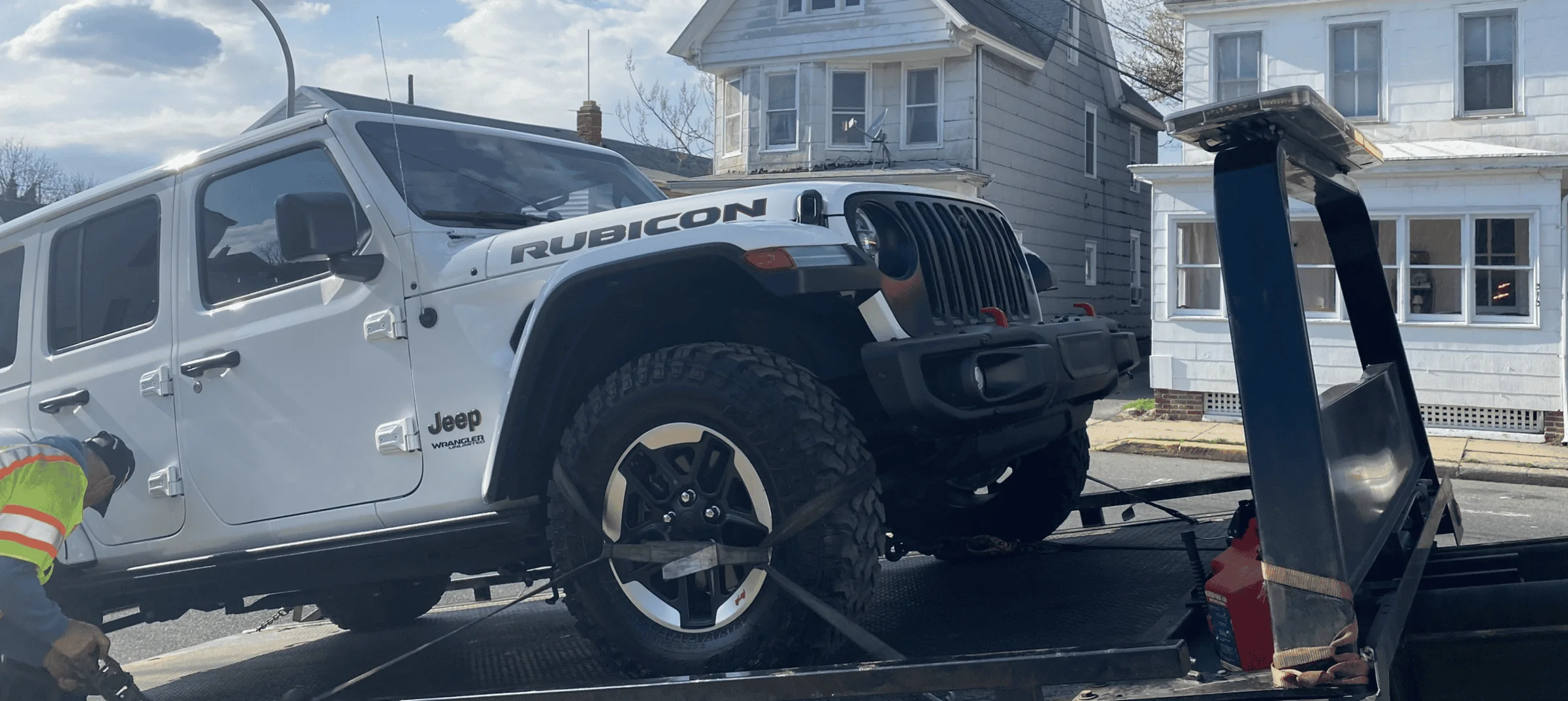

CP4 imploded. Still in the shop.
Waiting for new lines and injectors.

Thanks guys!
yeah we contacted Chrysler. They say they looking for parts across the country.
Luckily I was coming to a signal when all power failed. Can’t imagine if I was on I -95 and this happened. You kinda freak out when it does. So disappointed. Hopefully it will be back by June in time for summer. I hope they do a recall soon. No confidence now if going on long trips if they just replaced the part considering all the material on the internet about the CP4. And it looks like this has been going on for years. Thanks for the feedback!
