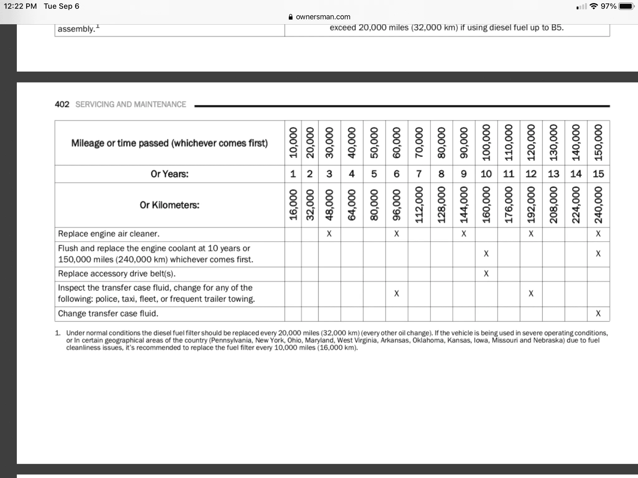

At the recommendation of the techs in my shop I will be changing the fuel filter every 10k. Still wondering why the manual has the Ram fuel filter change interval at 10k and the JL-JT interval at 20k. Better safe than sorry. Also adding Hotshots EDT with every fillup. Wishing you luck.
gsbrockman
Greg
Nov 11, 2021
1,464
3,161
Sand Gap, KY
From a 2021 RAM 1500 EcoDiesel owner’s manual...under maintenance:
See footnote #1

Terpsmandan
Dan
Sep 17, 2021
65
1,936
1,272
Penn Yan
2021 JLUR Diesel, 2022 JLUR Diesel
And I live in NY....

enginerd
If I'm not mistaken, I believe they use the same filter on the Cummins engine. That uses a lot more fuel so the change interval is half as many miles as our little 3.0.
I just changed mine at 18,000 miles and it was dirty but not excessively so. I do a 6,000 mile oil change interval. I may try changing the filter every other oil change instead of every 3rd.
