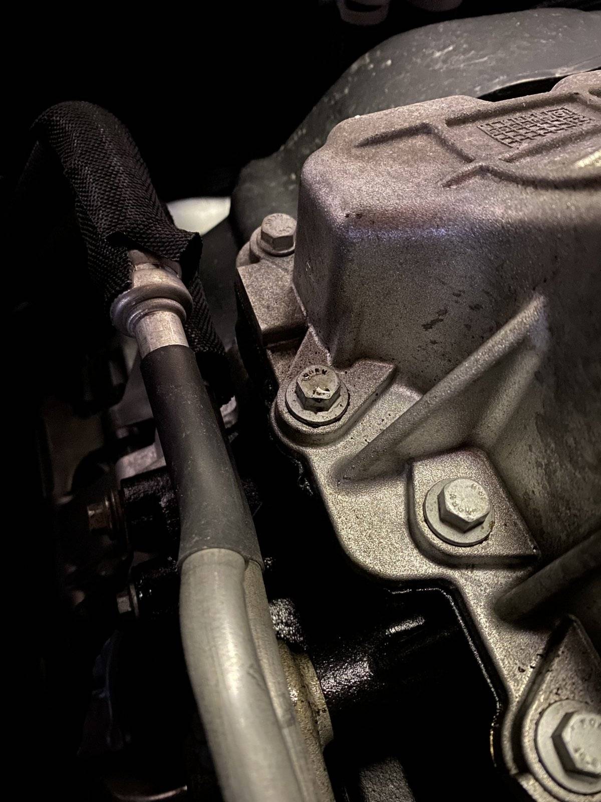

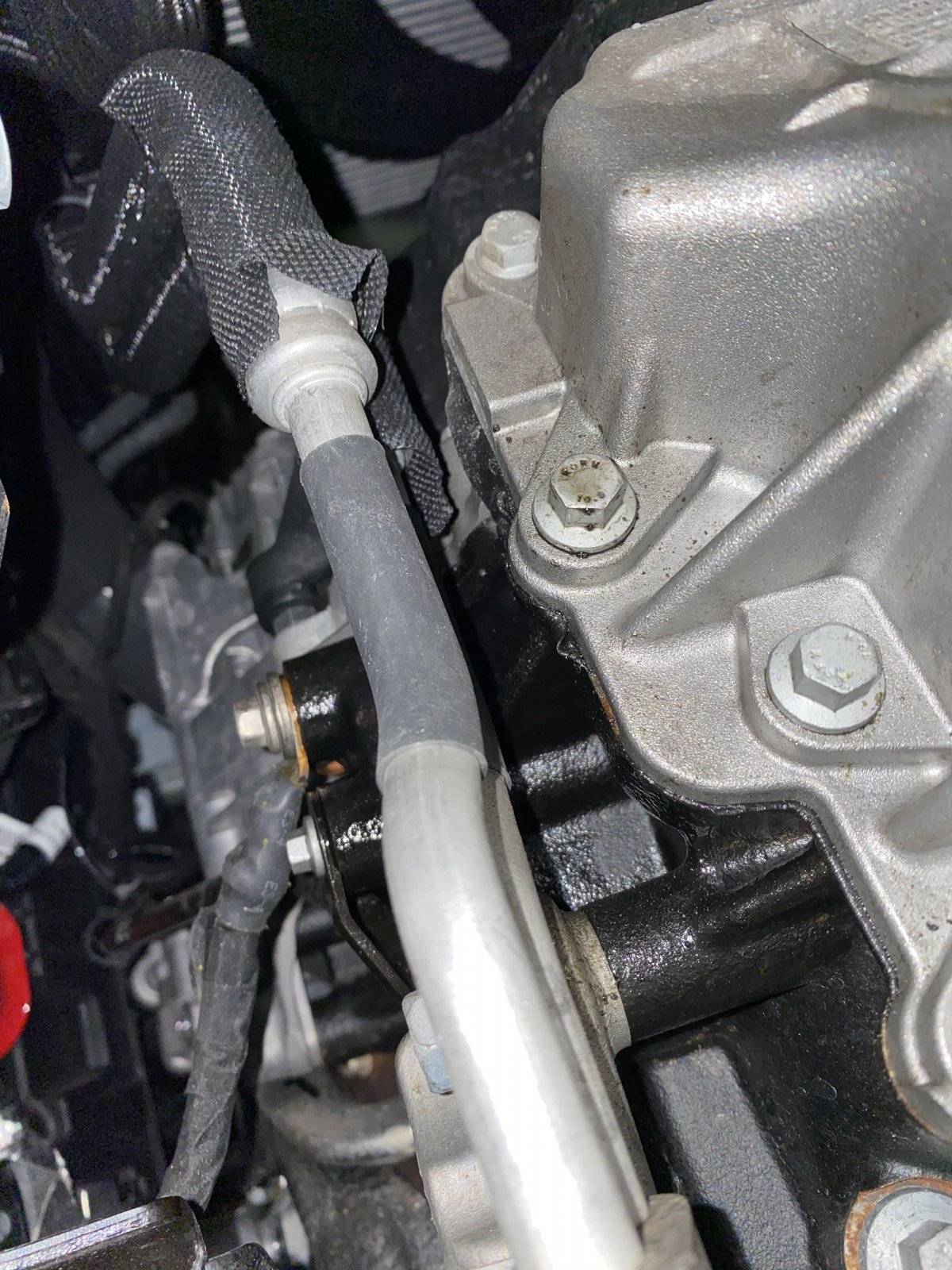

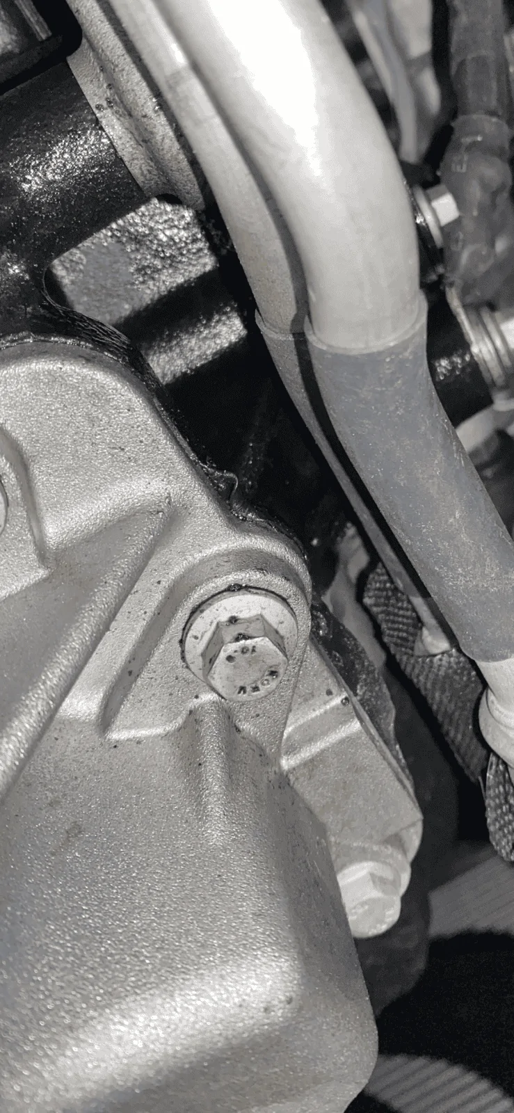

Mine is leaking oil with around 4500 miles on it. Been in already for this issue going in again tomorrow.

Mine has been leaking passenger side at the turbo oil line.

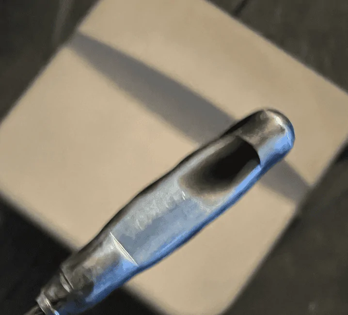

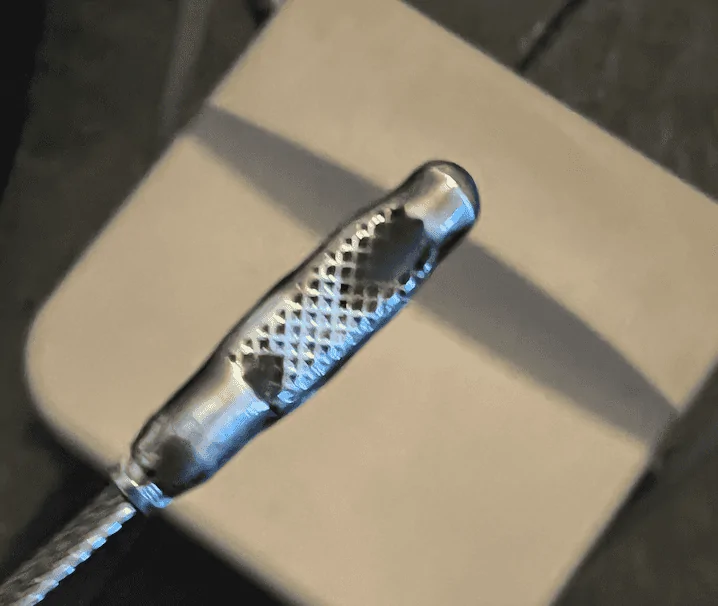

At 2800 miles - but I took the reading while the engine was sitting cold overnight.
Added 1/5th of a quart and I will check again after I run the Jeep and take the reading 30 min after shutdown.
My oil level shows 3/4 on the dipstick after sitting for several days. When operating on the highway, pulling over to fuel up after 5 minutes of shutdown it shows on the low end of the dipstick, but when I arrive to my destination and or home and I wait 30 minutes it shows full. Under "note" in the diesel supplement manual, it states: "It is possible for the oil level to be slightly higher than previous check this would be due to diesel fuel that may temporary be in the crankcase due to operation of the diesel particulate filter regeneration strategy. This fuel will evaporate out under normal operation." All in all I think the best time to check the oil for the most accuracy is before start up after sitting overnight or longer periods. Also noted in the diesel supplement manual is the total capacity from minimum mark to maximum mark is 1 qt. It also states "to add oil only when the level on the dipstick is below minimum mark." I hope this helps, it helped me better understand. My question is at the dealership or if you choose to have your vehicle serviced for oil change how can they check the accuracy of the oil? My thought and hoped would be they know if it shows on the bottom portion of the dipstick within a few minutes I've shut down from. Reading temperature they know they have the correct amount. I always check the next morning before start up to verify. With 26000 miles to date I have never added oil. And I never exceed 7500 between oil changes
And or anything less than 20% oil life showing. I went one step further and dropped the factory oil after 3500. It is also noted in the diesel supplement manual "the engine oil installed in the engine at the factory is a high-quality energy-conserving type of lubricant." I do not like the way that read and this oil may have a very low viscosity just to meet or exceed whatever standards big brother had imposed on the manufacturer therefore I didn't want to keep the oil past 3500 miles. That's just me it may not matter but I wanted fresh oil sooner rather than later.
