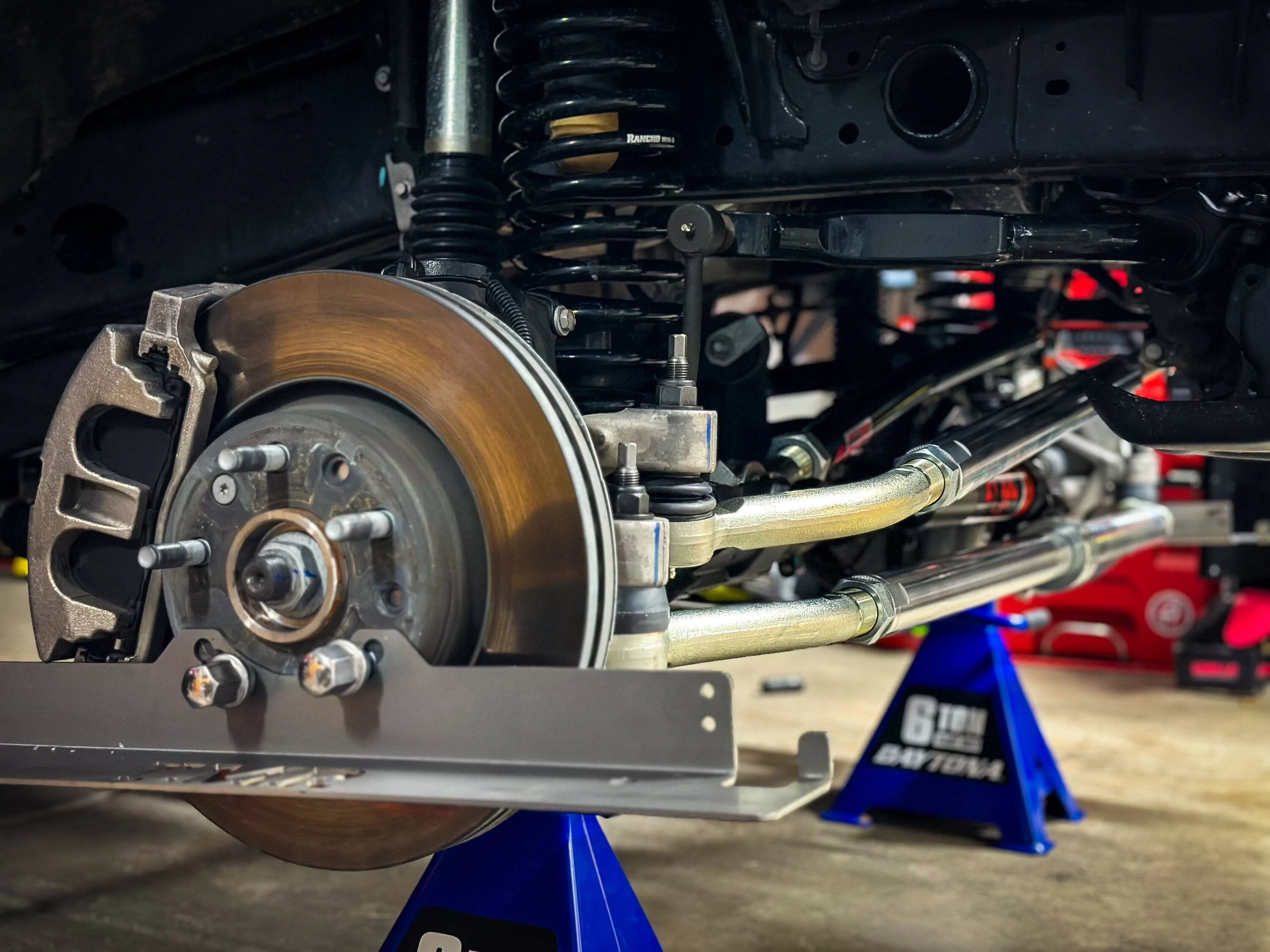

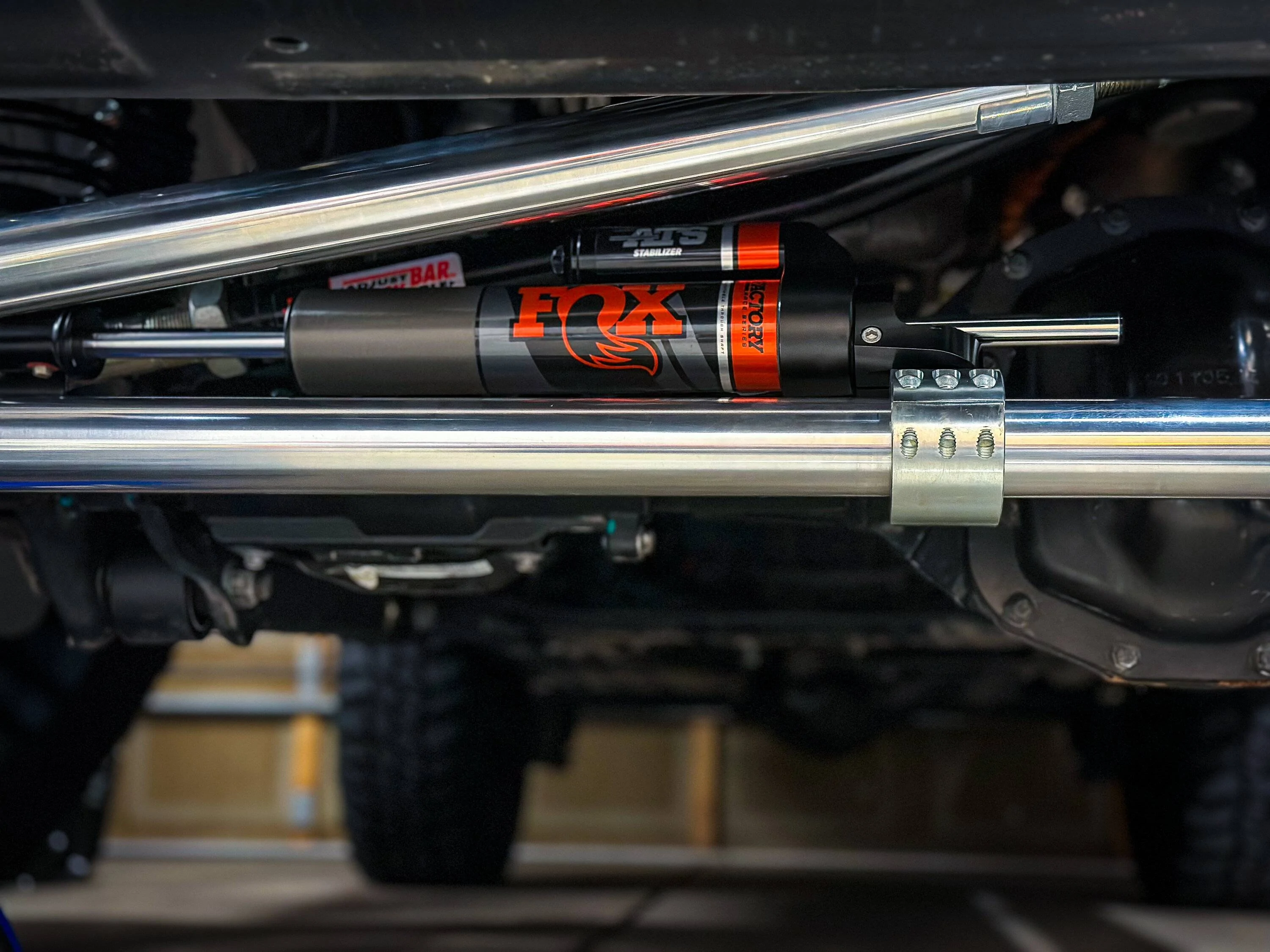

Nah, but only because it would have been extremely boring for everyone at the slow pace I’ve been upgrading the Jeep. In the past, I would grab everything at once and install.
My strategy with the 4xe has been to research the heck out an item I’m interested in, determine if it’s even needed, order/install, then evaluate its performance for a while before dropping coin on the next thing. When it becomes apparent there are areas needing improvement, I’ve had a much easier time identifying them.
For instance, I’ve been running the stock tie rod and drag link for 19,000 miles, 6,000+ on 37s. IMO, the heavy tires have accelerated the wear of the ball joints based on the slop they had. So…Black Friday came around and I grabbed an upgrade I had been eyeing all year.
Rusty’s Aluminum HD Steering Kit. Love their stuff!
