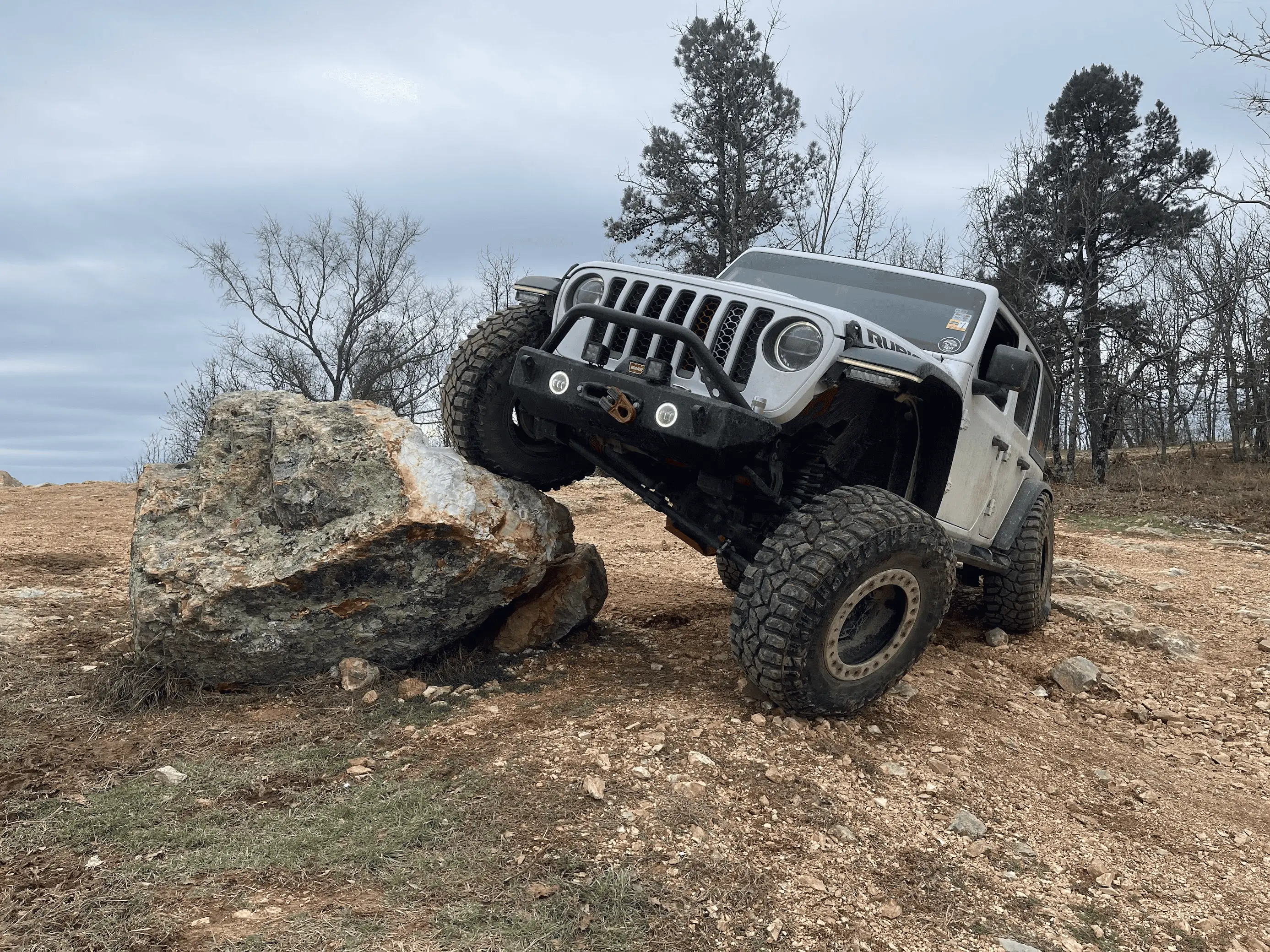

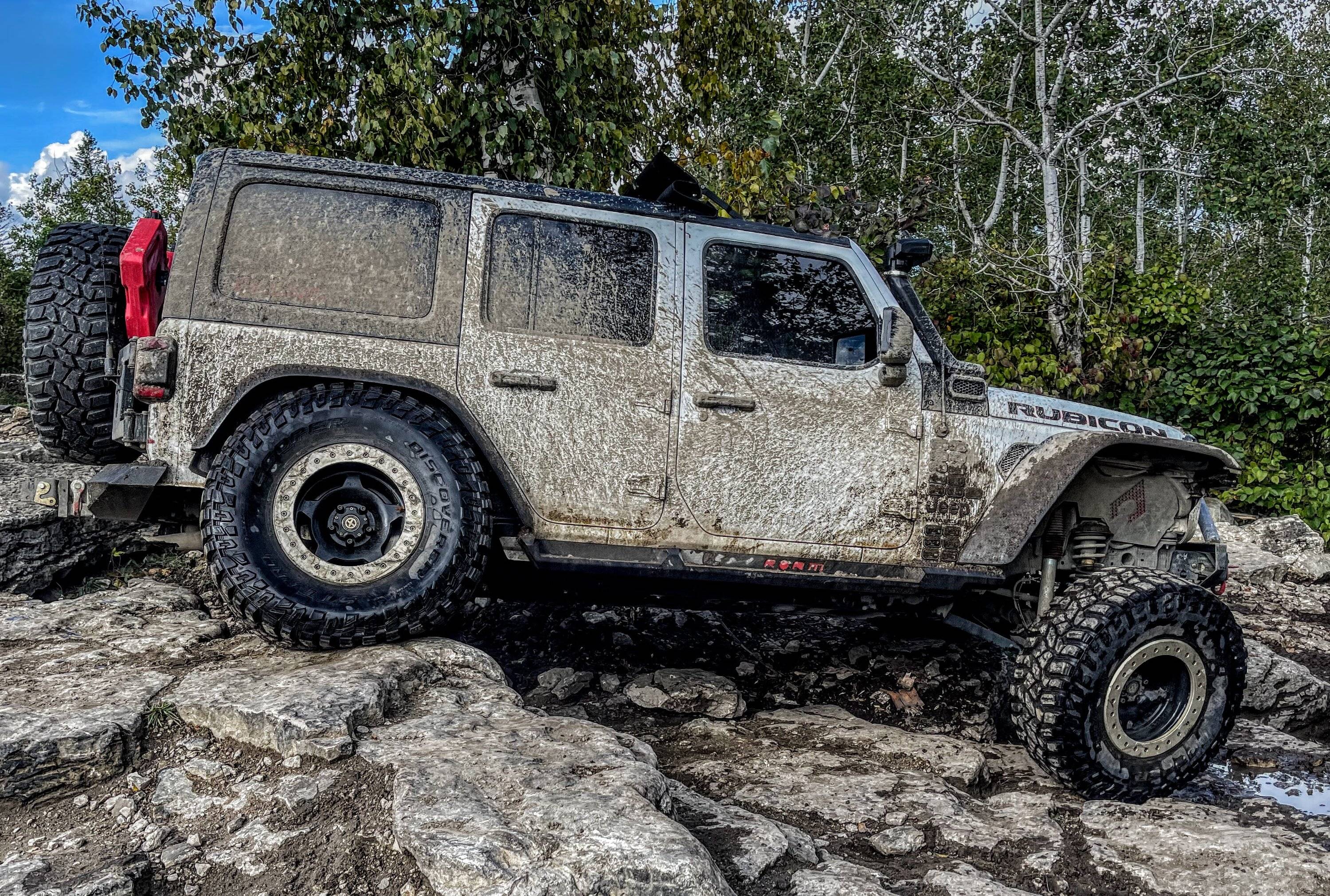

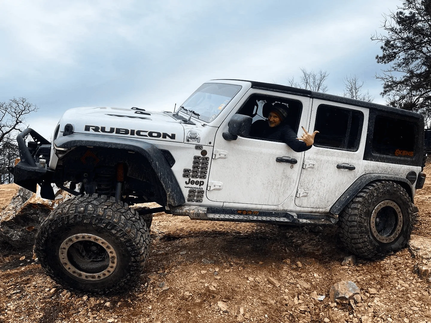

My jeep flexes like this
Jeep Wrangler JL 37s & Regrets? 1702042566422
Jeep Wrangler JL 37s & Regrets? 1702042597692
Jeep Wrangler JL 37s & Regrets? IMG_2255

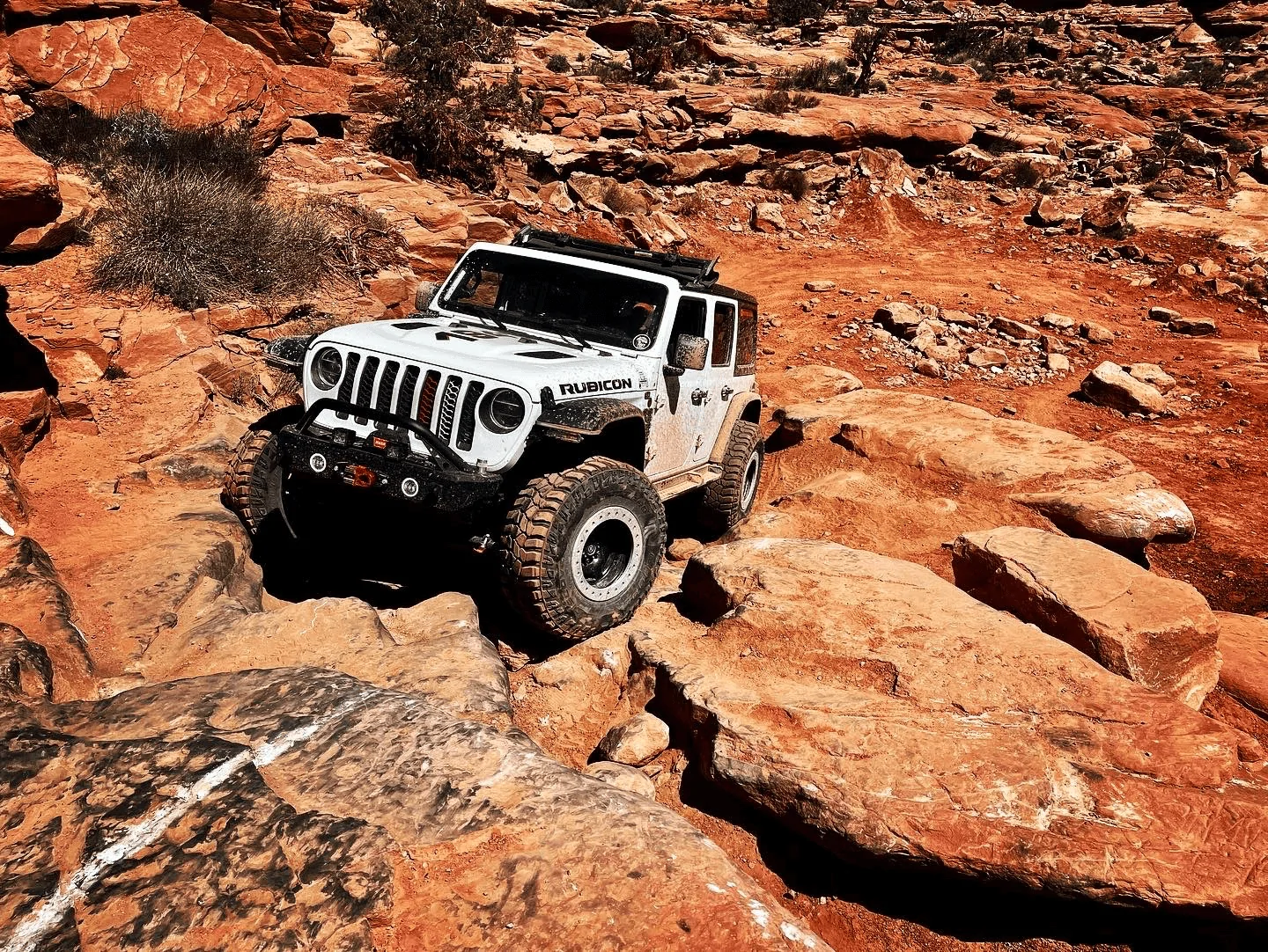

As far as wheeling, we have done 55 badge trails and wheeled many of the harder Jeep trails in the country. Think Moab three times and 50 or so trails in Moab including Pritchett Canyon, Cliffhanger. Rubicon Trail, blab blab blab. Everyone that rides in my Jeep for the first time always says the same thing. I can't believe how nice this rides. I turn the shocks down to soft on the road and firm them up off road.
Jeep Wrangler JL 37s & Regrets? 1702043309409
At the end of the day, it is your money spend it how you want. Just know that lifts are not complicated. Most of the stuff that others provide with a lift is not needed and it is added due to marketing and to justify the cost. That is why I say, if you're going to spend big money on a lift, do it on a long arm kits and high end shocks. If you are going to do trails and wheel like 90% of the people on this forum. Save your money and take your Jeep to Moab or Colorado or Arizona or Tennessee, where ever you have dreamed about wheeling your Jeep.
