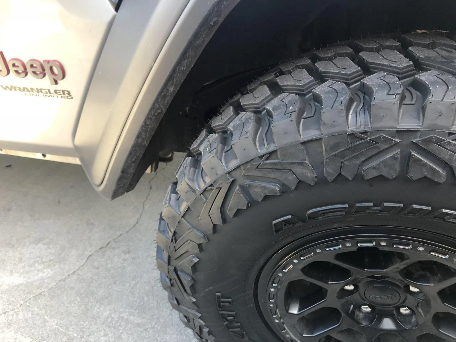

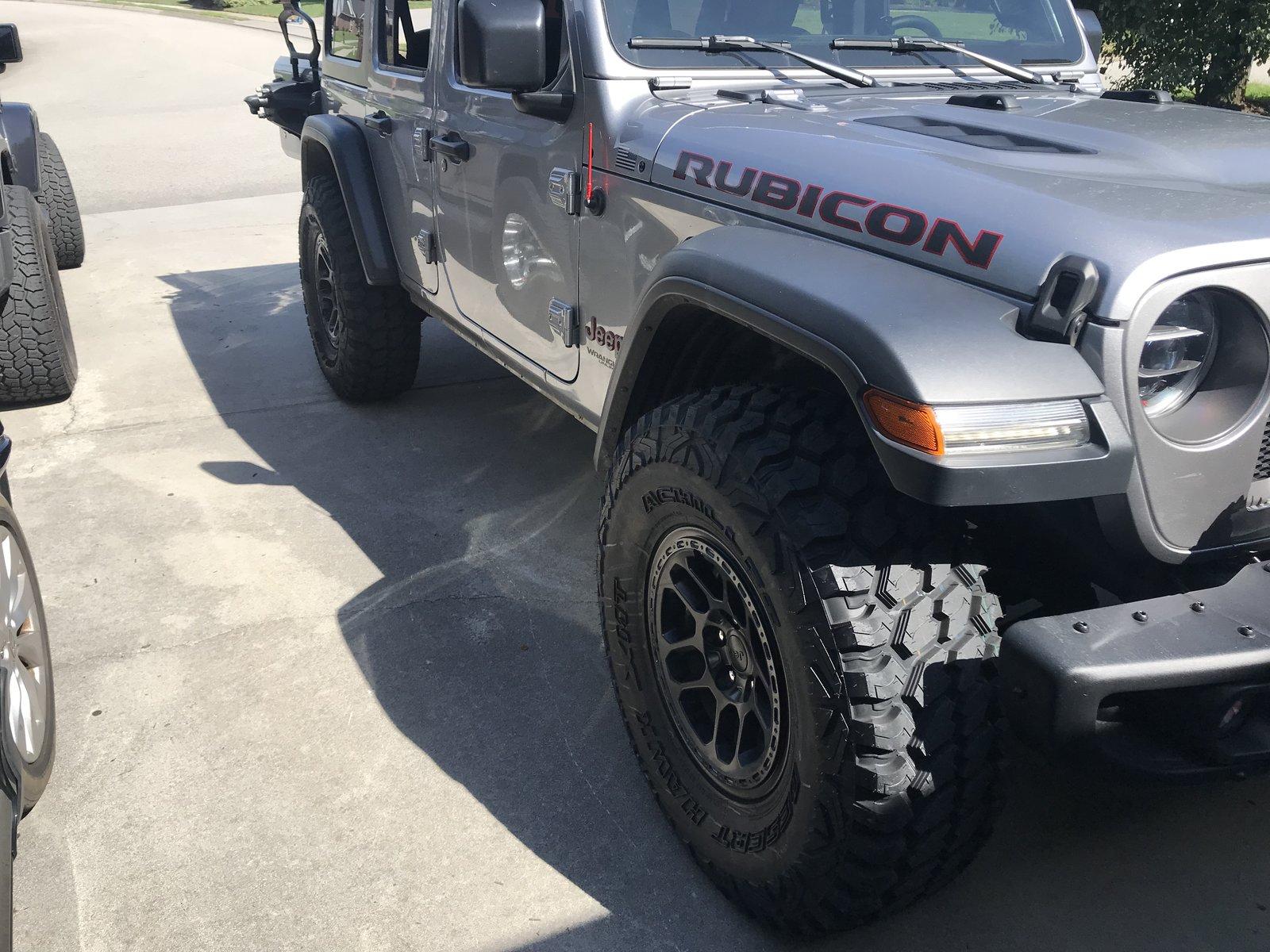

Echo @Karl_in_Chicago comments.
I had to get new tires this week (not surprisingly, my wife liked my 315’s so much she kept them), and will install a 2-2 1/2” loft as soon as I make time to install.
So 8 put the cart before the horse and got 37’s.
So, do they “fit” - yes... but they rub Like a bad massage parlor - everywhere I don’t want it to.
I’m relegated to smooth pavement until,I pull the trigger on my lift. It’s a good motivator!

SeekRest, Very nice ride!!!! Who is the MFG of the tires and rims? Wheel size and b/s and offset? I agree about getting a Tazaer, you get so much more for the extra cost, g
Good luck with the lift, you have to give us a before and after pic!

Got to love a full wheel well. The 37's look great. That is my next upgrade. How loud do they sing?

Thanks!
Wheels are Mopar beadlock - note my lock ring is off in order to get a tire shop to mount the tires
https://www.jlwranglerforums.com/fo...-your-jeep-jl-today.3033/page-391#post-310507
I looked up the offset at one point (when we put them on my wife’s Sahara for a trial run) but can’t find it now. The B/S is 4.5”
The tires are a compromise - I wanted the Patagonia MT, but timing and availability didn’t line up. So I went with the Achilles Desert Hawk X-MT. “Economy” tires are notorious for balance and round issues, and I inspected as best I could before they started, and Worked with the tech mounting them to line up the red dot (amazed this has become a lost knowledge in the field) and they all balanced out with minimal weight (1oz or less).
Made a road trip up to Lexington, KY with the Wednesday, and zero issues at 80ish (speedometer calibration yet to come).
Getting a set of five 37 12.50” tires mounted for ~$1k all-in, my expectations of longevity are low, and off road tests will have to wait.
I will try and grab some pictures before I start the lift
At slow speeds, they’re like a back massager on dying batteries.
The road noise isn’t too bad, and with a moderate radio volume, I don’t notice it.
There is no denying the taller sidewalk and resulting flex when driving curves. That’s to be expected.
Can’t speak to wet pavement behavior, other than I didn’t notice any issues in the rain on the highway.
