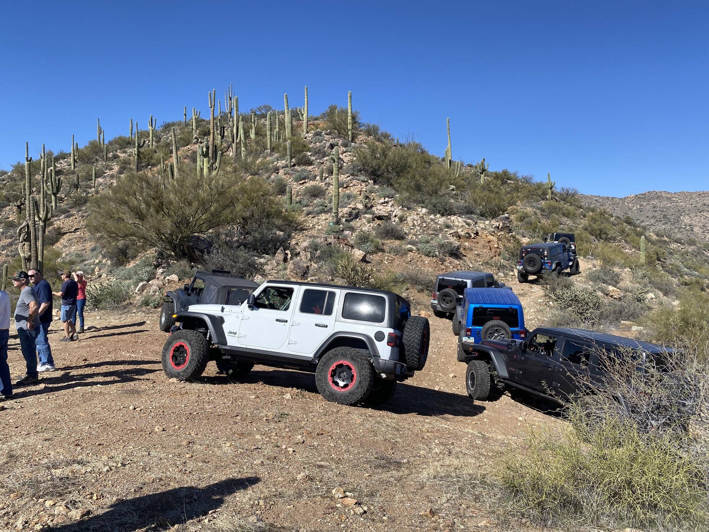

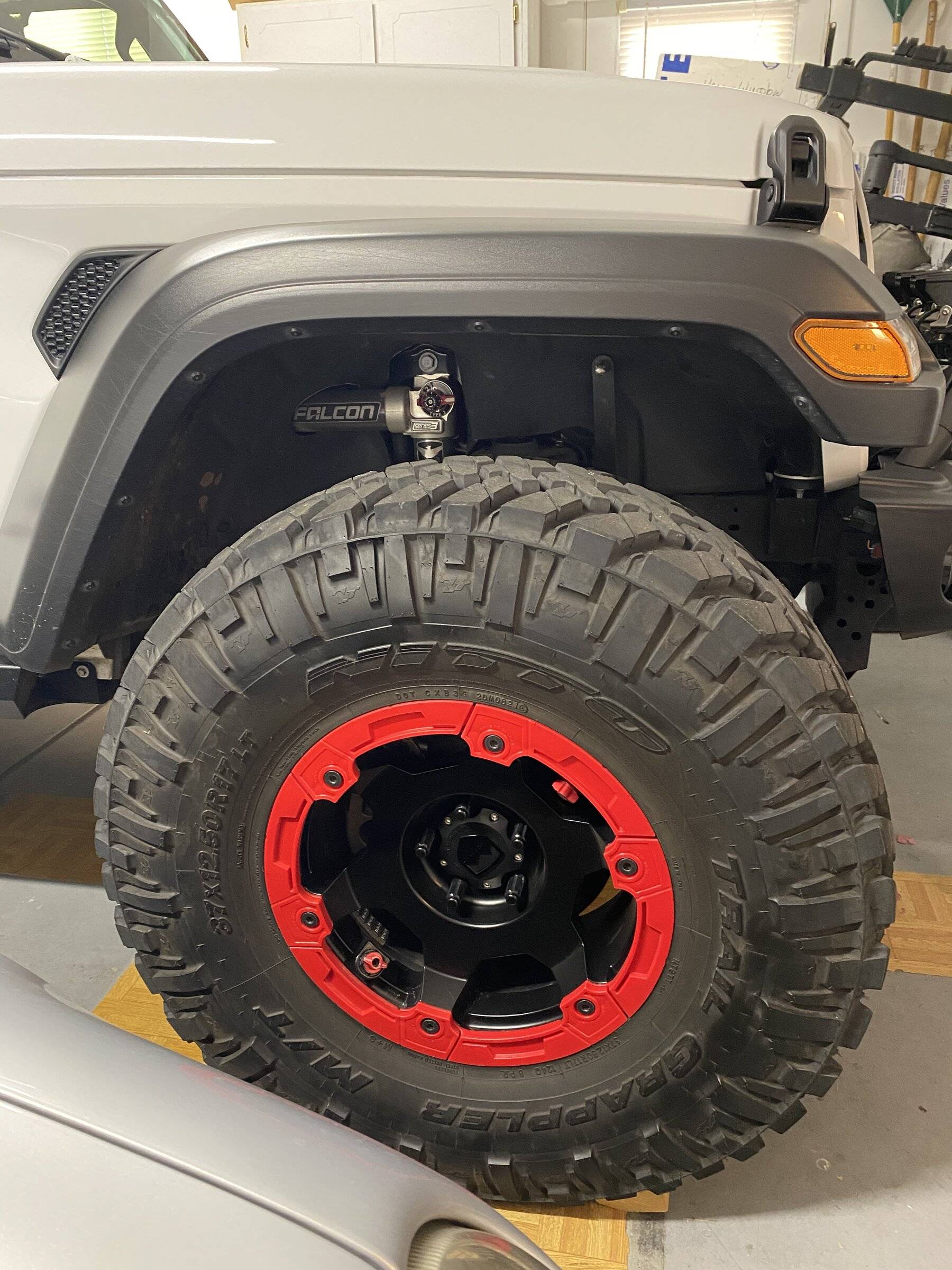

I am running 37s Nitto Ridge grappler with the Nomad wheels. I have the Rubicon axles but went with 4.88 gears. Jeep drives great and is very responsive. I have the Teraflex HD Alpha tire carrier and tailgate hinge system. What a difference this made closing the tail gate. I have had the steering gear box replacement and am running the steer smart tie road ends and track bar.
Also have the @Clayton Off Road 2.5 overland plus lift with the Falcon 3.3 shocks.
