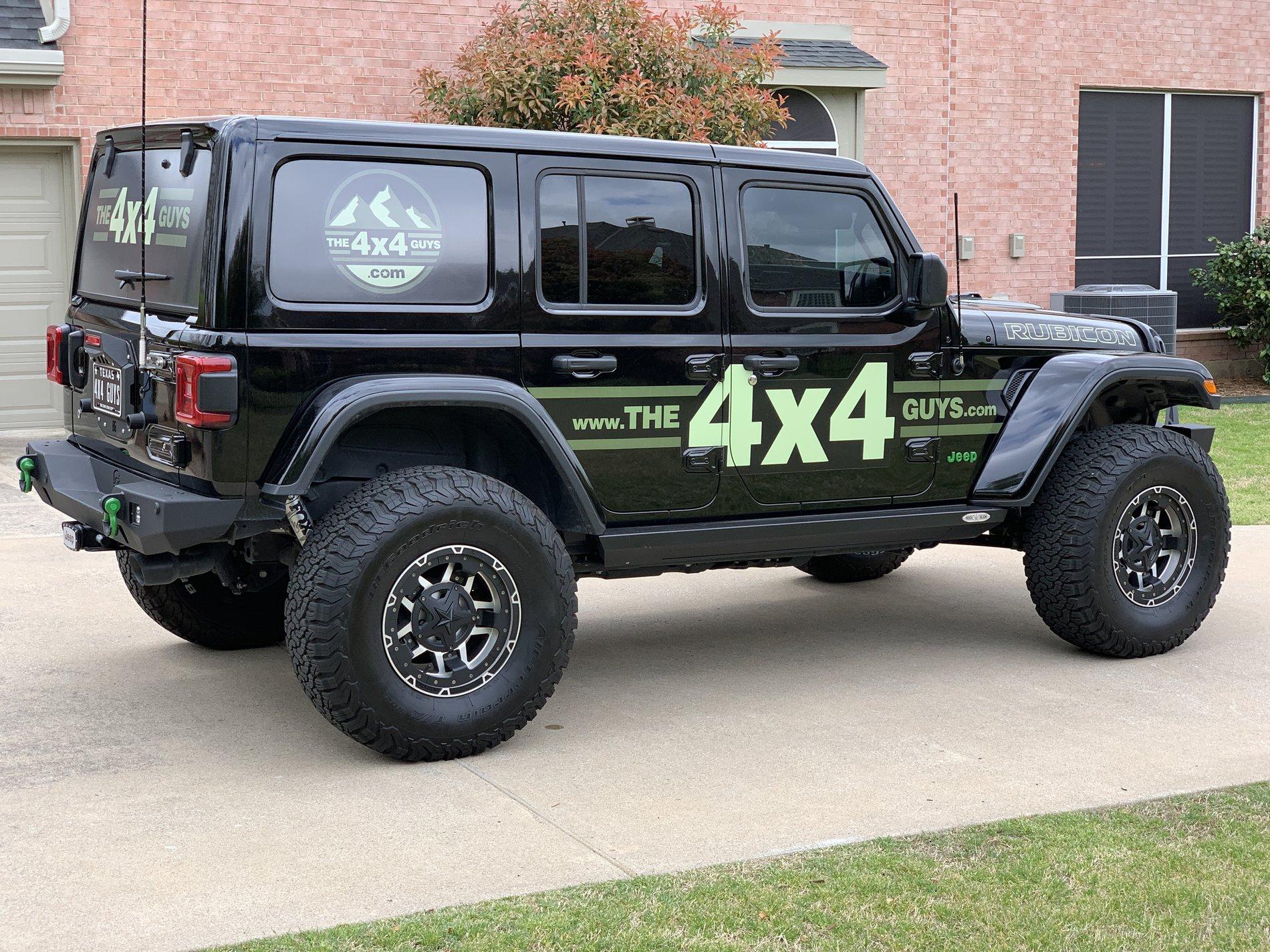

I was the second poster to this original thread in 2018. After reading here and doing my research, I installed 37" BFG KO2's on KMD Rockstar wheels along with a Mopar 2" inch lift kit. I also replaced the front and read bumpers and when doing so, I removed the small section at the bottom rear of the back wheel wells that connected to the rear bumper.
I've never had a single rubbing issue and I wouldn't trade my 37's for anything, except maybe 40's (who says size doesn't matter). I've had so many positive comments about my Jeep on 37's and I've also driven for twelve hours straight at highways speeds (+ 85 mph in 8th gear).
I did install a set of Rock slide Engineering drop down step/sliders to deal with the increased entry height for my wife and granddaughter and frankly it helps me too. I love the look and driving feel of the JLUR on 37's.
Jeep Wrangler JL Regret 37s? IMG_0352
By the way, the spare is being remounted this weekend using the Mopar hinge reinforcement kit (already owned it from original purchase) and the Teraflex HD spare tire carrier kit, along with the Artec license plate mounting kit with the Off Road Only license plate lighting kit. More pics after the install.
