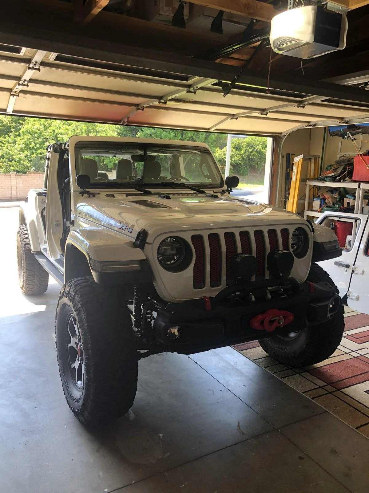

I made the classic noob mistake of going with 35's vs 37's. I thought the Jeep would get sluggish with bigger tires, so I wanted to minimize that affect. I also didn't want too much height for 35's, so I went with the "true 2 inch" Dynatrac lift supplemented with the full SteerSmarts front end treatment and all 8 control arms and rear track bar from Synergy. The Jeep drives and handles better than before and barely notices the extra component weight and tire diameter.
Jeep Wrangler JL Regret 37s? 20200423_092730
That lack of performance loss ate at me for about 10k miles. The added capability that 37's could've brought to the table. I caved. Didn't take much. Knew I'd be pushing things to shoehorn 37x12.5's on the factory wheels, and the +44 offset was already crowding the 35's to the under bits. So went with 17x9 -12 (4.53" b.s.) KMC XD138 Brutes. I've been eyeing the Milestar Pat's, but wasn't crazy about the 37x12.5's D-rating, so ended up with the C-rated 38x13.50's.
Jeep Wrangler JL Regret 37s? 1590247435754
I'm now extremely pleased with the added capability that comes with larger tires. I've chopped all the fenders for more clearance, but am now on the verge of pulling the Dynatrac springs and shocks and replace them with a set of 3.5 Metalcloak springs. Still trying to decide between Rocksports or 6-packs, or possibly a 2.5" set of Fox's from Accutune.
