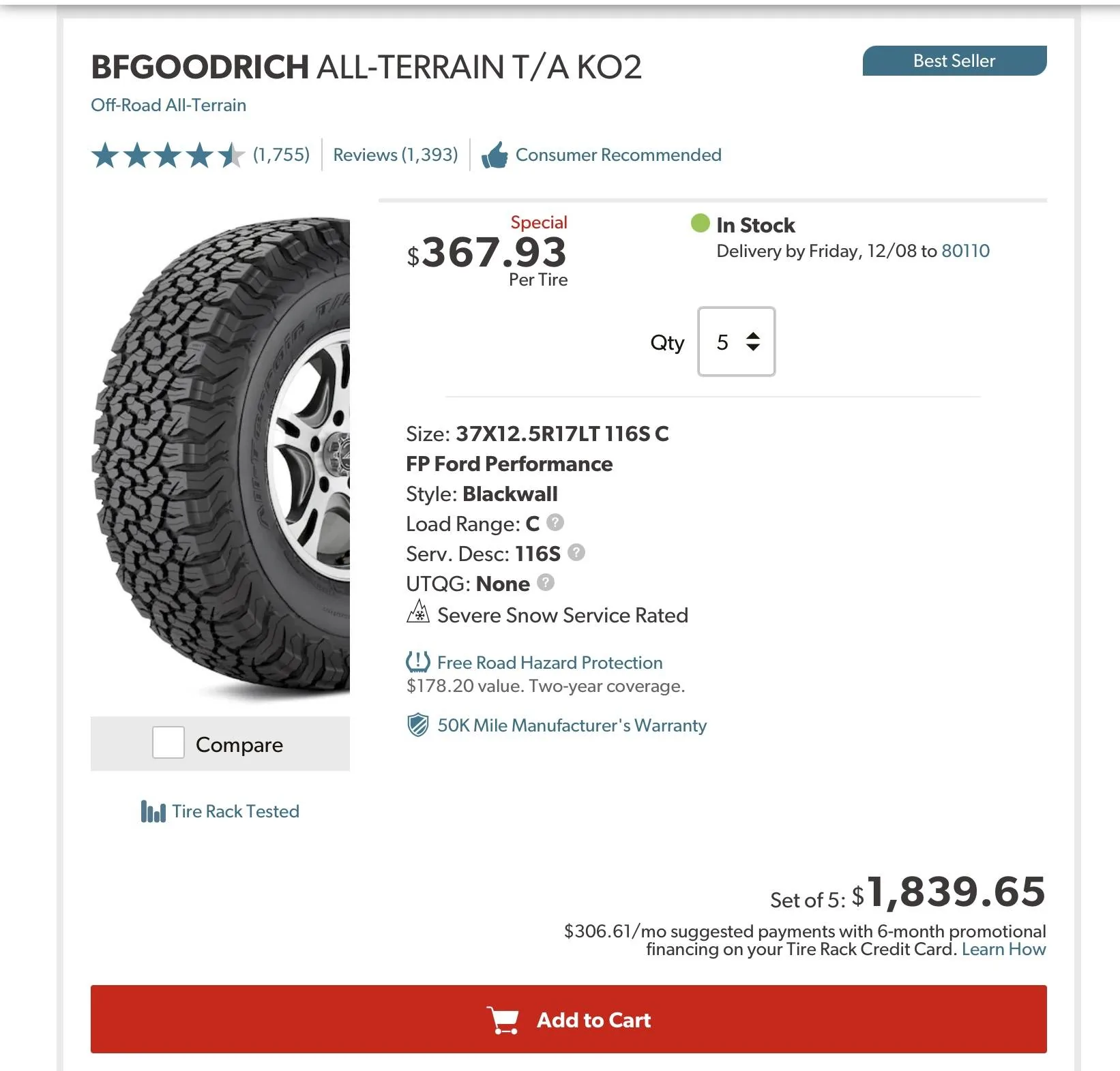

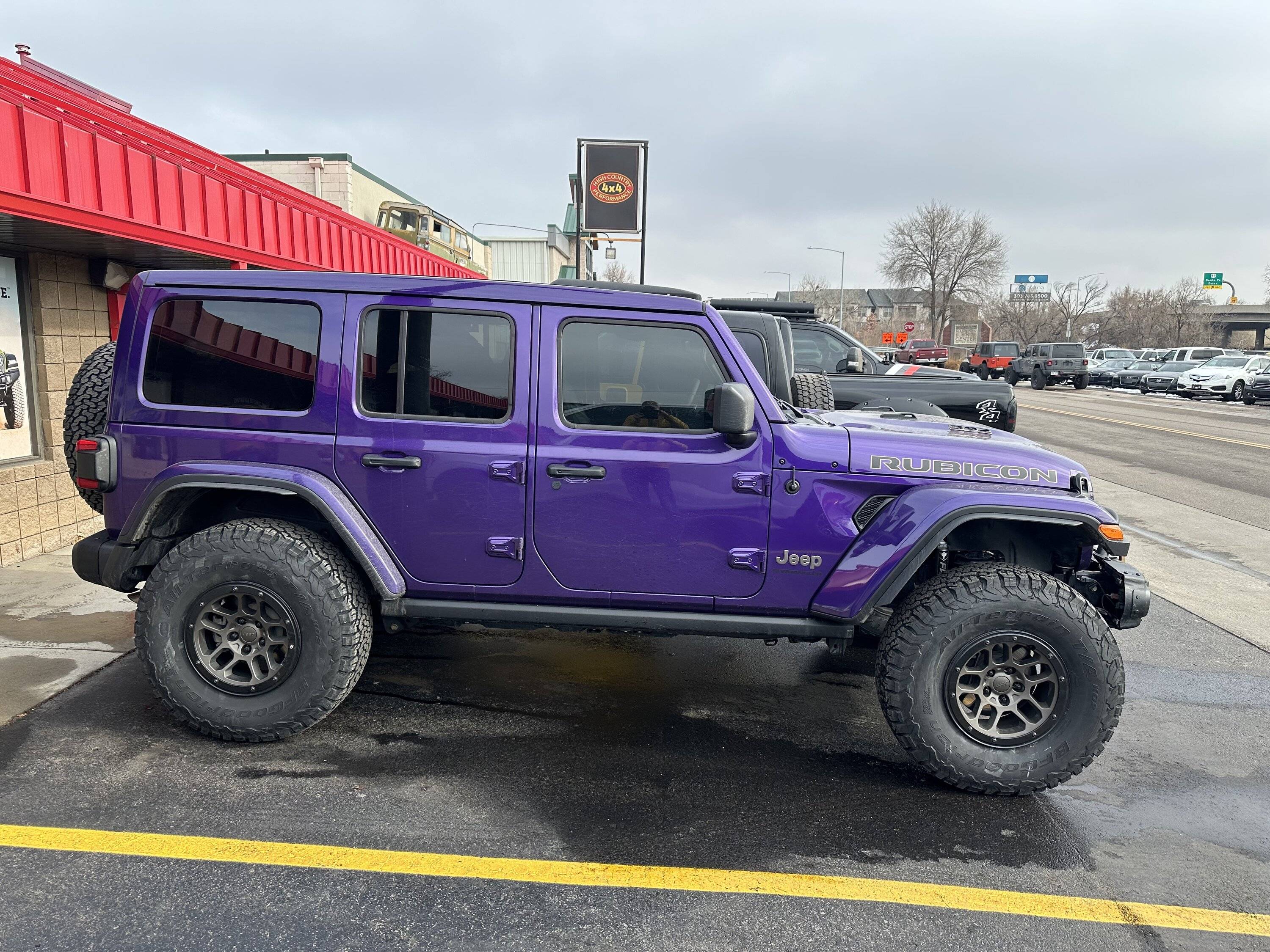

No regrets. Rubi axles and 8AT were made for 37s. Was annoyed enough living in the mountains to regear to 4.88. YMMV.
Jeep Wrangler JL 37s & Regrets? IMG_3233
Decent deal on KO2s so I’m throwing 37s on my 392 XR this week for Xmas.

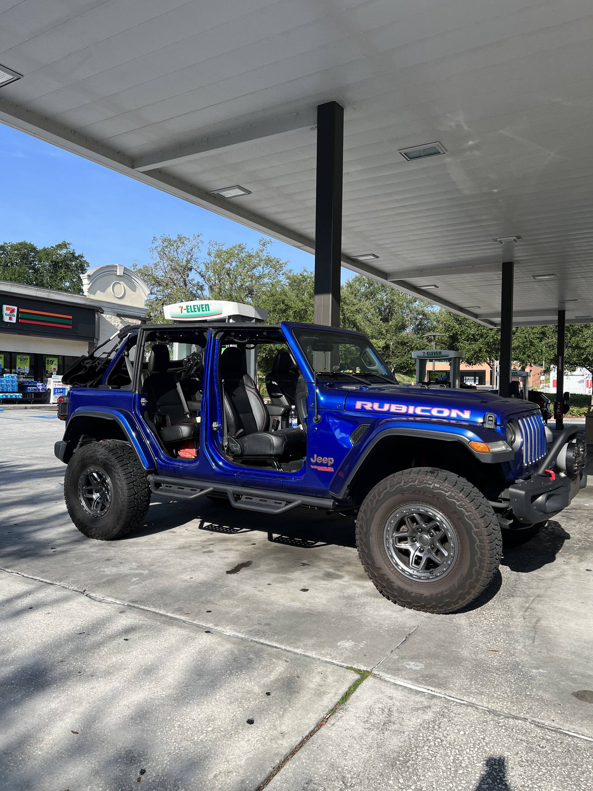

Gotta thank @wibornz for sending me down the rabbit hole on the Rancho 2 -3.5 lift. I haven’t seen any cons to this lift. Even with adding geo brackets and a trackbar it come in cheaper than the aev. Might even be able to convince the wife to do the re gear with the savings.
Thanks again!
Same here :clap: … Riding on 35s right now but will go 37s when I need to get a new set of tires. I got the 2” Lift with the RS9000 and geo bracket for just $757 from Northridge 4X4 when they had sale and discount for spending over a certain amount.

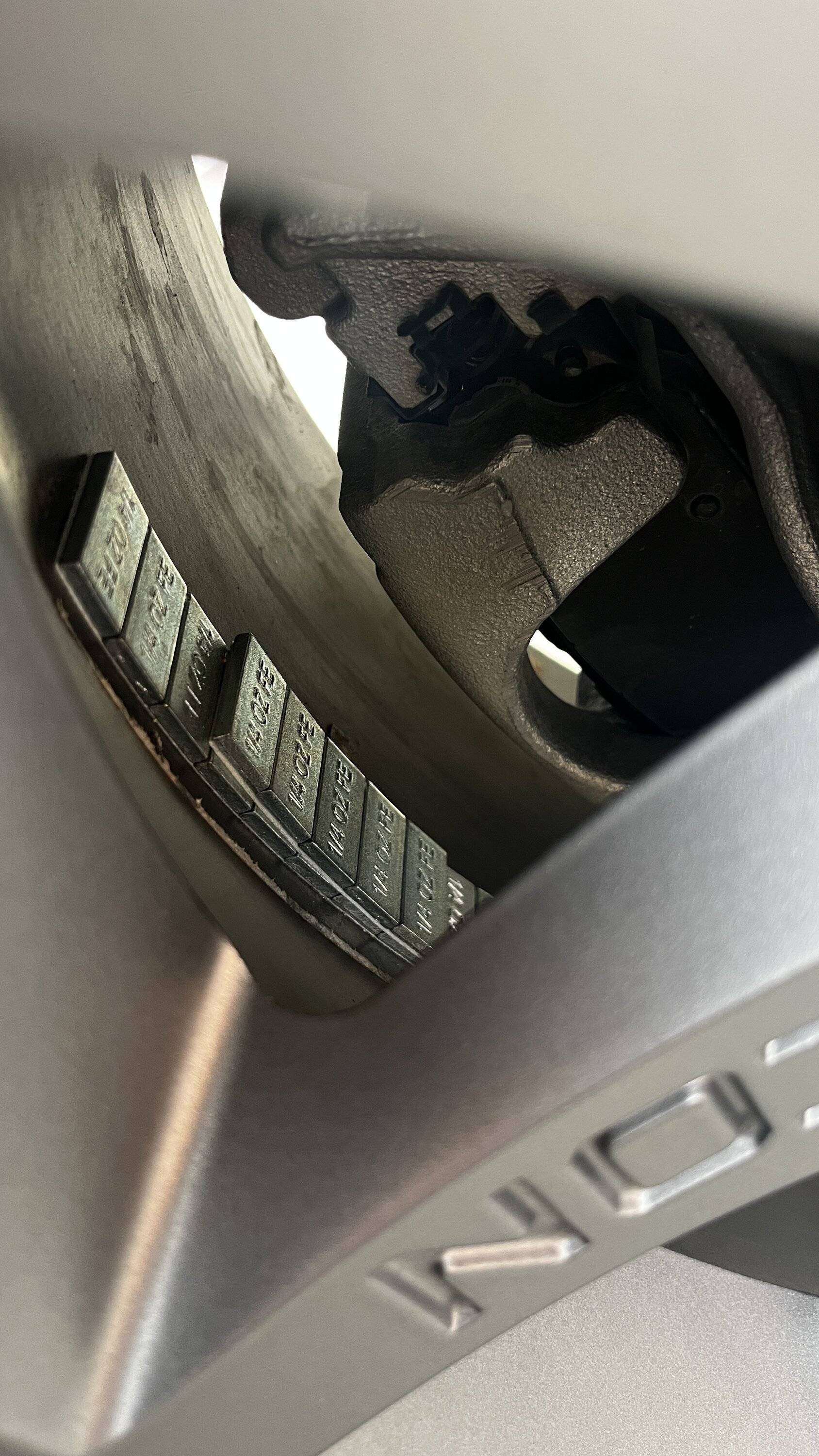

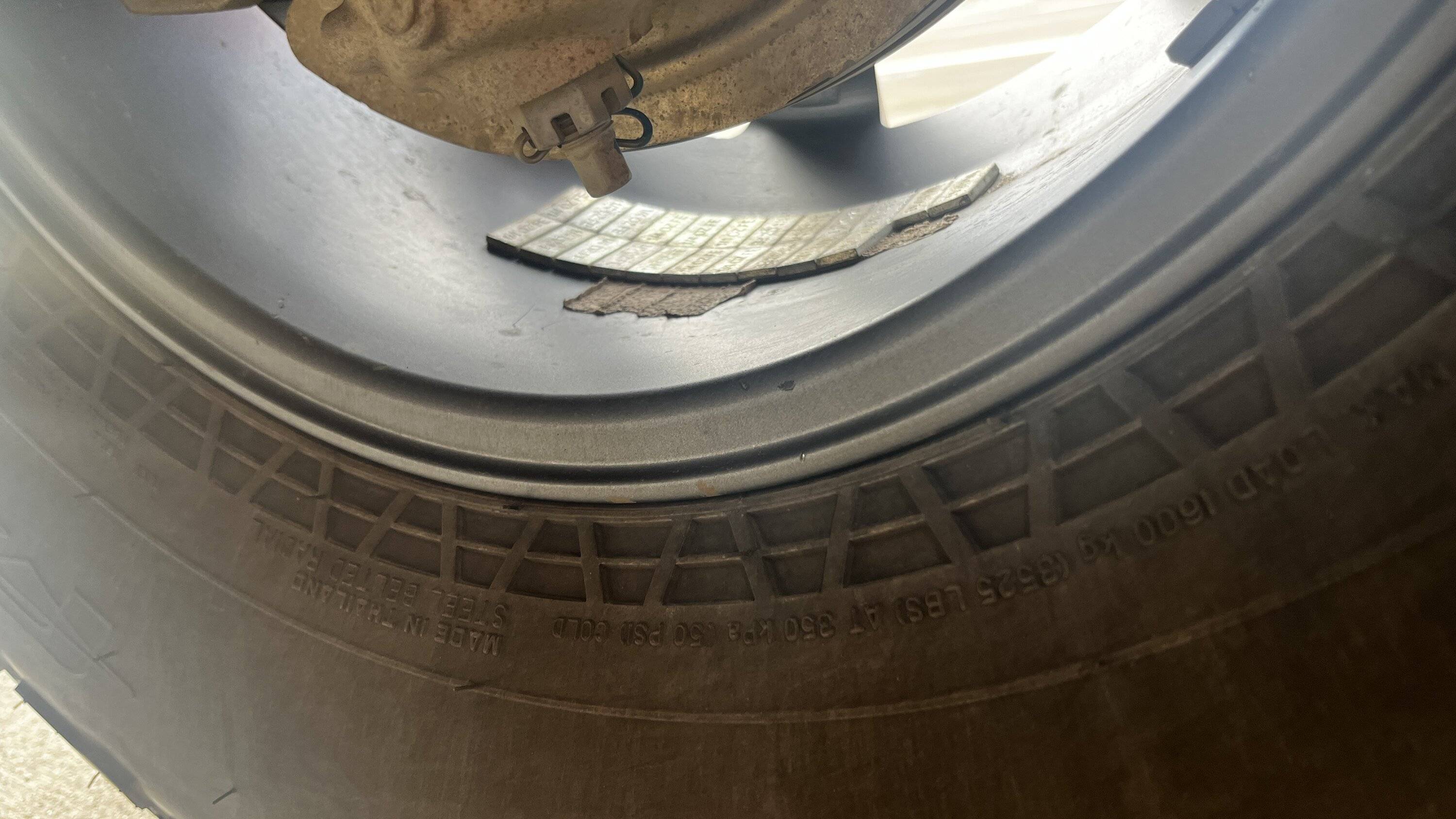

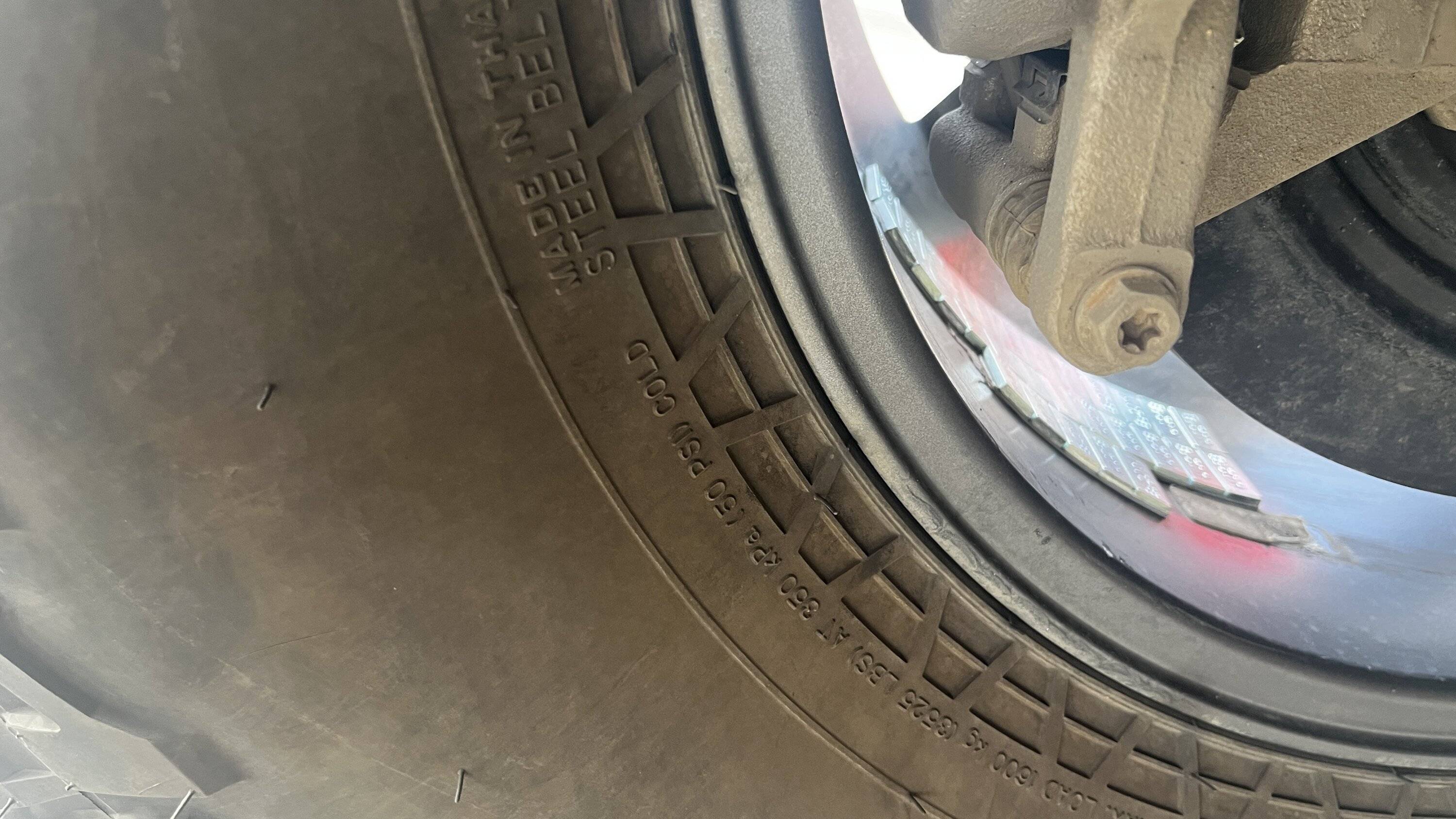

I somewhat regret going 37s. That's only because the Jeep drives like crap now. I installed a Clayton Overland+ 2.5" and 37" Wildpeak AT3Ws on Icon Rebound rims. I get a lot of shimmy in the steering wheel and I've spend well over $1000 on alignments and troubleshooting for everyone to just come back and say, "it looks good, pay us!" or "your Jeep drives better than mine!"
If I could actually get the thing to drive well and the steering wheel to stop shaking like Shakira's hips, I would love my Jeep again, just like I loved it stock.
I just ordered the adjustable Fox Race steering stabilizer, installing it this weekend. Hoping that helps resolve my issue. I really think it's a bad tire/rim pairing but I cannot find anyone to trade me 37s for a day to confirm and I'm sure the heck not rich to just go out and spend $4000 on new rims and tires just to troubleshoot something.
May want to check into having tires trued.
Realized that you'll loose a little tread, but will ride as good as the tire can.
Unless you have a defective tire? Any tire have excessive weights to balance? If so, maybe break tire from rim , rotate on rim and rebalance. Should have been mounted/balanced that way from start, but not every tire shop takes the time to mount with least amount of weight.

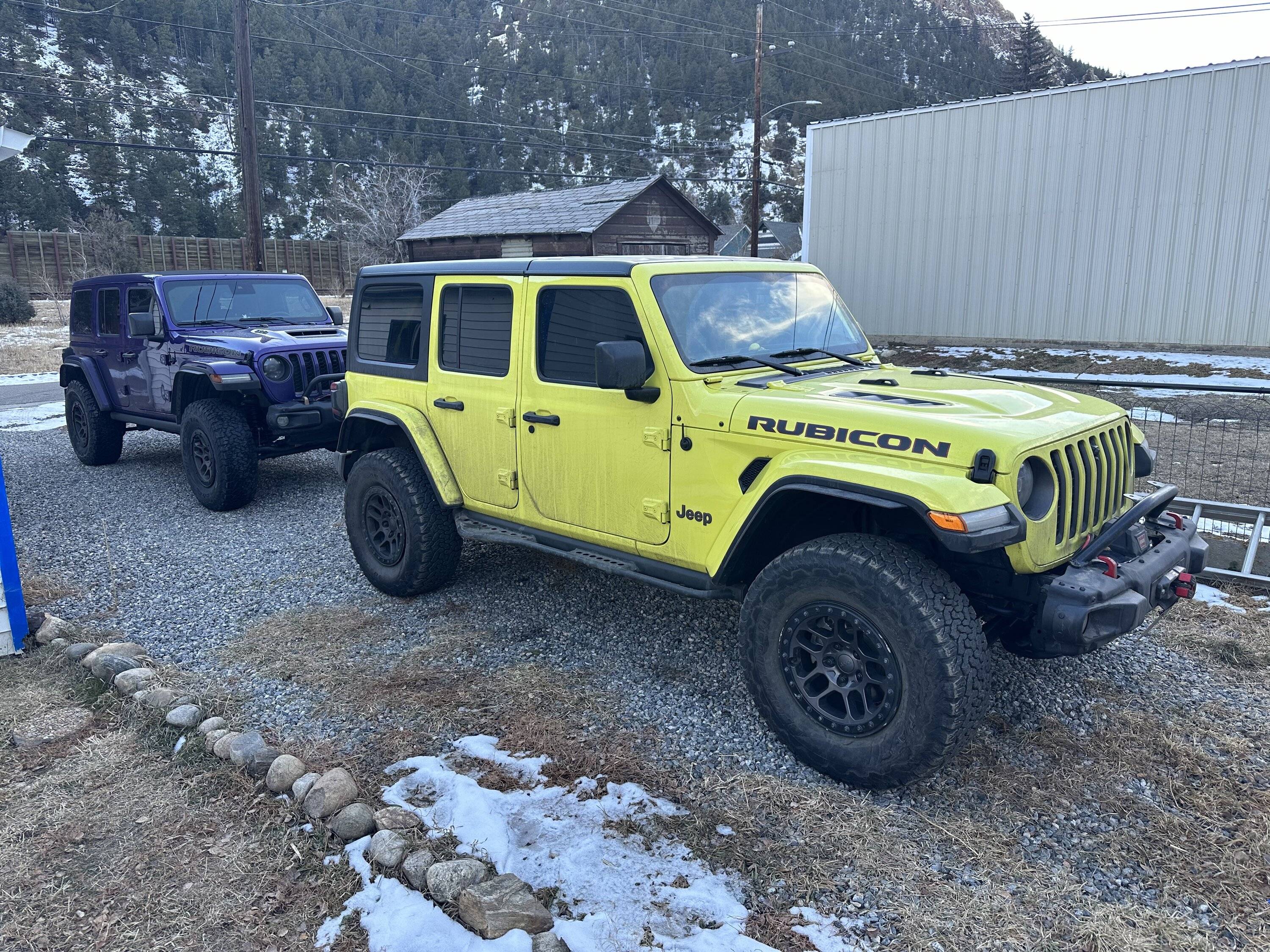

I think I've passed you before. Reign on a 392 is a rare sight so it definitely caught my attention. I'd be amazed if there's another one in the area like yours. Gorgeous spec ?
Thank you! I think there are 150 purple 392 XRs running around. Reign pairs well with the bronze accents.
Stock suspension?
Negative. Clayton performance springs, 1” front pucks to counteract the winch, Falcon 3.1 shocks and 2.1 steering stab, Hellwig rear swaybar, and longer MOPAR front LCAs.
Went for more of a pavement Princess build, but now it’s almost as capable as the two door. Thinking about wheeling her more. Maybe Artec or Asfir aluminum skids.
Here‘s a comparison with another XR on stock suspension and 35s.

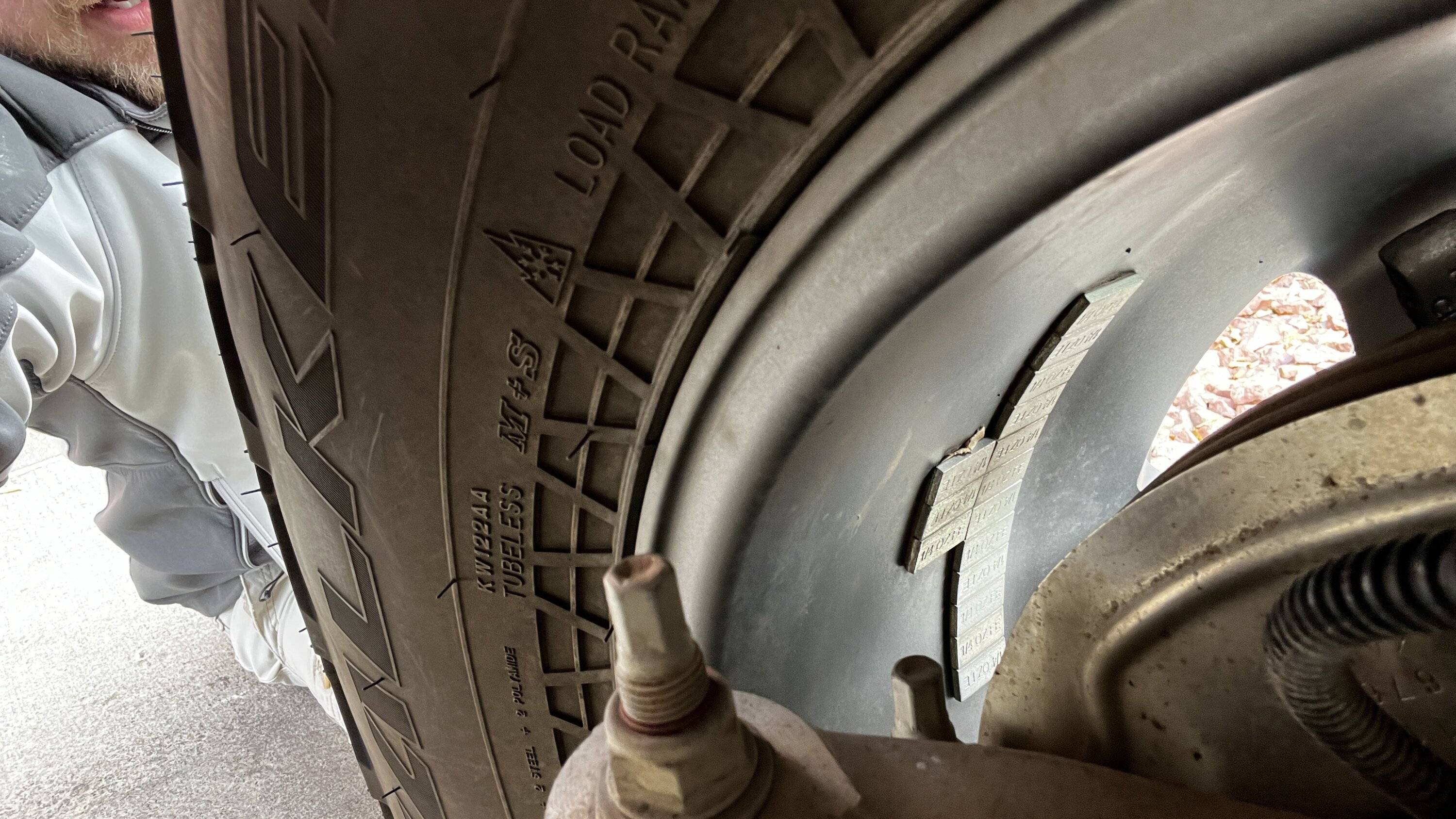

I would say they all have excessive weight to balance. But I don’t know what defines “excessive” in the large tire Jeep world. I remember on sedans, like 1 or 2 small weights be my wheels…..I’ve never seen weights stacked before.
