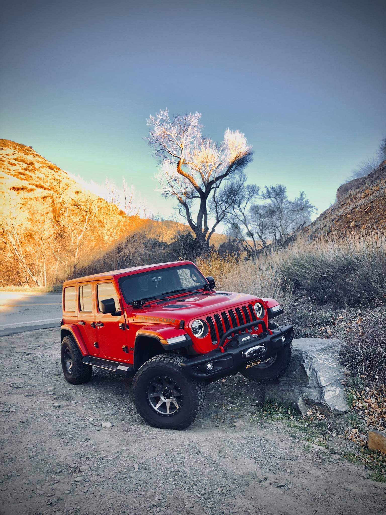

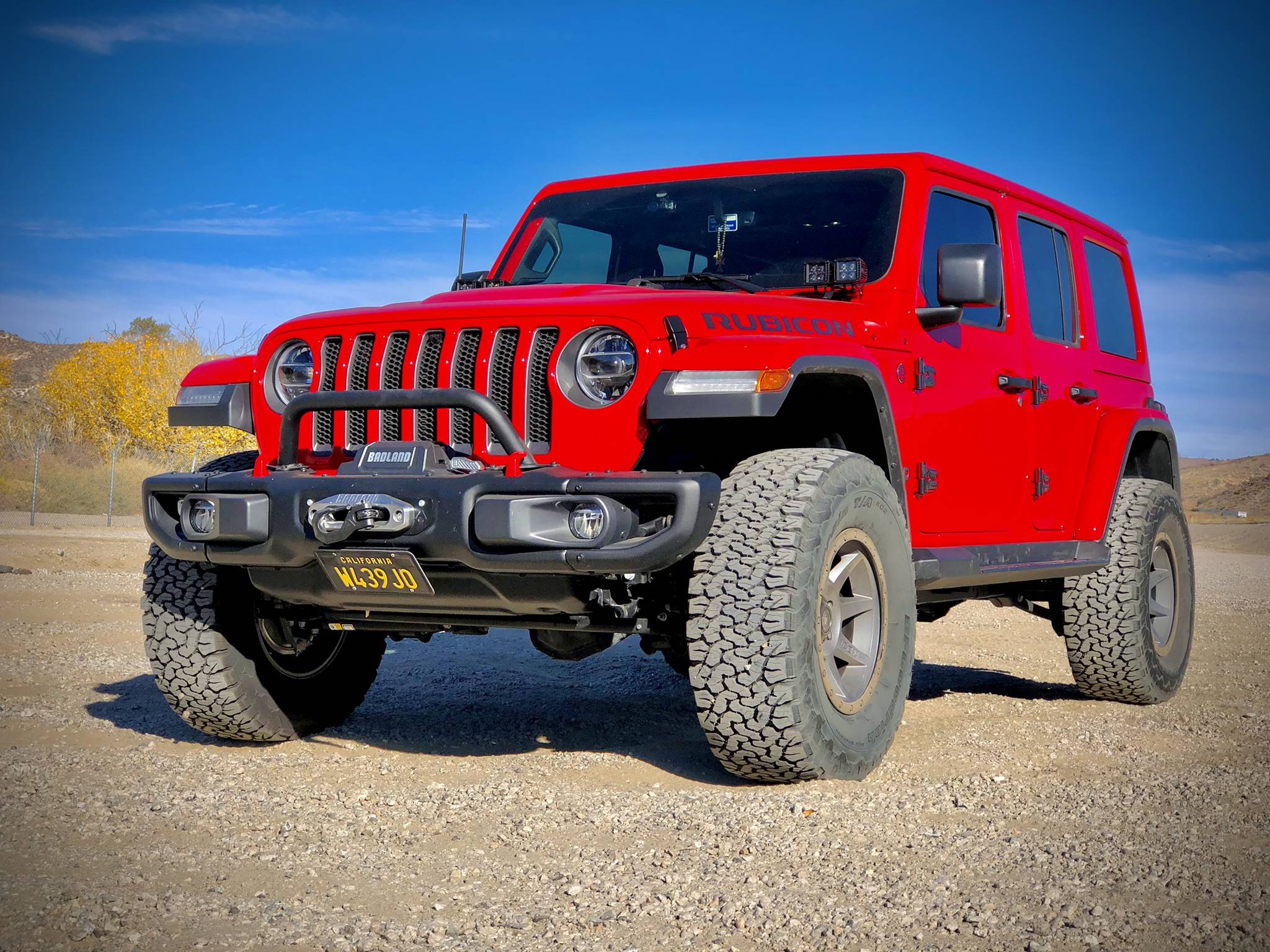

Been running small 35s (315/70R17 KO2s) since July and I honestly don’t regret it. The C Load 37” ko2s weren’t released yet so I’m happy with my setup! Running them with the dynatrac Endurosport with the mopar front LCAs and a set of Teraflex 1/2” front coil spacers for leveling. My jeep is way more capable than I am and I have zero regrets. Having said all that, it is in the back of my mind to upgrade to the new, aforementioned 37” ko2s in a few years, especially since they’re quoted by Bfg as only being 1-2lbs heavier than my current 35s.

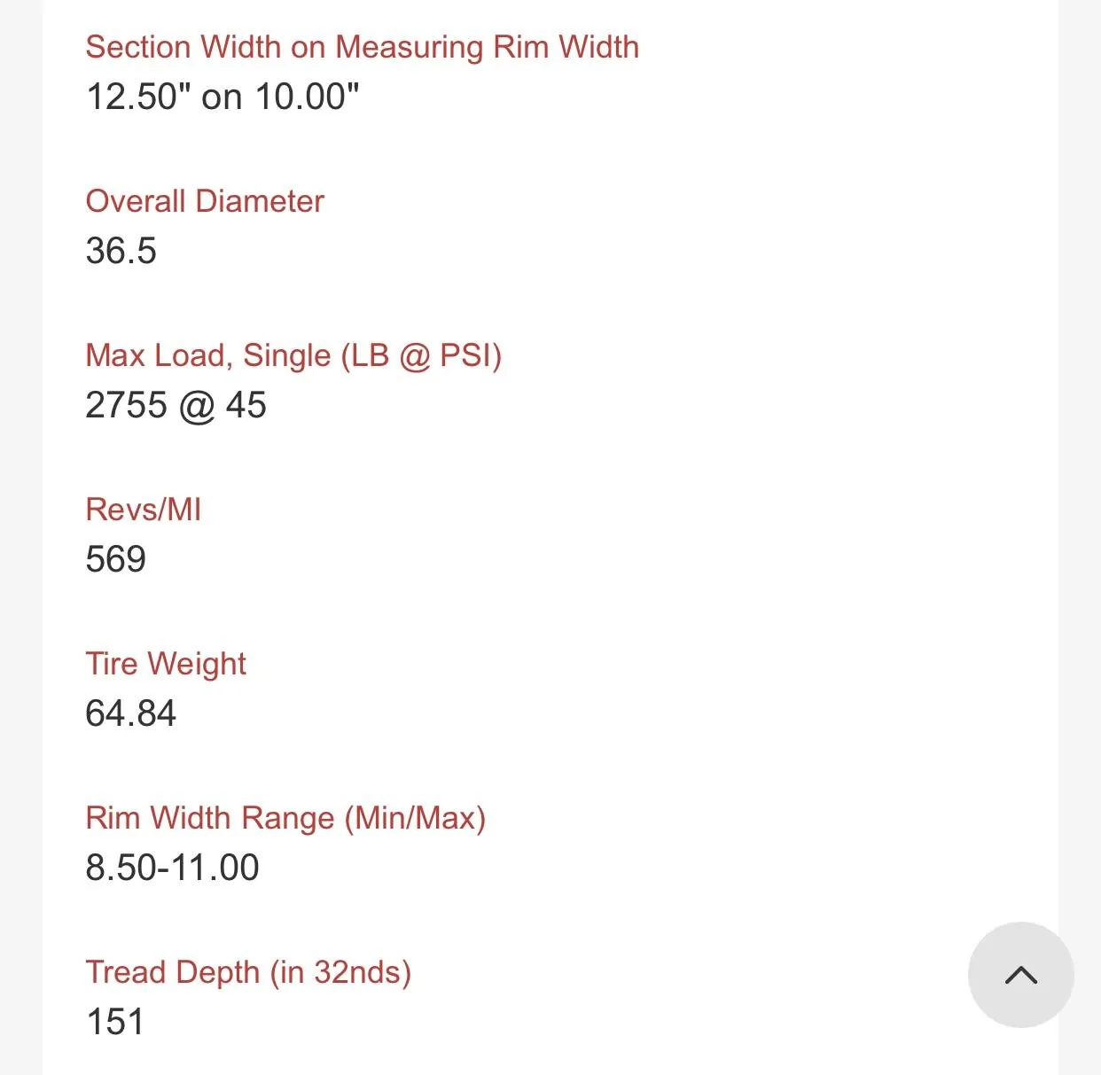

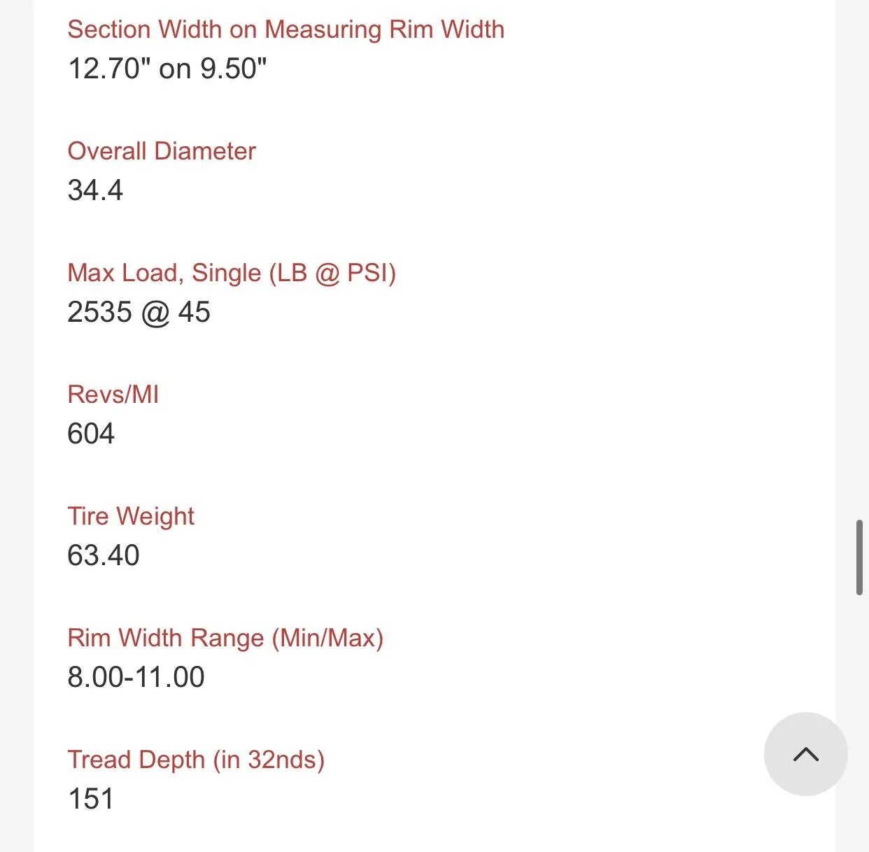

Screenshots from BFG’s website:
Jeep Wrangler JL Regret 37s? 5276E754-56FF-4A3B-BFF7-55E3259B6FBA
^ 315/70R17 Load Range C ^
Jeep Wrangler JL Regret 37s? A4FBA4E9-23A2-407C-AA87-D196FF95D461
^ 37x12.50x17 Load Range C ^
Only 1.44 pounds heavier. I’m not sure how accurate that actually is and if it is, how they managed that.

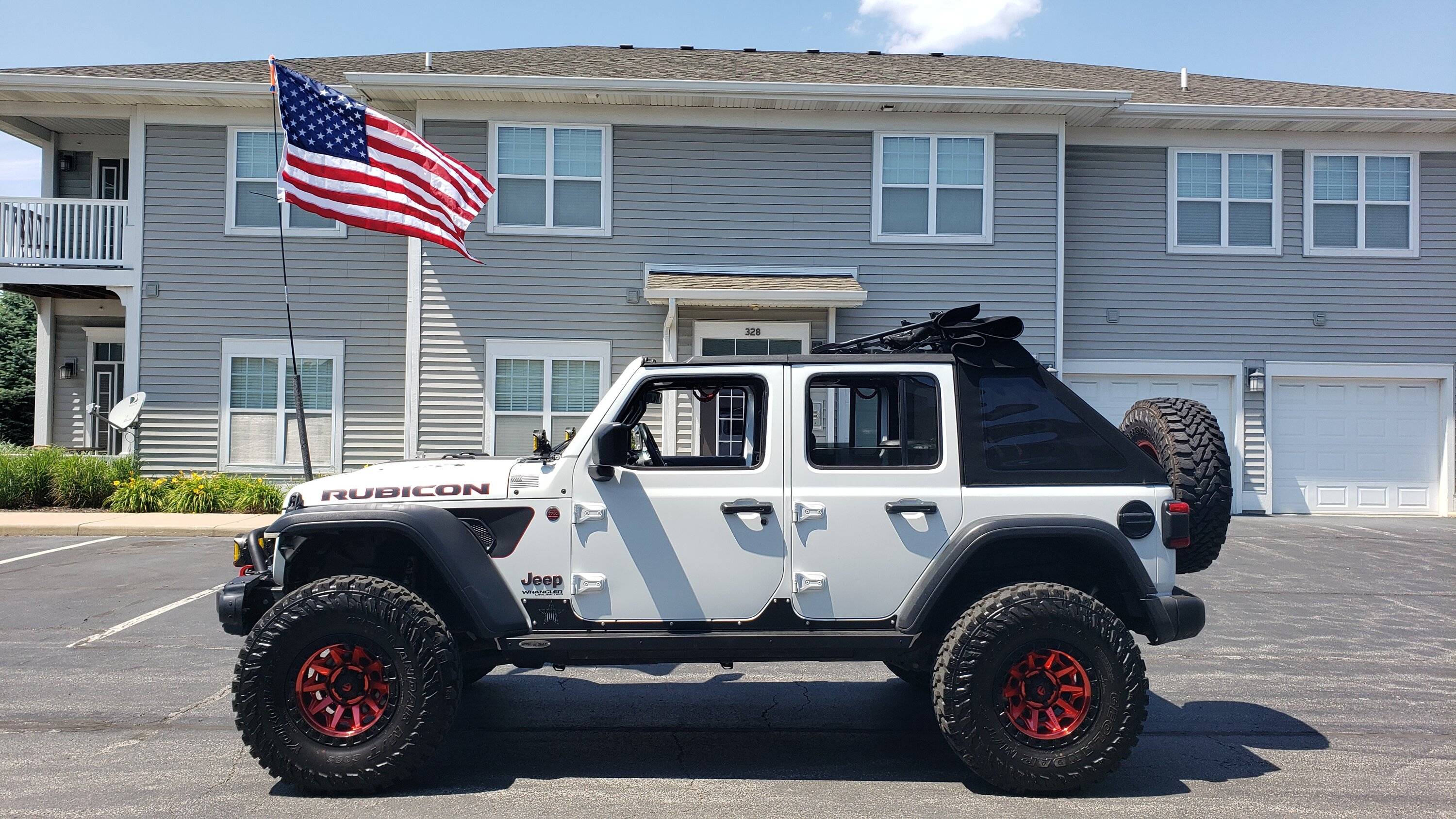

I'm seeing people with Mopar lifts and 37's, with the rear axle perfectly centered in the wheel well. Mine seems to be too far forward. Are people adding different control arms and just not mentioning it, or did I do something wrong? I seems like there is no way to get it centered without longer arms.

I told my installer to lengthen the rear lowers 1/2'' over stock.. He kinda argued with me and finally said he would lengthen them 1/4'' over stock. My rear wheels look pretty centered with the 37's. I also have an adjustable trackbar and have my rear centered laterally. If you don't adjust your axle center that could be a problem as well.
What's the passenger side look like?
That def does not look right. Did you tighten the control arms to spec while the Jeep was up on a jack or jackstands? If you did that's the problem. You need to have everything loose (upper and lower front and rear bolts) with the Jeep sitting on level ground THEN tighten everything to spec. If you tighten them while up in the air you will get a "false lift" and I believe what you are seeing with your axle.

This is good advice but I'm not sure that should make too too much of a difference on wheel/axle position - the Mopar lift uses all stock control ams in the rear so the more lift you get the closer the wheel moves to the front of the vehicle. In the scenario where they're torqued too tightly while on a lift it'll create binding but I don't know if it'll create so much binding that the weight of the vehicle won't overcome it. I would highly recommend getting a set of adjustable control arms from Metalcloak or something to bring it back into spec. I just did so and my wheel moved to the center of the wheel well in the rear.

Passenger side is the same. I do have adjustable trackbars to install, but I can't see how that will help front to back.
Thanks mgroeger. I will try what you said, but I'm thinking that I will need to look at some adjustable control arms as jessedacri suggested.

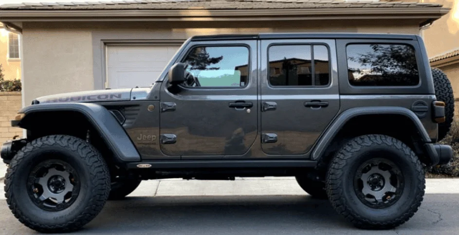

Something looks off. This is the JL I had with 37s and the Mopar lift for comparison:
