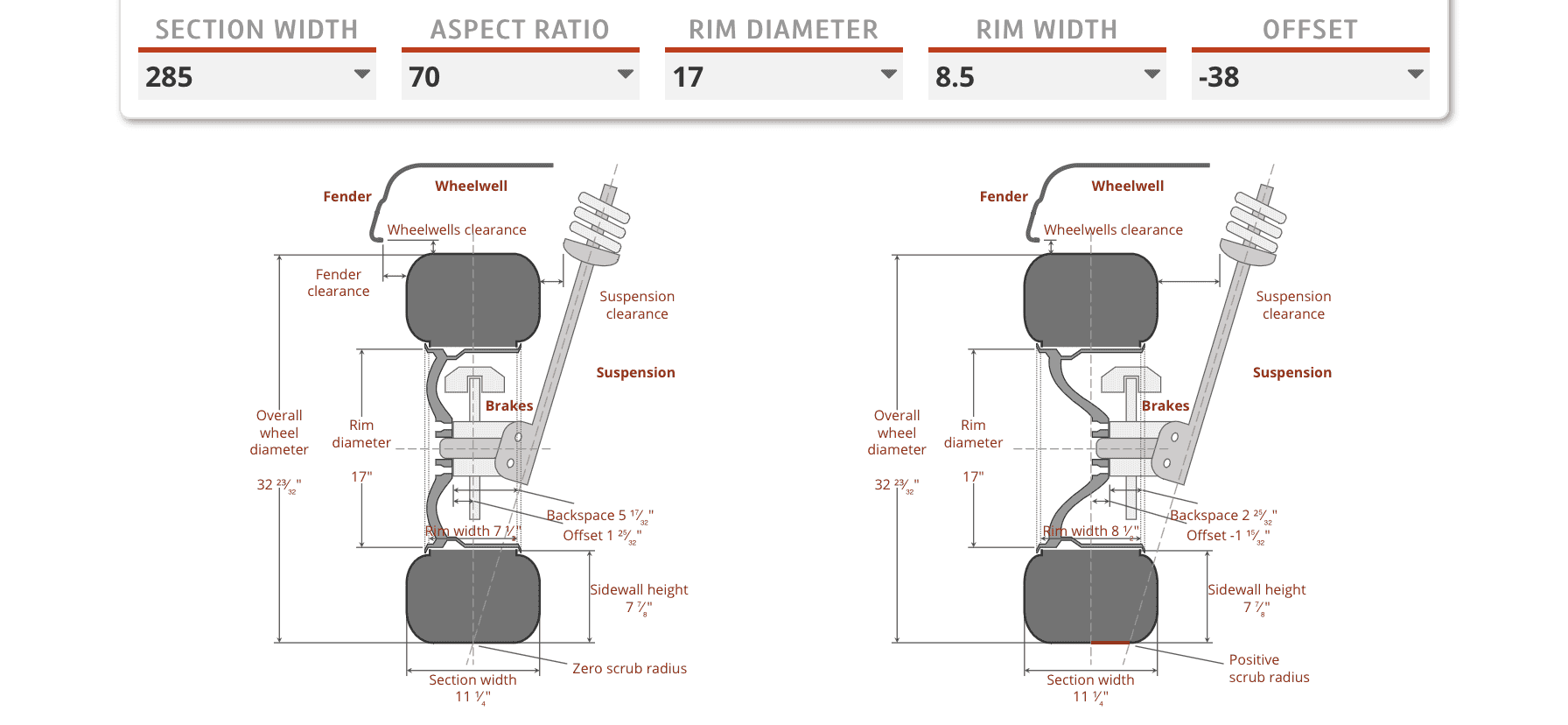

you may want to play around with this tool:
https://www.wheel-size.com/calc/?wh...17X8.5ET-38&wcl=1.25in&fcl=2in&scl=2in&sr=0in
I plugged in stock (not shown) vs same tire size on an 8.5” wide wheel with your -38mm offset
The fender isn’t positioned correctly even for stock but with that combination of numbers it looks like it moves outwards about 3.5”
Will it look good comes down to what look are you after.

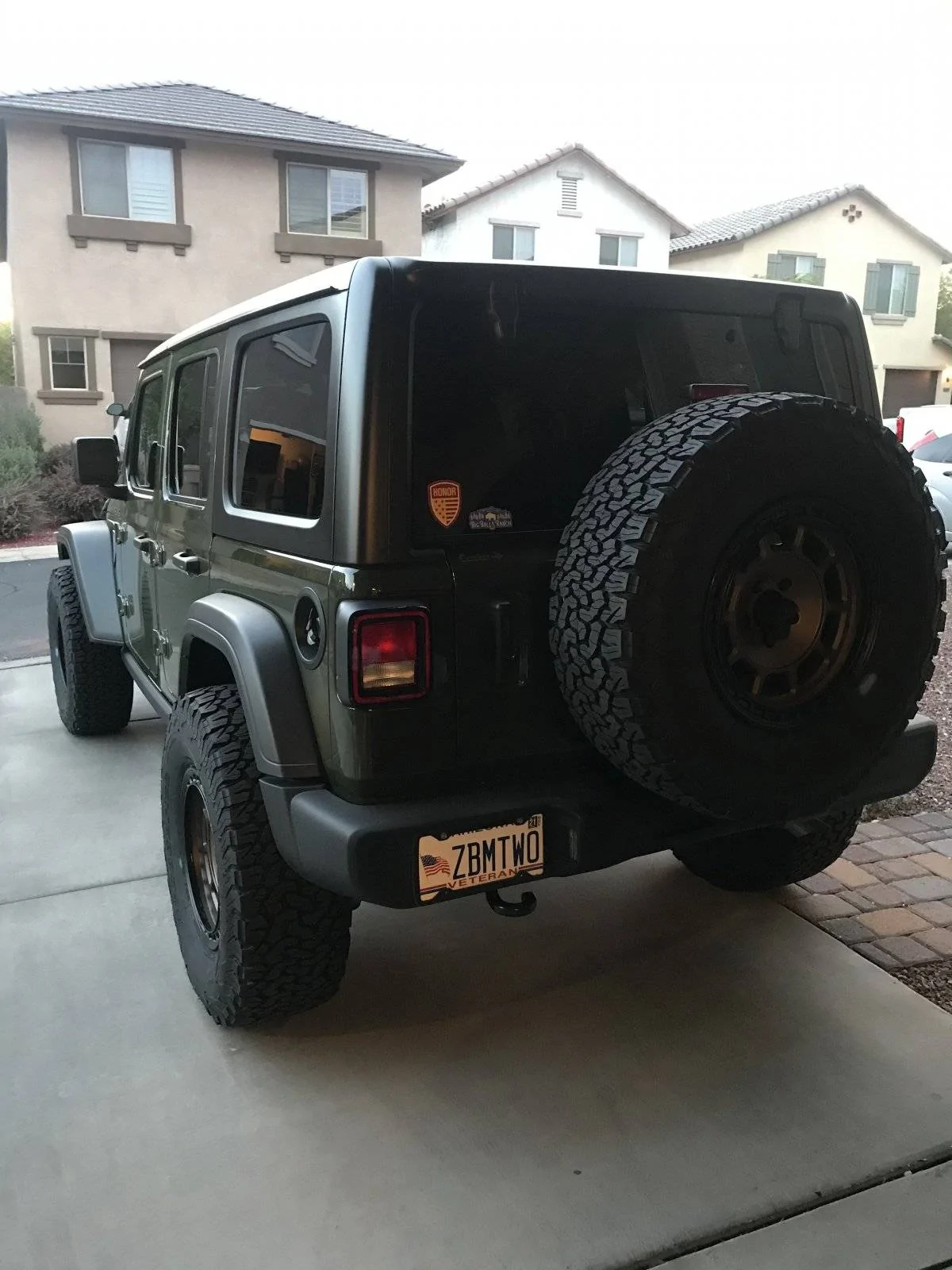

With a 0 mine stock out a good ways so I’m betting you add some to that and you’ll be out there

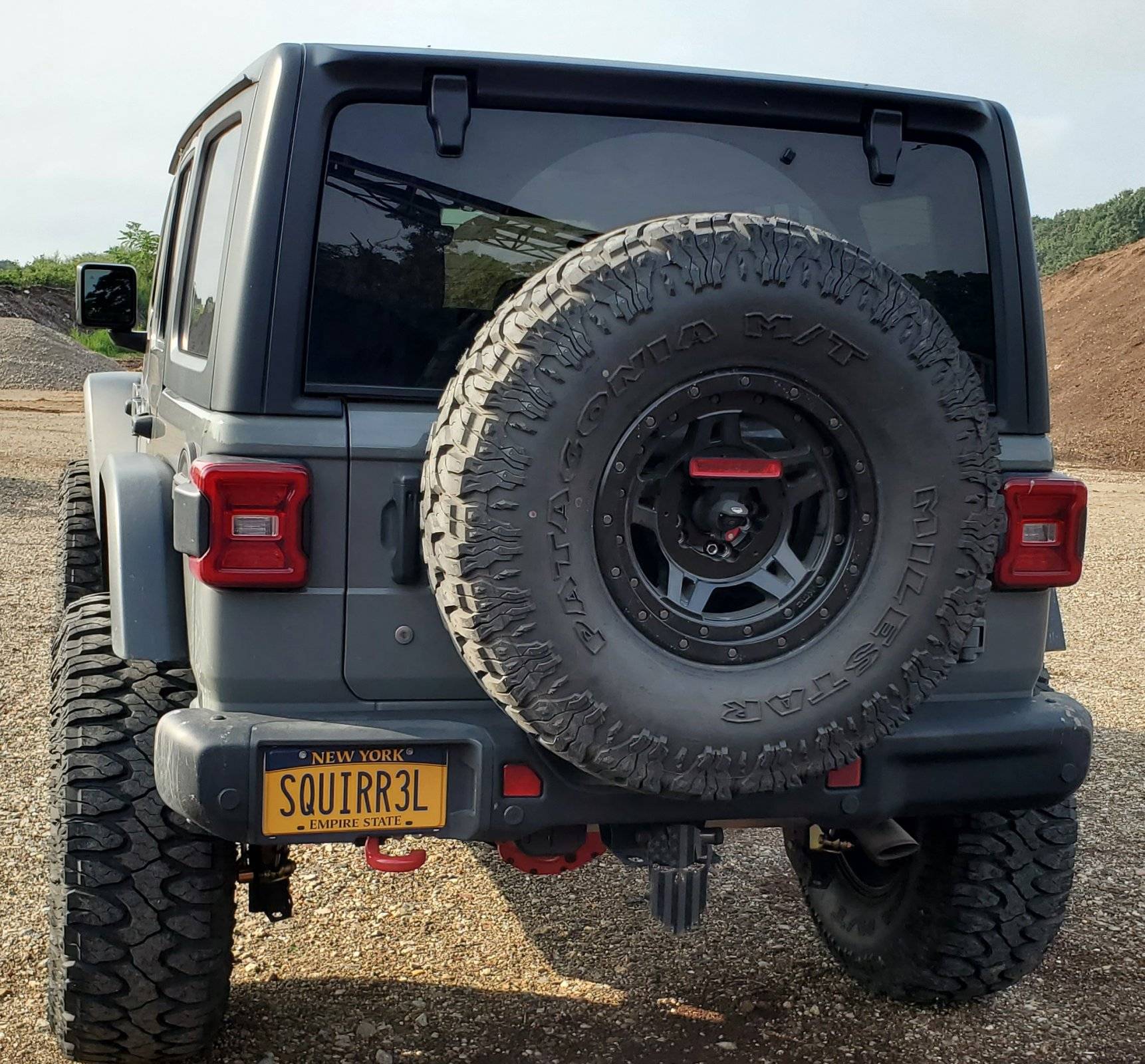

Here's a 17x9 with -12mm offset wrapped in 38x13.5's. I also chopped all fenders and have high tuck aluminum fender liners. At full stuff, the top of the tire lightly contacts the upper portion of the liner, while leaving room to spare under the fender itself.
