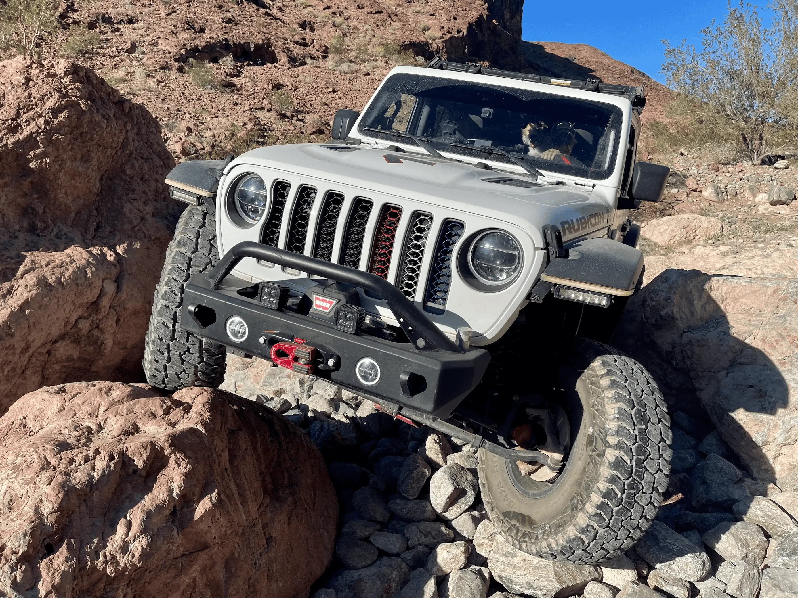

Here's a pic of the lift after I installed it with Baja Boss M/Ts (it's a bit too clean in the photo):

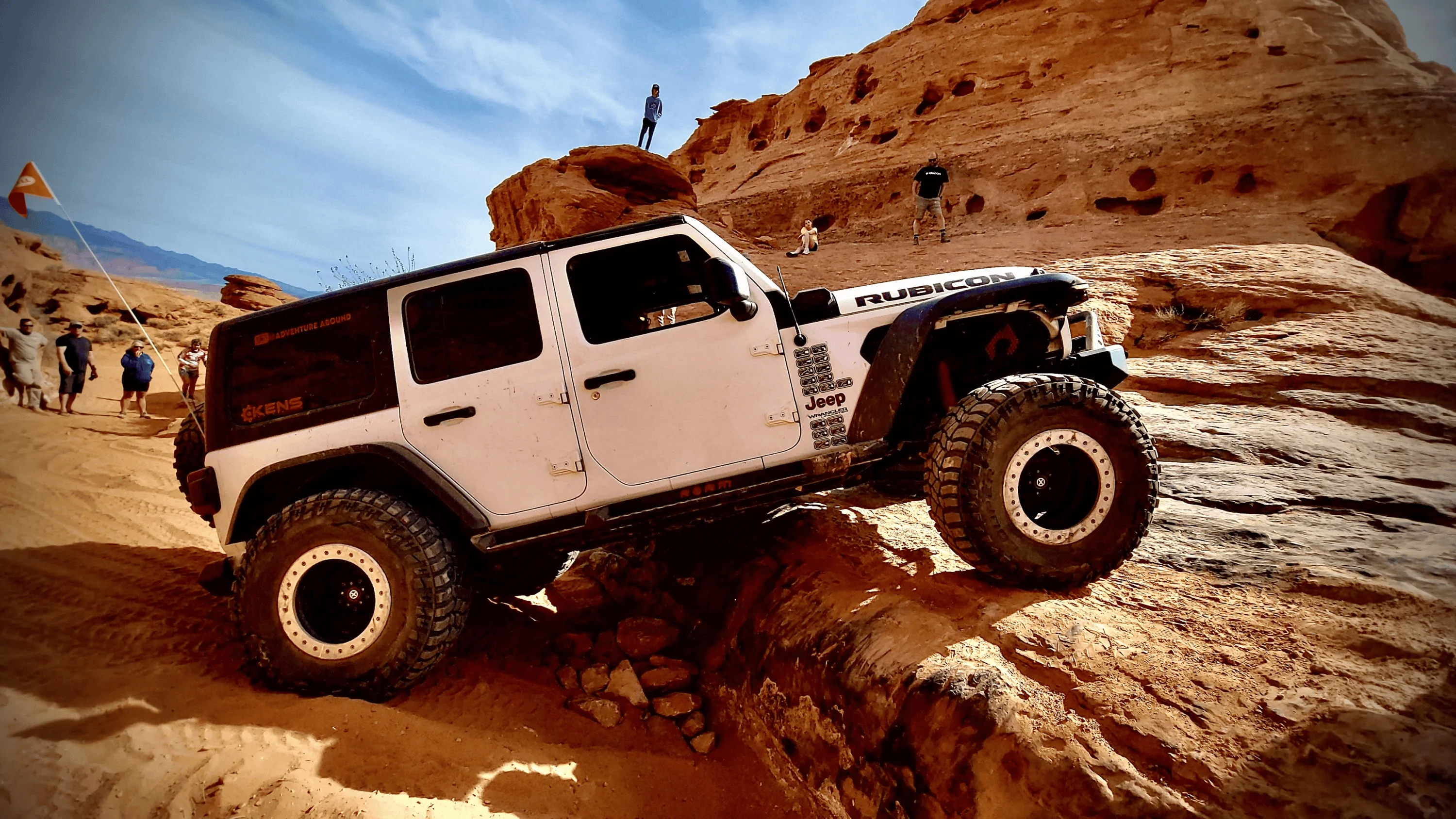

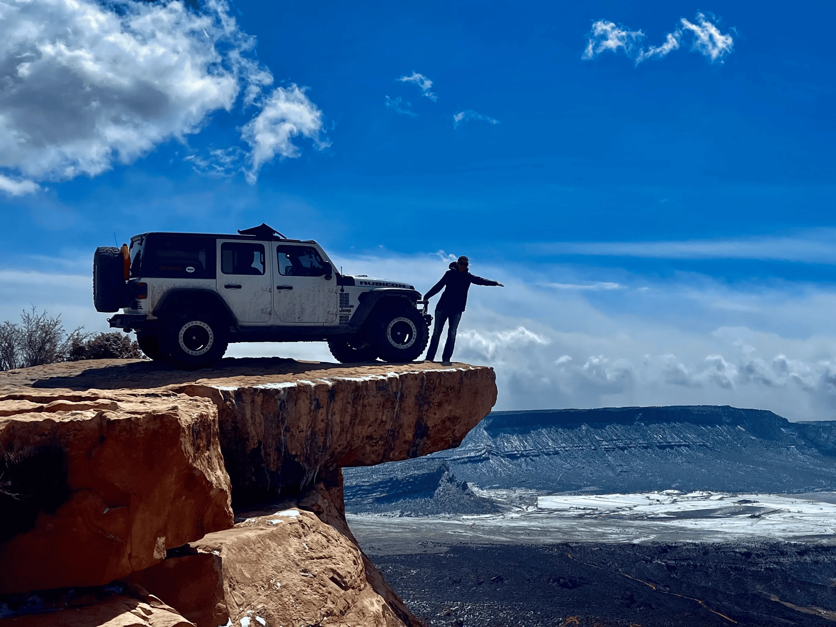

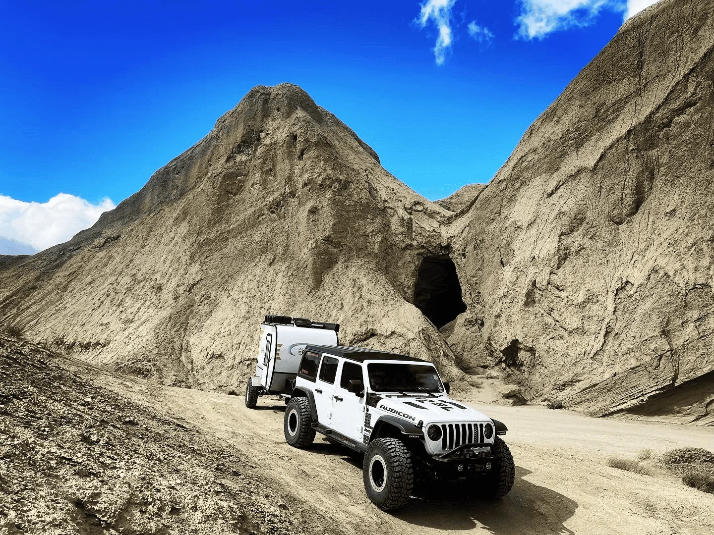

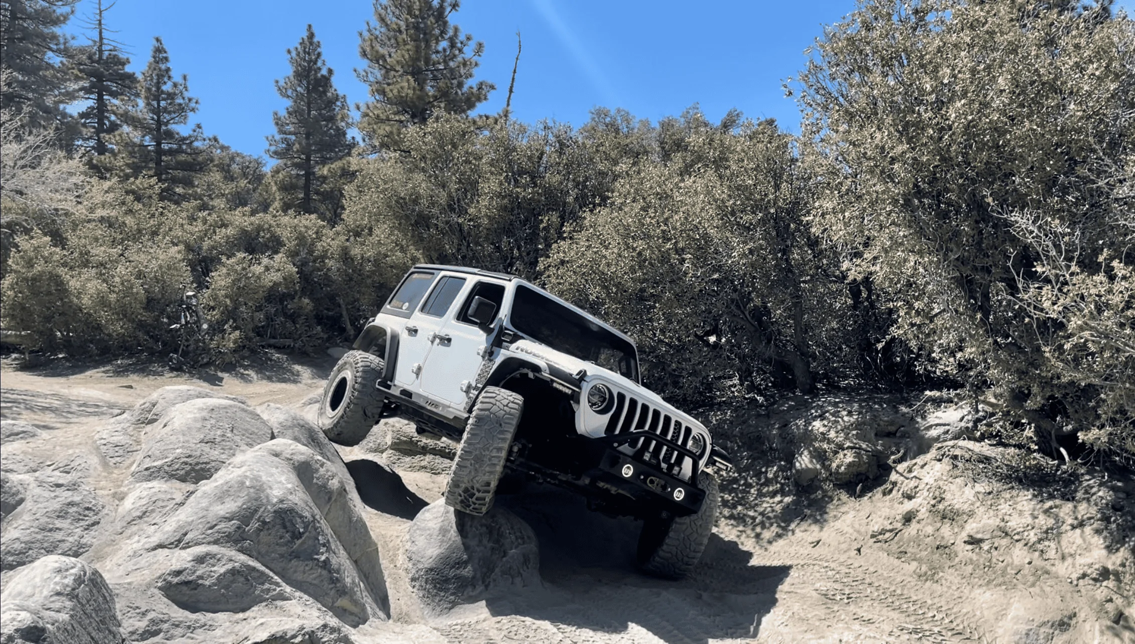

All of those things for sure. I figured that going to 37s on my cost me the following.
$4500 for my wheels and tires
$800 for the Rancho lift
$1600 for the upgraded steering components
$900 for my spare tire carrier
$660 for the Dynatrac ball joints.
$2200 for gears and install. Note I did all the other installs. Also Note, I work cheap for myself. I charge my self a decent steak and a good shot of bourbon at the end of the day.
Some might say that is a bunch of money, yet the memories and view are priceless.

Like has has your wife ever hung over the edge of a 1000 foot cliff by the front bumper of your Jeep kind of memory.
Jeep Wrangler JL 37s & Regrets? 1702122883697
Jeep Wrangler JL 37s & Regrets? 1702122914080
Notice my bud stacking rocks at the passenger rear corner. My wife almost flipped the Jeep over backwards right here.
Jeep Wrangler JL 37s & Regrets? 1702122998986
Jeep Wrangler JL 37s & Regrets? 1702123066260
One does not create memories like this sitting on the couch watching Family Feud. Lift the Jeep buy the tires spend the money and go wheeling. There is so much to see in the is country.
