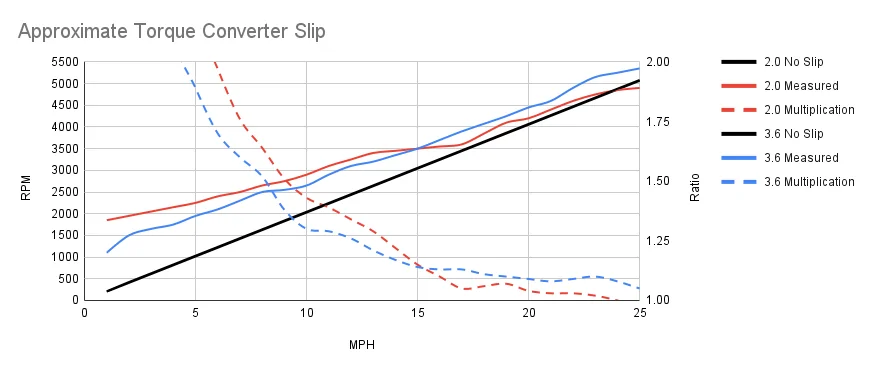

I'm amused how the 2.0 can simultaneously "take too long to spool" and "get poor mileage because it's always in boost".
I looked into torque converter slip a few weeks ago and noticed the 2.0 has a definite ratio change at 3500 RPM (WOT), and almost locks the converter. I'm thinking that the majority of spooling happens by this point when going WOT from a stop. At speed with a load will spool at a lower RPM, probably around 2500 as shown by the dyno charts
Something interesting came up in this dumpster fire thread: Going off of this video at 14:47 at 0.25 playback speed, I recorded the RPM vs. speed, and was able to approximate torque converter slip. The 2.0 seems to slip the torque converter less starting at about 3500 RPM, while the 3.6 keeps slip at a somewhat steadily diminishing rate.
Don't take this is accurate, a true datalog will likely get better results.
