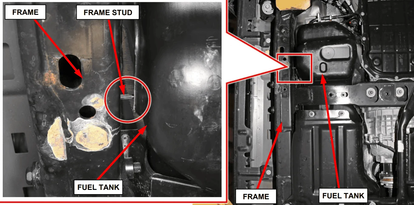

Re-posting this in the 2-door forum: https://www.jlwranglerforums.com/forum/threads/equipment-safety-recall-29a-–-frame-stud-campaign-for-2-door-jl-body-style-jl72.111648/
"Some of the above frames may have been built with an unnecessary and unused frame stud. When installed in a vehicle, the frame stud may contact the fuel tank in a crash, which, in certain circumstances, can cause a fuel leak. A fuel leak in the presence of a competent ignition source may result in a fire, increasing the risk of occupant injury and/or injury to persons outside the vehicle."

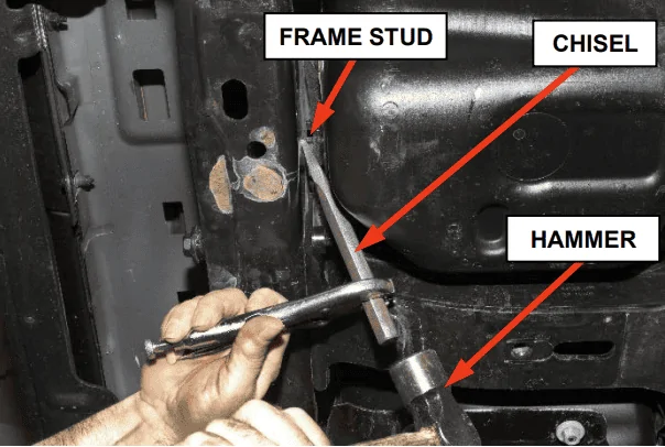

Don't forget that removing it requires you to hold your chisel with a pair of vise grips while you have someone else hold your Coors Light:
Amateur. I am taking mine off with a plasma cutter, far easier.
Make sure to hold it with some woodworking clamps or the recall won't actually be complete.

Received the notice yesterday morning and an hour later, the job was complete.
I used a 3-lb hammer and a cold chisel to chop the stud off. It's too tight an area to risk using the plasma cutter.
The Factory PFD listed above has all the info needed.

Where does one obtain information about their chassis' prefix?
The original thread (link above) has the official recall notice that tells you where, and what to look for. (Sticker on the left outside frame rail just behind the door hinge).
