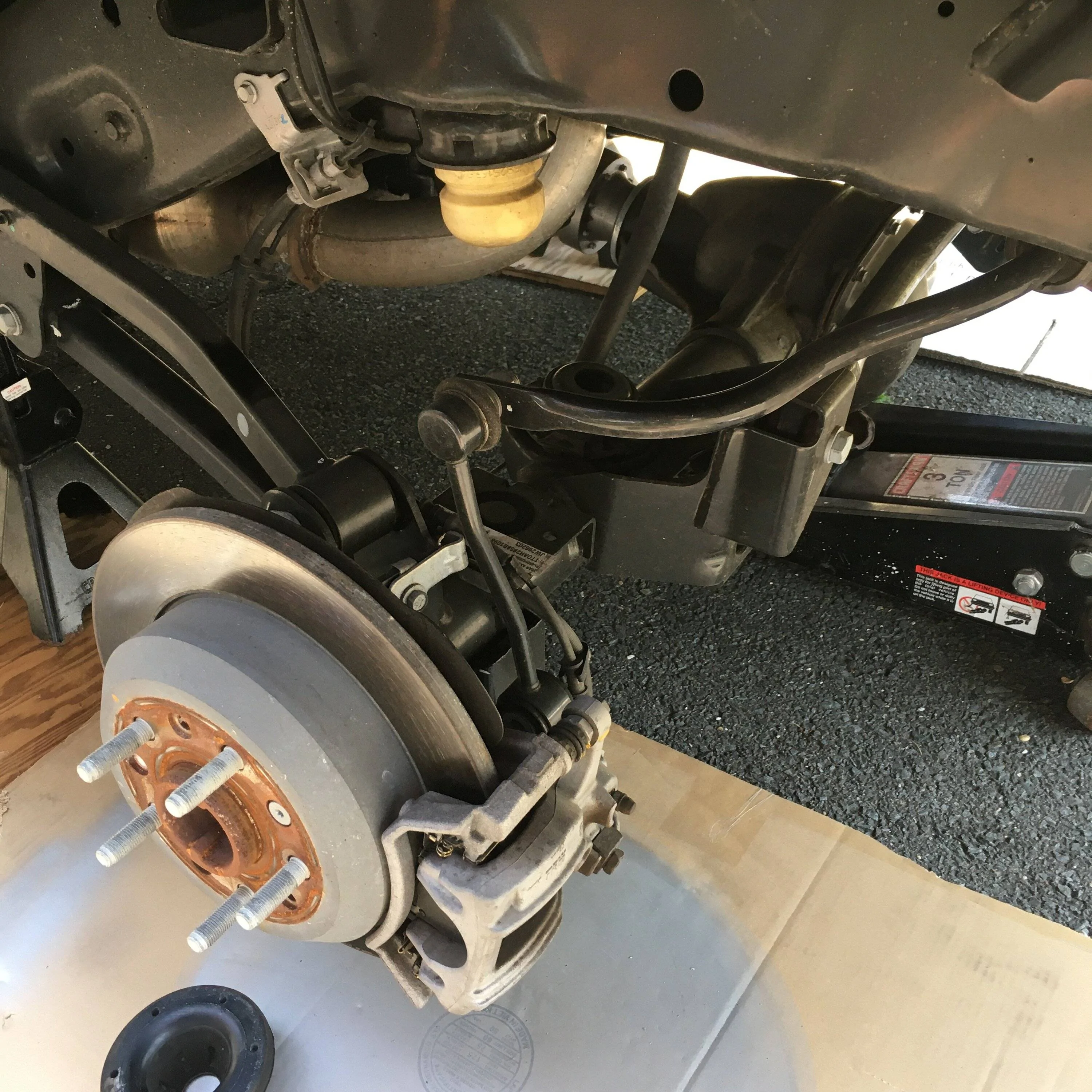

I think we put them on the frame just in front of the LCA mounts. By this point we had the Rubi springs/shocks and front tires on. Don't forget to chock the front wheels too.
