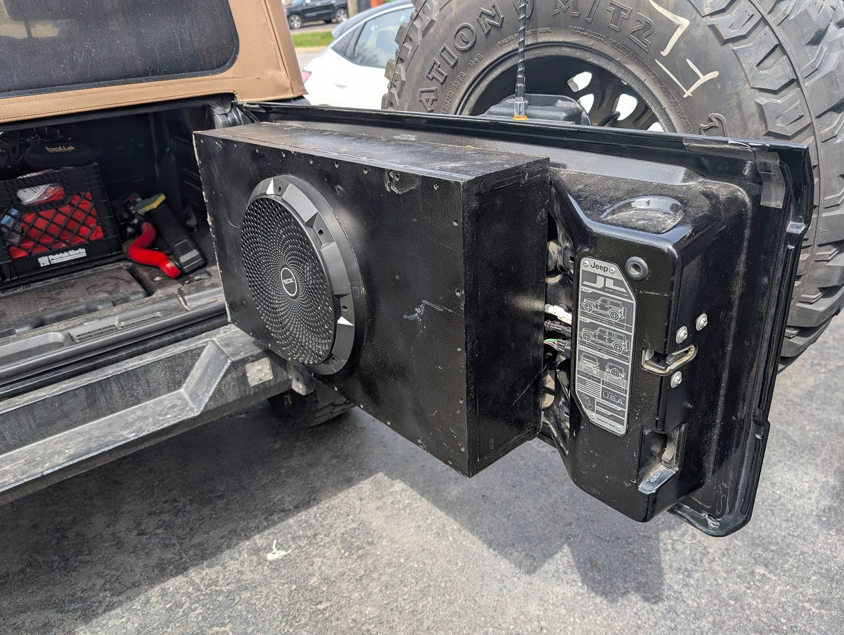

I’m trying to find an under seat subwoofer/amp for Stacy. I ride with the back windows out year round and I take on water since I live in Florida. I haven’t been about to find anything that will fit under the seat and won’t be destroyed within 6 months. Any suggestions (other than put my windows in)?
I've made a sealed box for the tailgate, kinda inspired by the stinger tailgate box (there's no way I'm paying 800+$ for a speaker box). I already had an old 12" shallow mount Kicker. And under the passenger seat I have a big powerfull 5 channel amp with a audio control lc6i converter to keep the stock radio.
I also swapped the kickpanel speaker for 6.5" speaker and 6x9 in the sound bar. I also sound proofed the soundbar and the kickpanel speaker box. I have good deep punchy bass and clear mids and high. All this was kinda budget friendly. In the future I might ditch the 12" sub and swap the kickpanel 6.5" speaker for two 6.5" subwoofer.
If you are interested, here's my measure I've come up for the tailgate box:
Exterior size is 29x16x6
With 3/4" mdf, theses are the pieces I needed:
2x 29x16
2x 29x4.5
2x 14.5x4.5
I don't have pictures tho. But it turned out pretty great and I don't really loses space.
