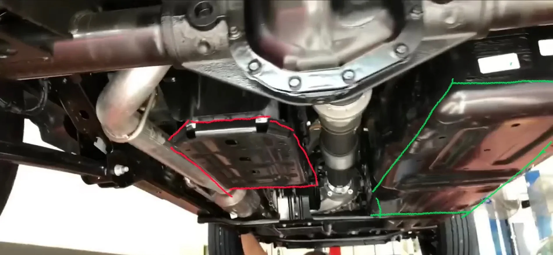

You likely have the e-torque check underneath for a 2nd skid plate on the driver side in red here, the fuel tank is in green

That said the 2nd motor cycle battery is hidden in the fender well under the main battery, pretty sure you have to remove the fuse box to see the opening for it, or pull the fender liner.

Area under main Battery is open, no battery. I checked with the dealer mechanic and service writer ( who is in our Jeep Club and drives a Jeep) and they both said there is no 2nd battery. I don't have a lift so I cannot check to see if there is any cables coming from the metal enclosure opposite of the gas tank.

So in the picture I posted there will be a 2nd skid under the jeep and thats a 48v battery that helps with things.
