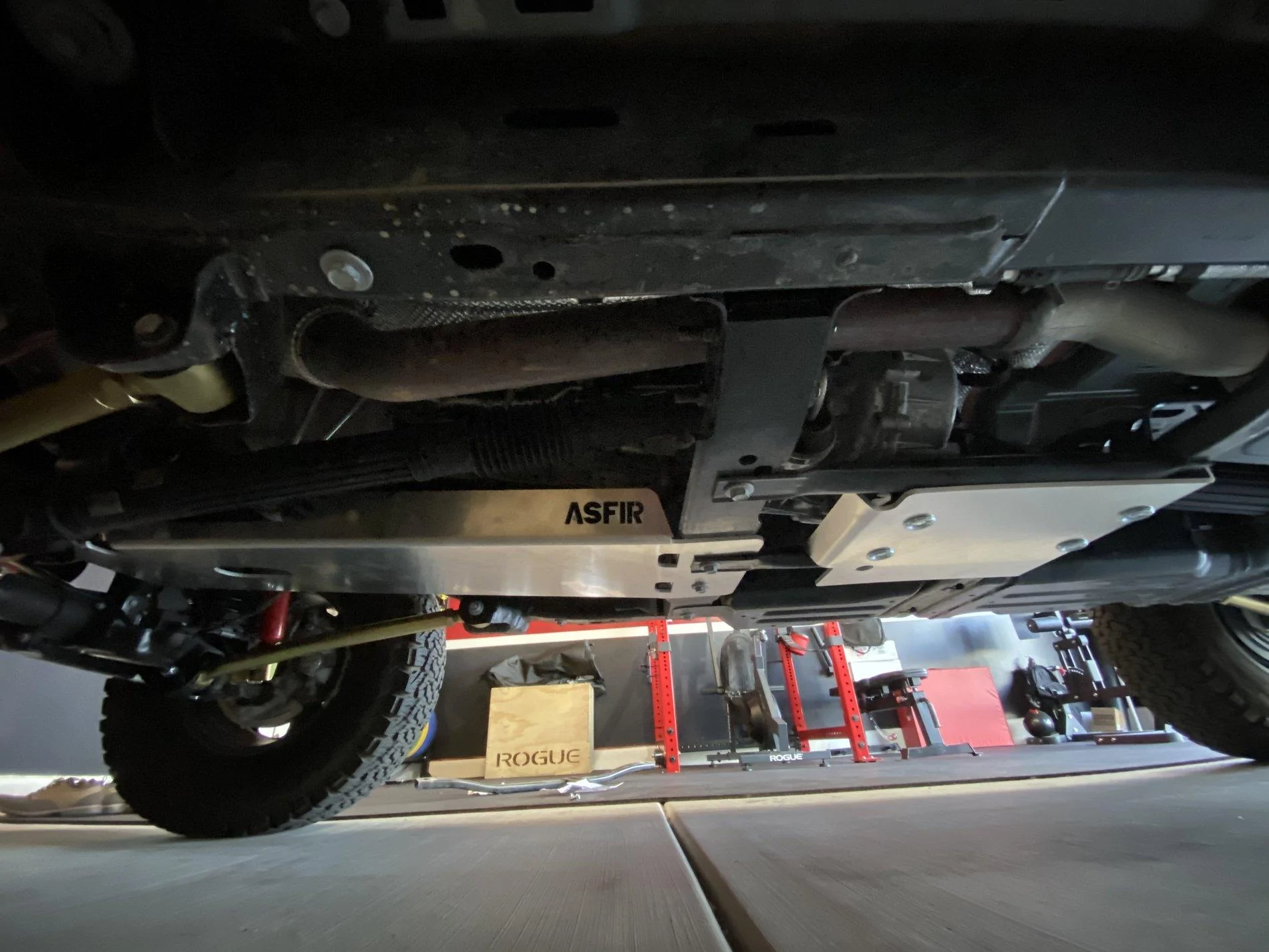

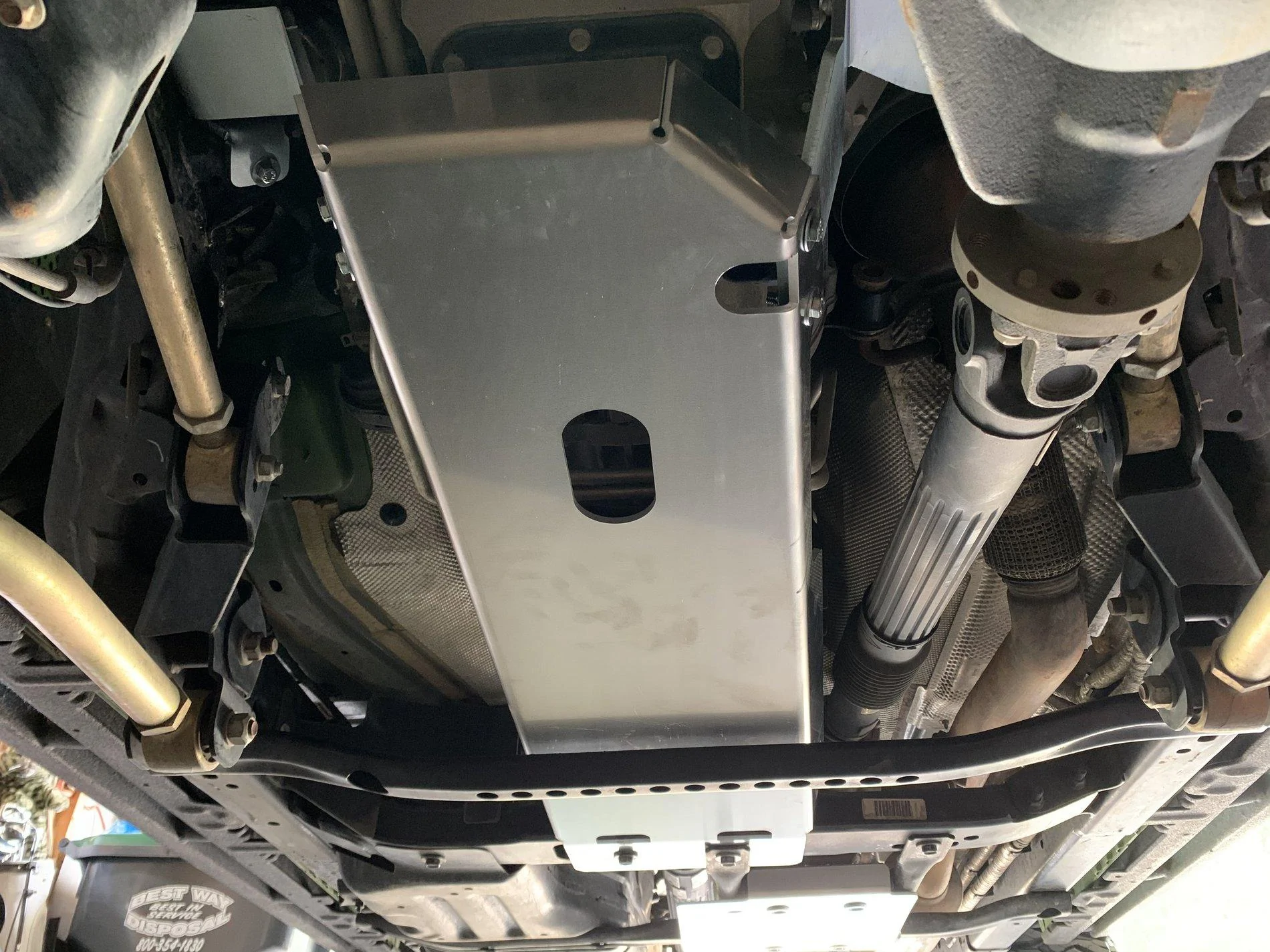

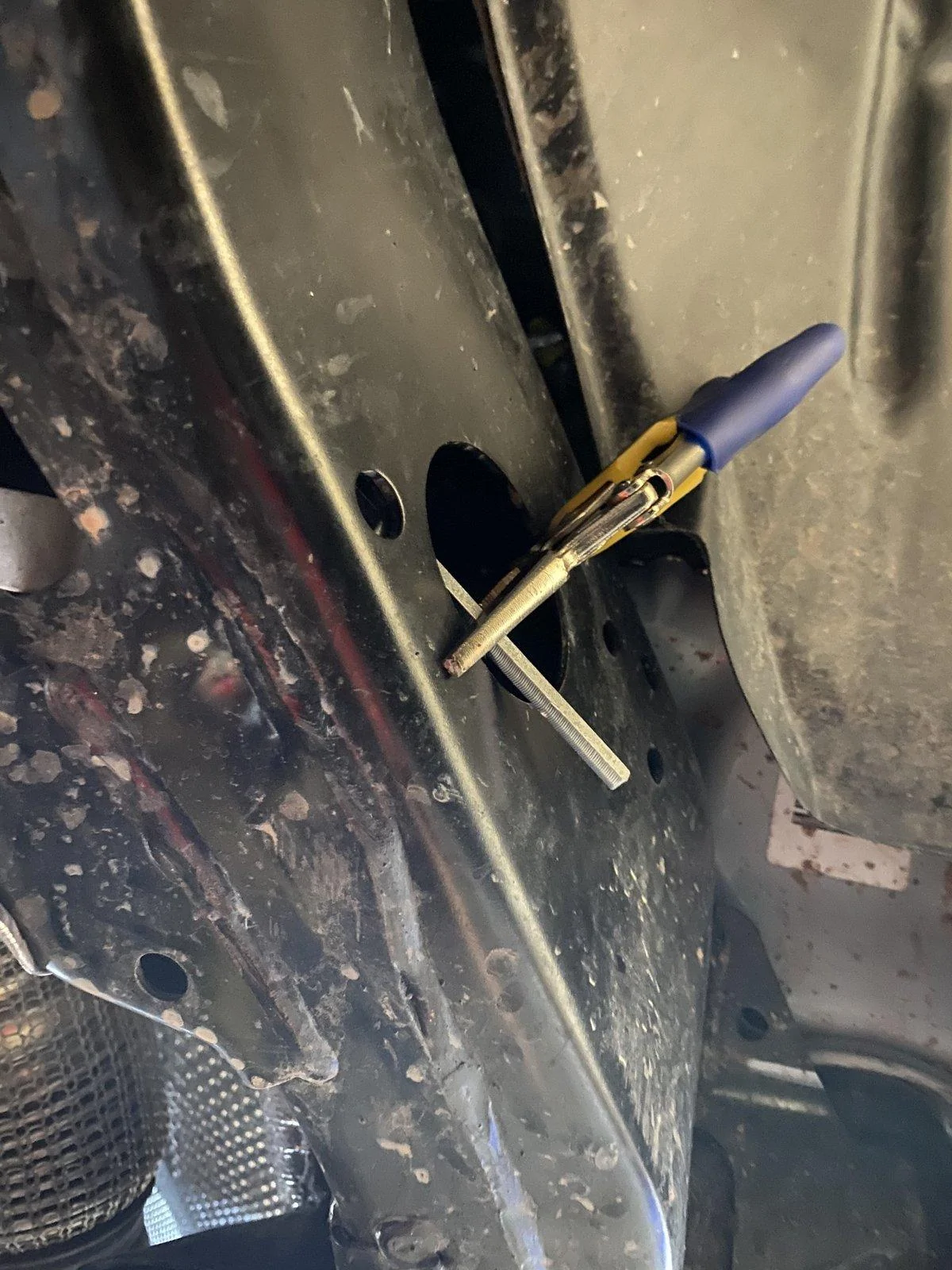

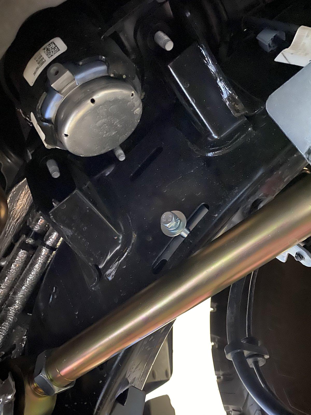

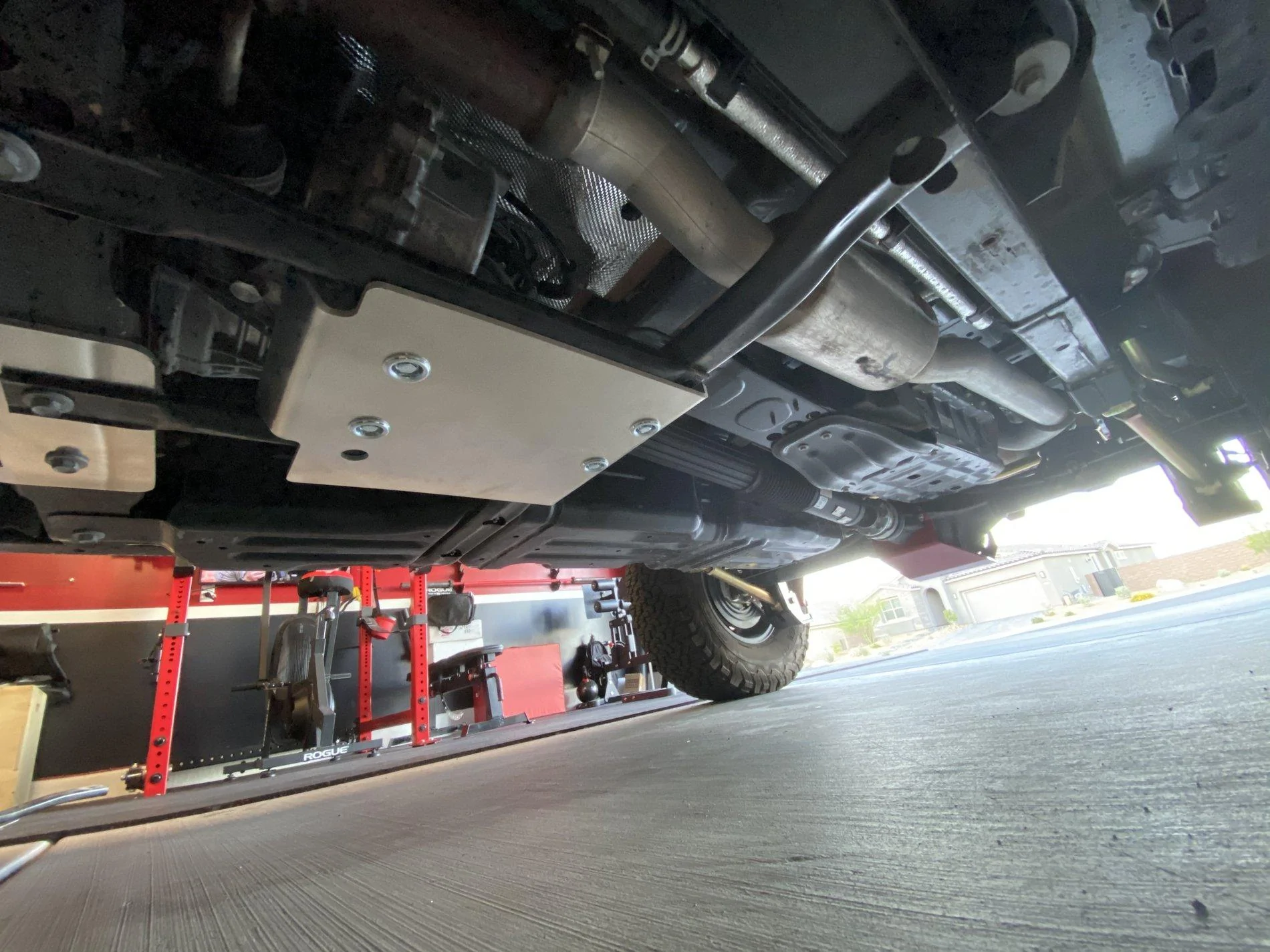

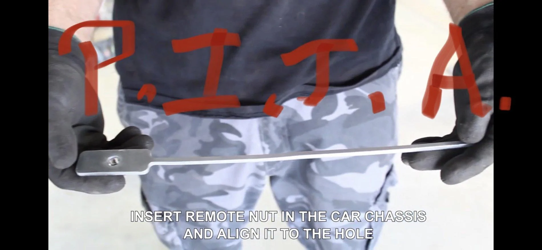

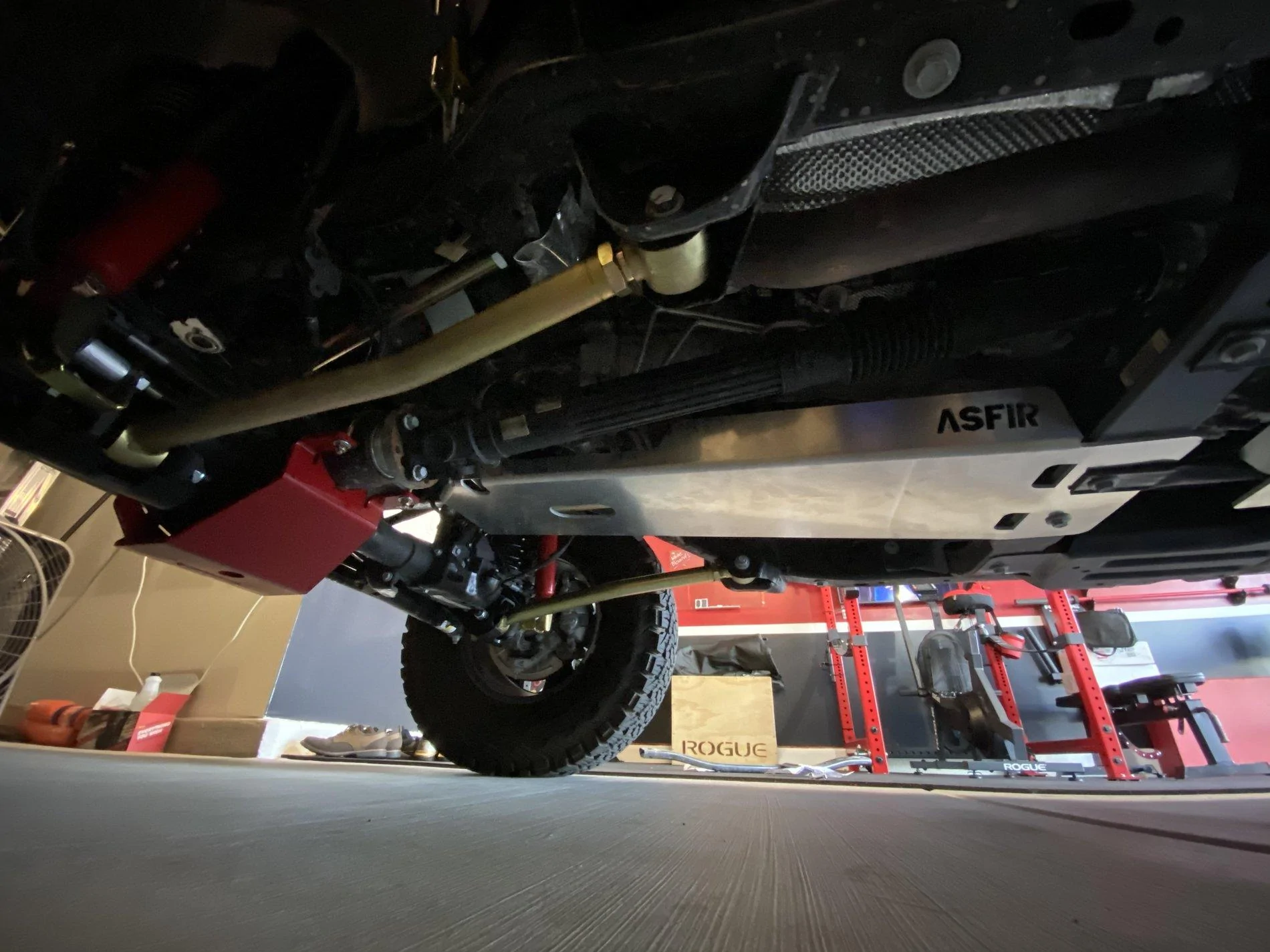

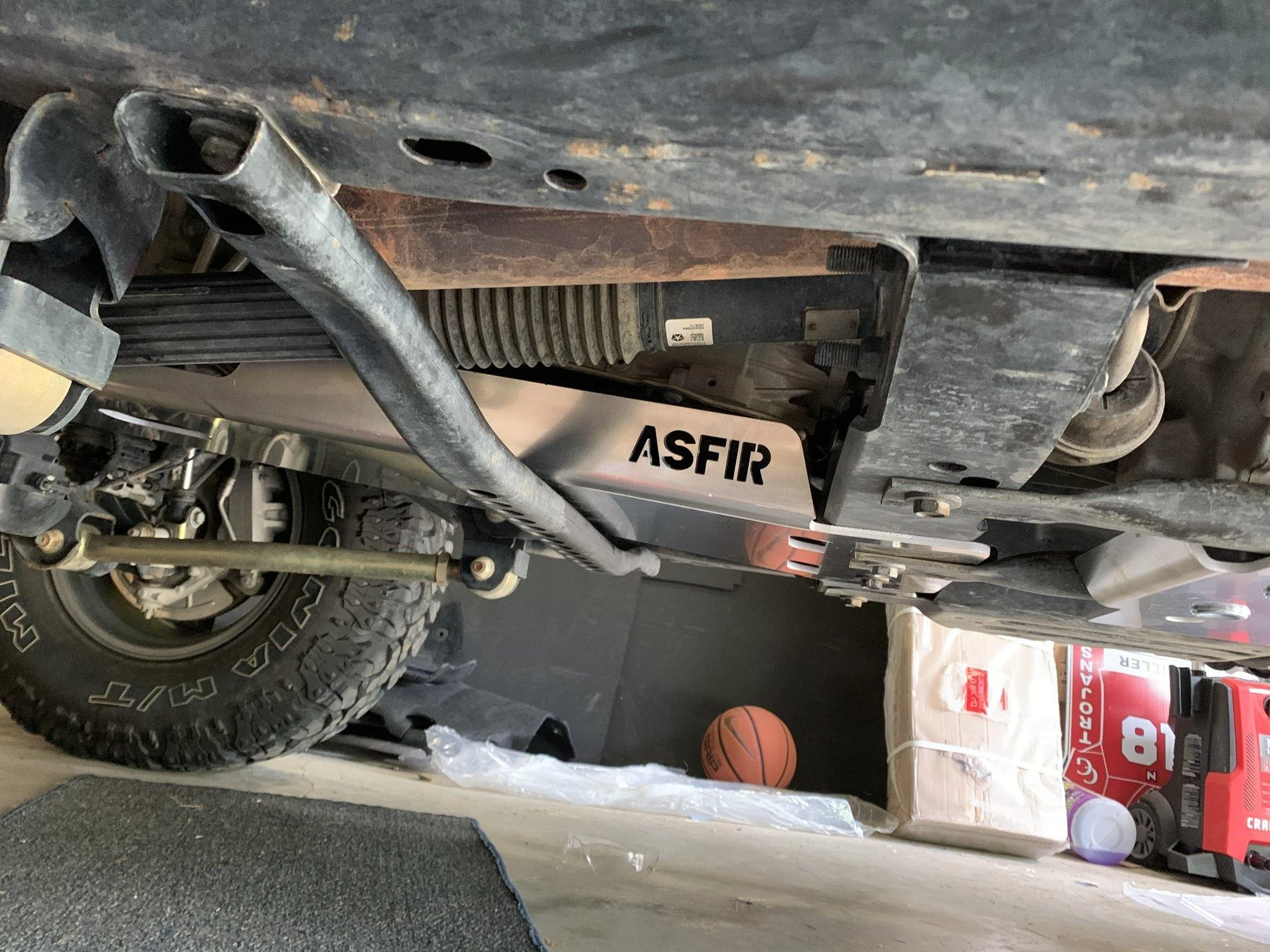

I finally got the asfir engine and transfer skid and I can confirm the transfer case skid ABSOLUTELY FITS a 2020 4 door automatic 2.0 turbo with etorque wrangler. Watching the videos made install easy. Took me about an hour laying on my back in the garage. The hardest part was trying to get the bolt into the “remote nut” bar Once it’s inside the frame. The way I got it in was insert it in the frame then screw bolt in. Once the bolt is in use some locking pliers to clamp the end of the remote nut bar to the frame (where you insert it in the hole in the frame) so it’s held in place. Then unscrew bolt, fit metal bar over the hole and put bolt back in. I included pics below.

I've been wondering, is the transfer case skid plate really needed as much as the engine/transmission skid plate? Or is it just another level of extra protection?
probably not needed as it just covers up the oem skid But it is bigger than oem.

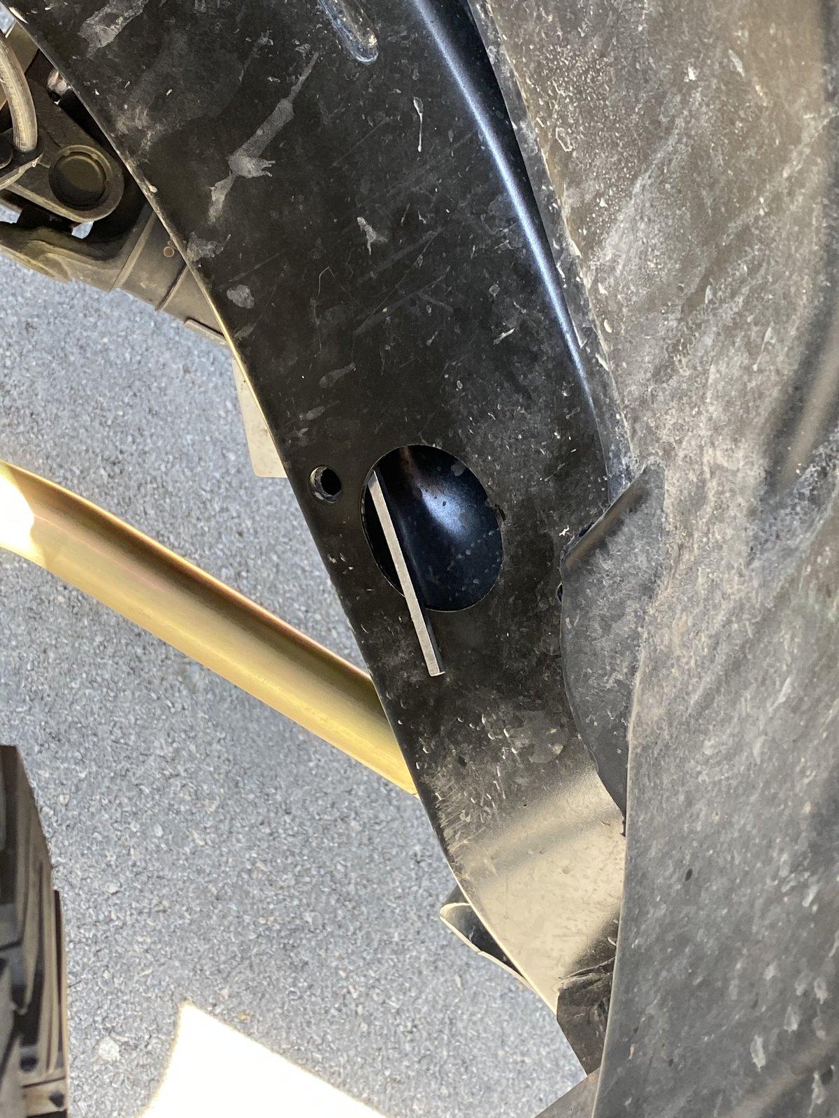

What do you guys do with the metal rod that sticks out after you install the engine skid?
It's fairly easy to bend. I just bent mine, stuck it in the frame, and then unbent it enough that it should stay in there. Figured that way there was nothing sharp or pointy sticking out.
I cheated.
I put the bolt on the end of the “stick” and pushed that through then threaded the nut on. Much easier.
