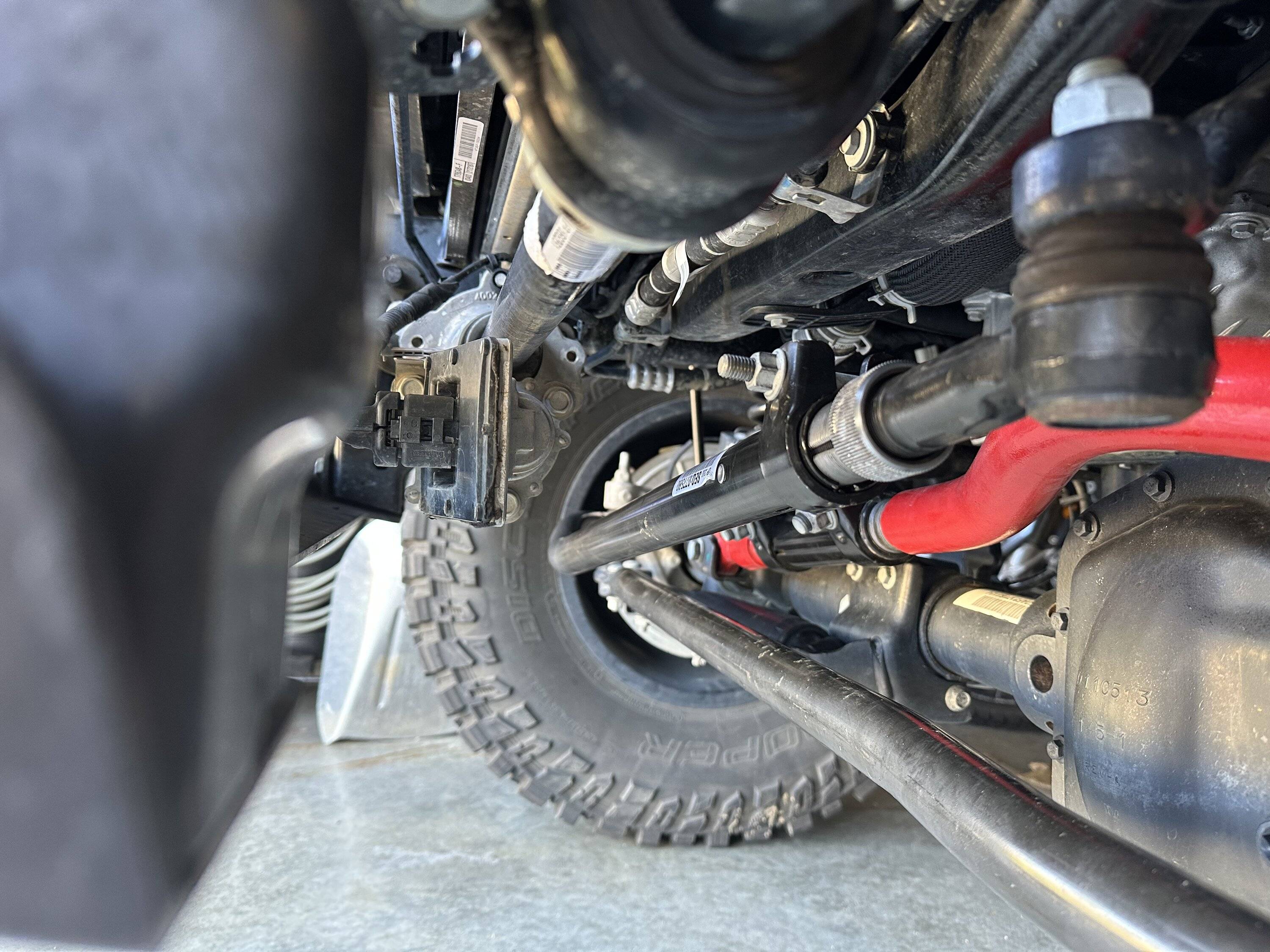

Got a photo of the Drag Link? Something seems way off there with only 2.5" of lift.

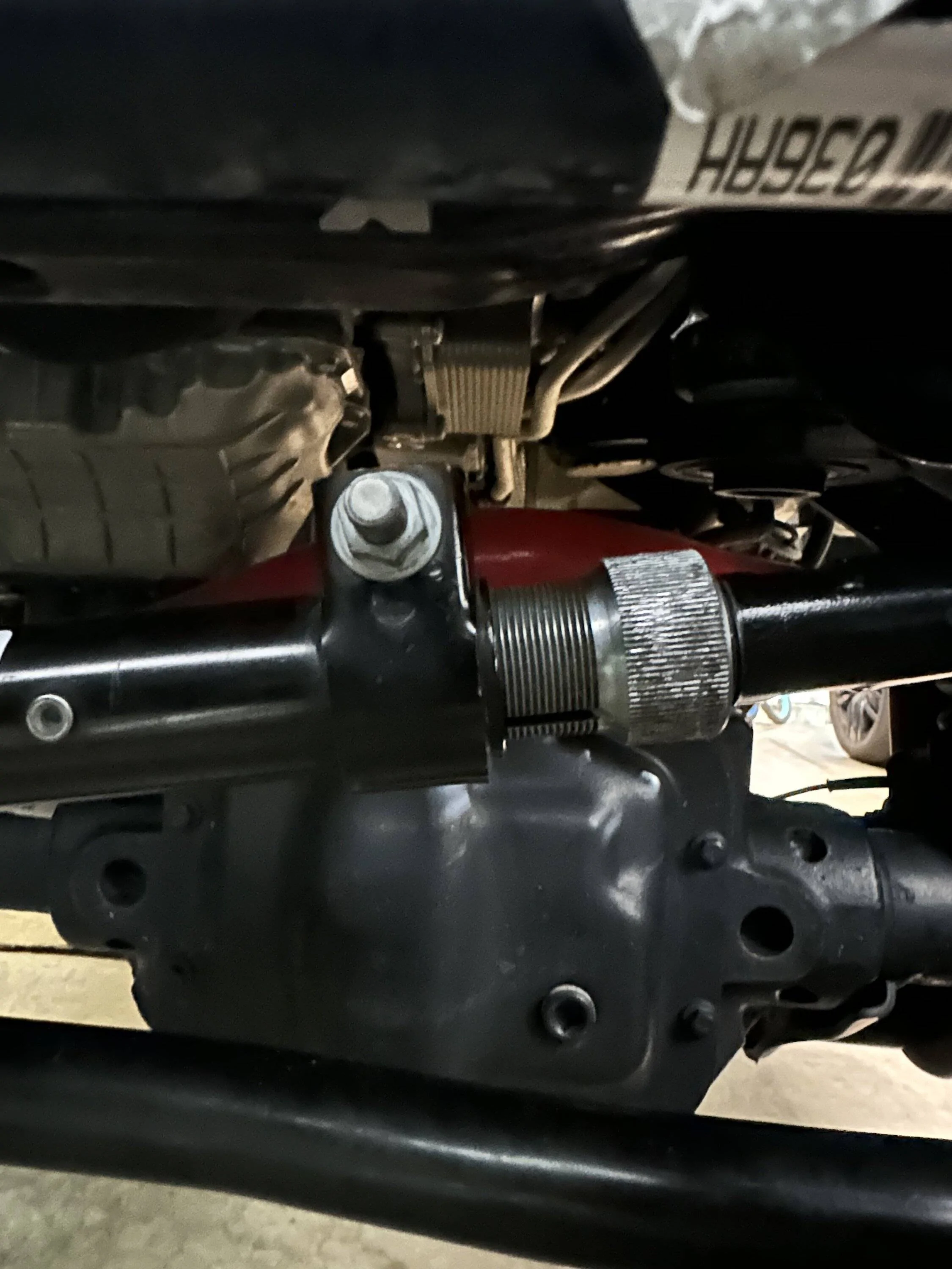

I attached a couple photos of the drag link. It’s just the stock one, but I agree is the strangest part of this.

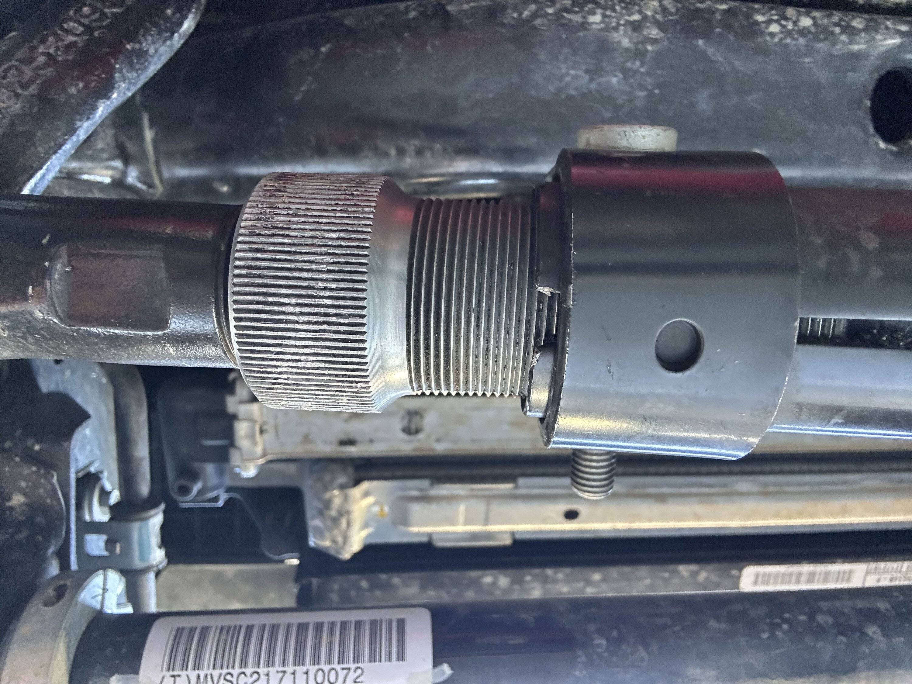

I just tried going the opposite direction and the adjuster got too long and the drag link was loose at the adjuster.
Edit: the attached photo shows where the adjuster is right now. I cannot turn the adjuster toward the front of the Jeep any further, which is the direction it needs to go. I need about another 45° on the steering wheel to get it level, which I would be able to get if I could turn the adjuster further.
Yeah. When you mess with it next try screwing it in farther from where it is. You should have enough room to get your wheel right.
