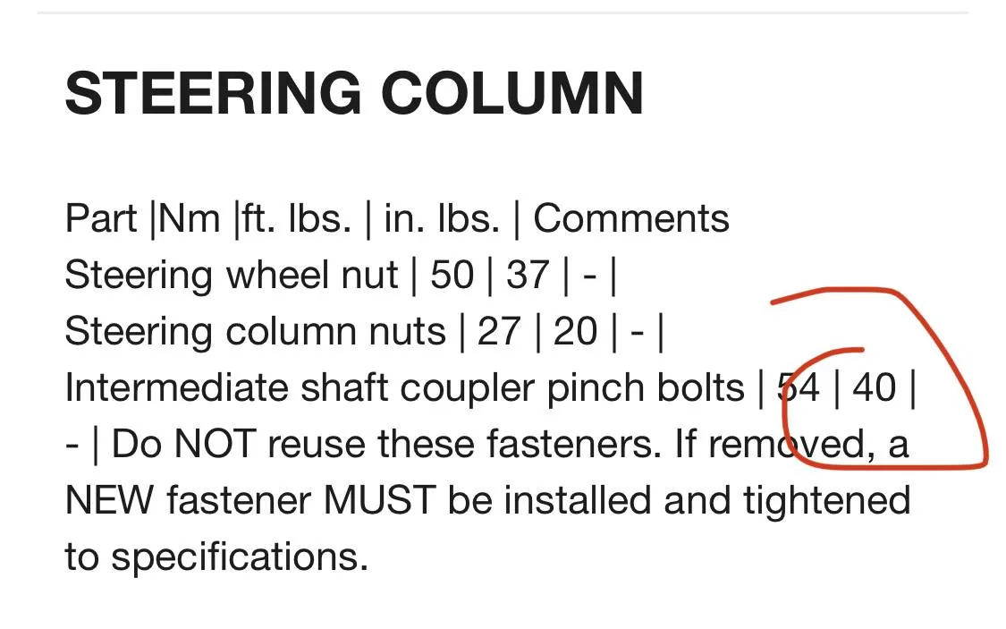

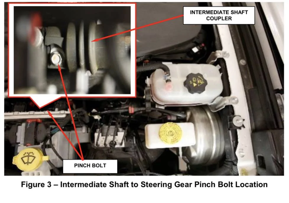

The main bolt to check immediately would be the I-shaft bolt. Here is torque spec and location of bolt under hood. There has been reports of additional dead spot when not tighten properly.
