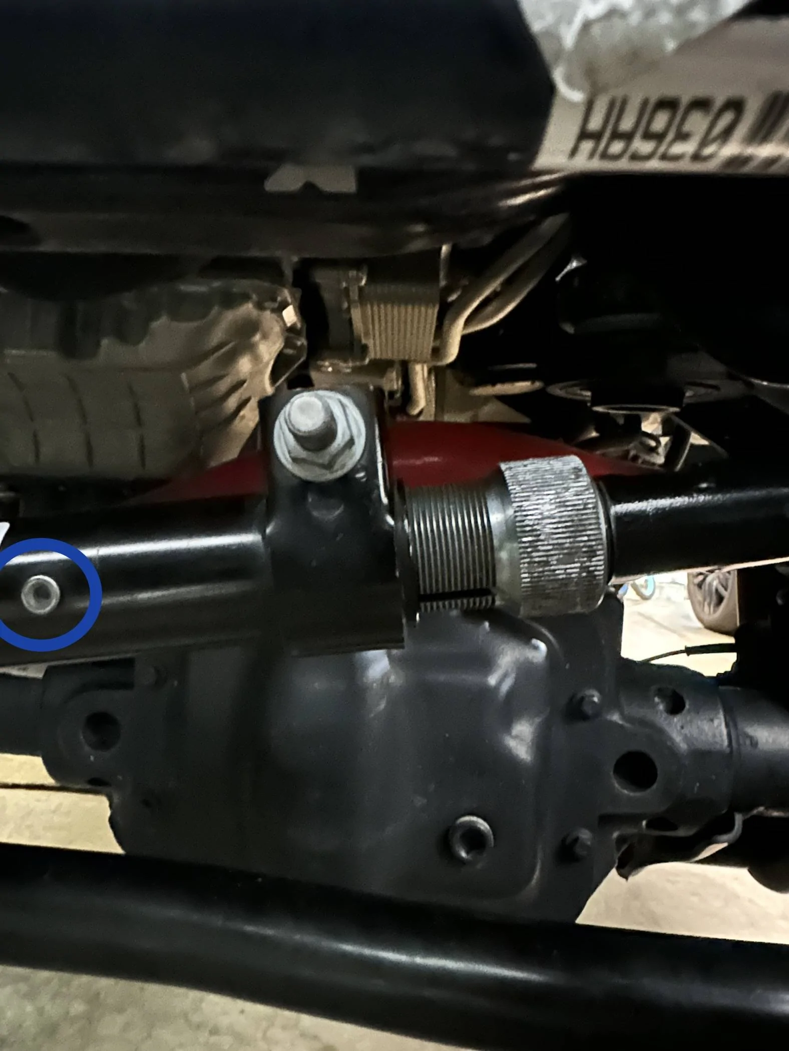

You tried to go the other direction and ran out of room as well ?
Yeah, went the other way and the adjuster almost came out of the socket.
I’m considering drilling out or trying to gracefully remove the pin circled in this photo. It seems like it may be blocking me from adjusting the extra little bit I need to.
