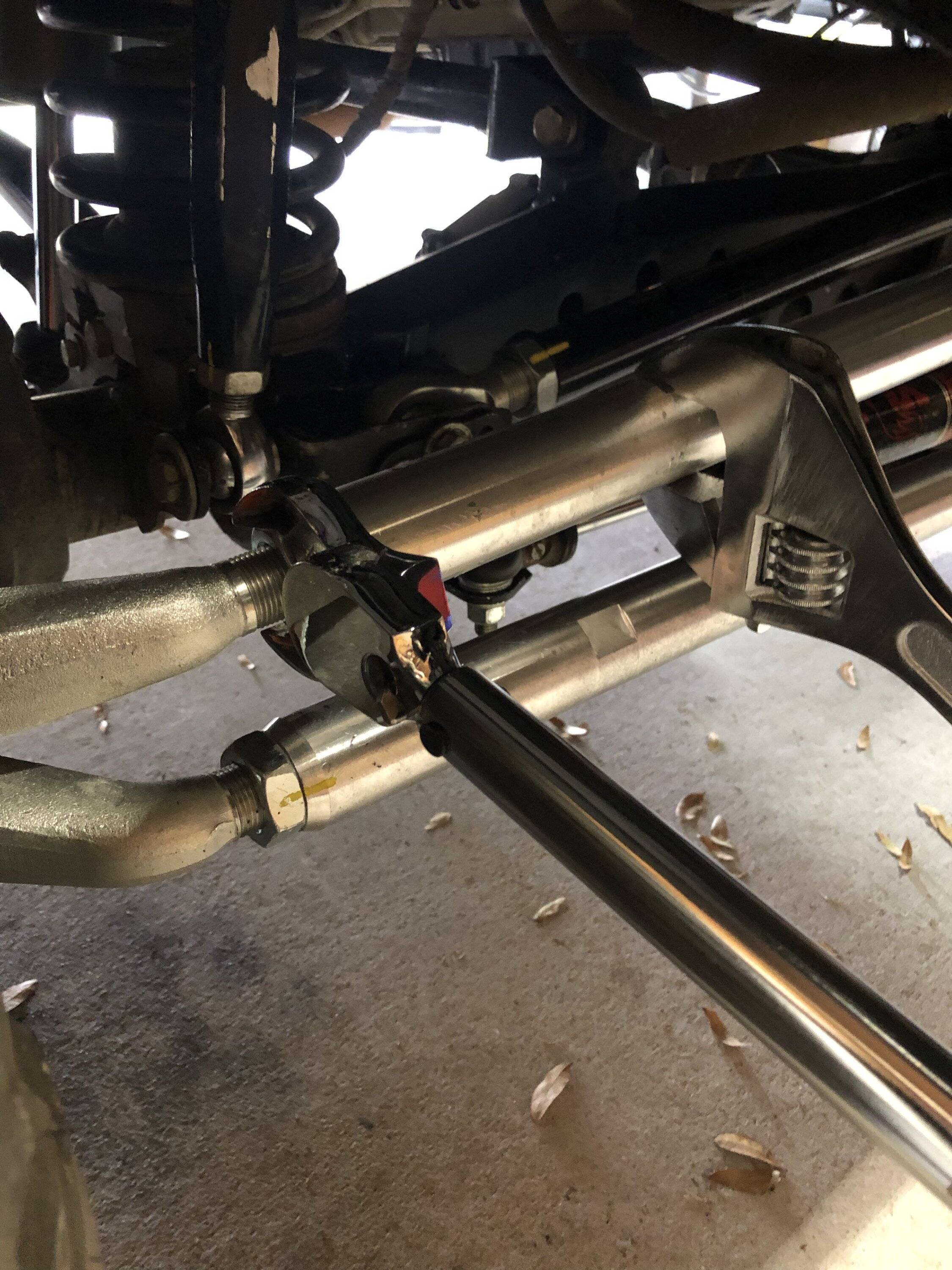

Same. Forgot to pack the big speed wrench and goofy 10mm 12 pt teraflex socket on my trip to Moab last week.
Either the steering wheel being off from wheeling, using the off-road plus button, or a combo of both caused my electronics to go haywire at the end of Cliffhanger. Think ESC was trying to engage while in 4L.

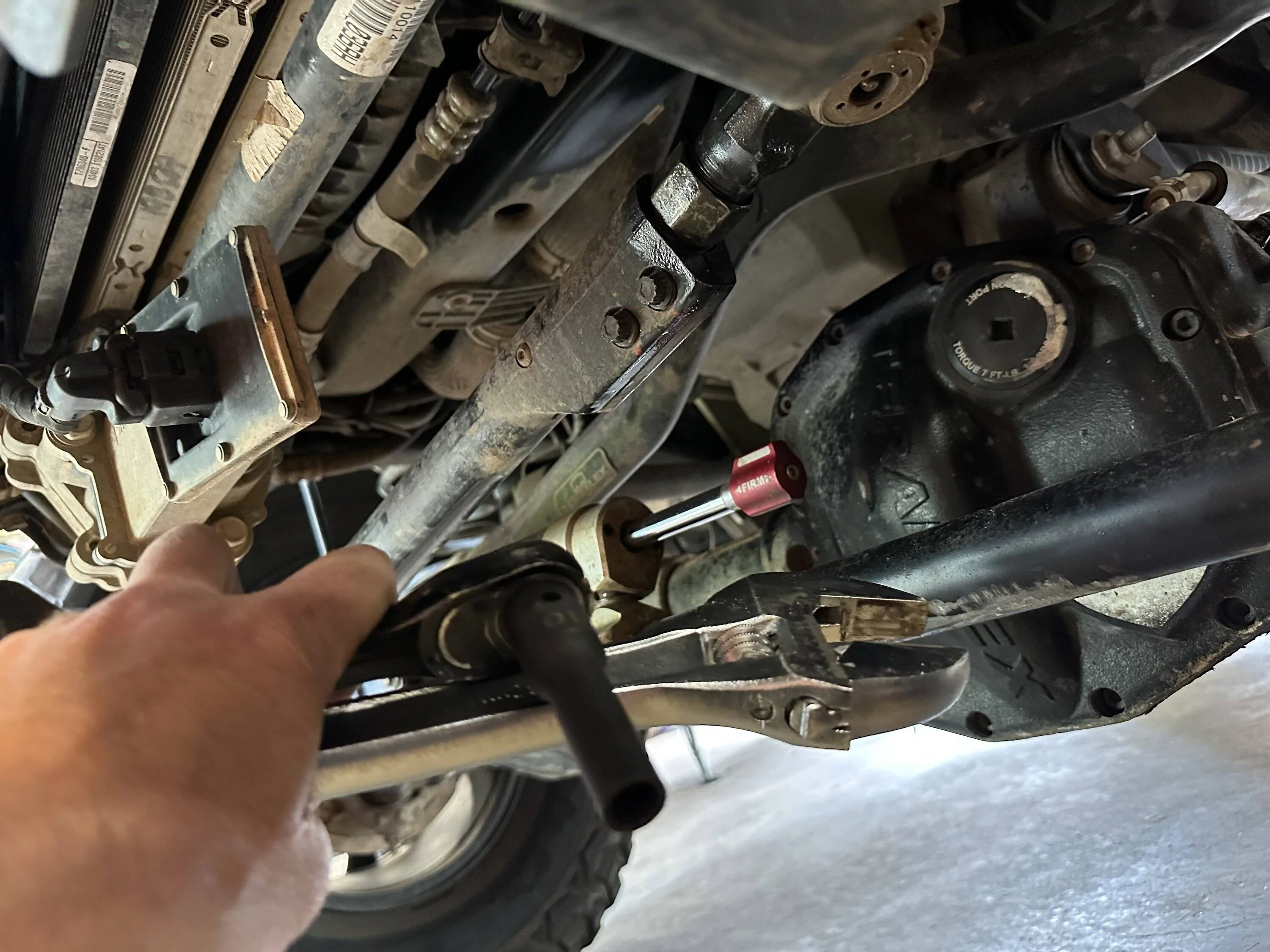

Yeah, copy that, I’m glad I’m not having this issue because to straighten my steering wheel I have to use a big f-ing wrench and a crow foot torque wrench and torque to 250 ftlbs …:facepalm:
