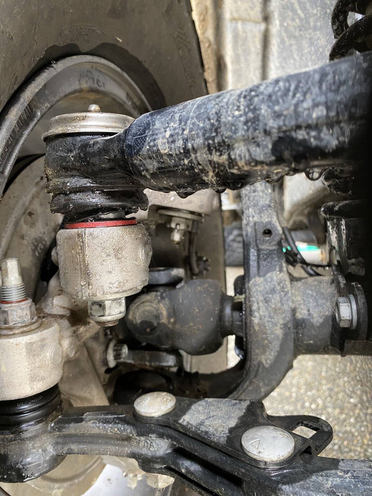

I was starting to wash and inspect my Jeep after getting home at midnight. I saw this on my draglink. I think I just need to re-grease, it’s been about 1k miles since my last top off. However, it occurred to me I may not have it tightened enough. I was properly torqued at install and 1k after install.
Anyone have thoughts or suggestions?

I dunno, there's not much you can do about it. Fortunately that joint is "upside down" so contaminants will naturally drain.

Well, re-inflating it didn't work. I can't seem to get it re-seated with pliers or a nylon panel tool (I'm trying to avoid damaging it). I think I'll try taking the wheel off tomorrow to get better angles and re-seat it by hand, maybe with an assistant.

Steersmarts suggested massaging it back into place and refilling. I couldn’t get one part down and that’s when I discovered the lower part of the boot was torn. Replacement on the way!

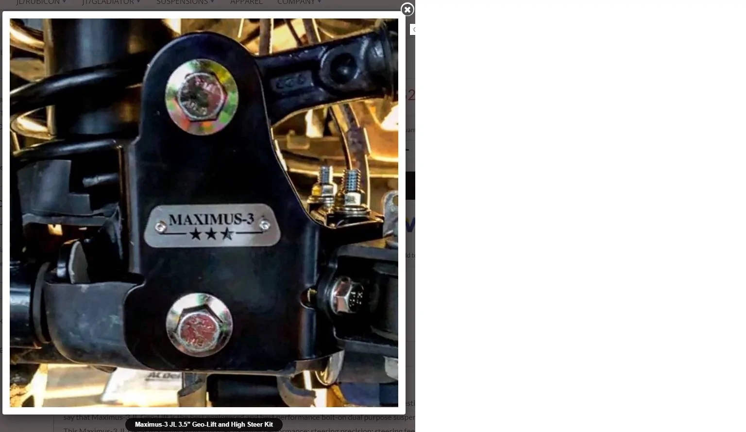

@Some Random Guy What track bar are you running? Any chance you can take a pic from the front of your track bar (frame side) that shows the steering box /pitman arm? I'm installing a flip kit now and finding I have interference with my trackbar and Steersmarts steering brace (specifically the extended nut portion that stabilizes the pitman arm) as I raise the axle end of the trackbar.

I'm still on the stock trackbar, but it's relocated. I'll try to grab pictures tomorrow. Here's a photo from the lift manufacturer's site:
Jeep Wrangler JL Drag Link boot issue? Maximus-3 Trackbar
So raised trackbar, and the steering stabilizer is moved too (lower right of this photo).

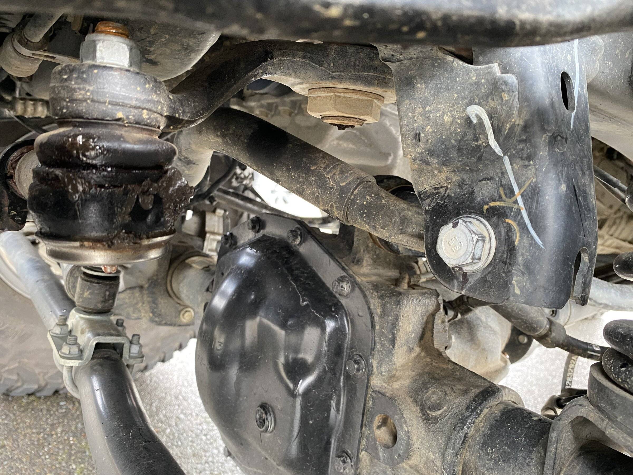

Jeep Wrangler JL Drag Link boot issue? 98936D37-4B15-4121-BFE7-1905C7DFD019
Does this help or do you need from underneath?
