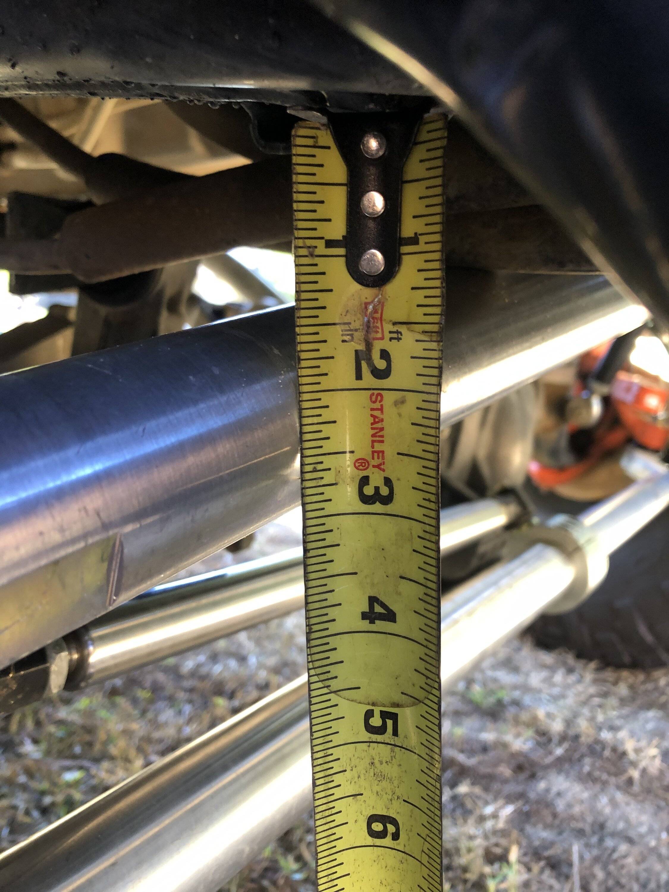

When I got my RK steering links (tie rod/drag link) I was considering flipping the drag link because apparently that was the only way to run the SS on top of the tie rod…..for whatever reason this info was not on their site :headbang: ……. I’ve since fabricated a bracket and it’s working great, but that’s a story for another day…… This is how much room I have at full stuff between the drag link and the frame……
Jeep Wrangler JL Drag link flipped? 48D72882-2DBB-4CE0-9A82-62767720A562
About an inch and a half, keep in mind, my bars are 1-3/4”. So I would have to run at least another puck of bump minimum, but one and a half to be safe….Running long travel shocks, I have only 5 ish inches of up travel, and I didn’t want to run any less……. My point is, your MC GC kit will have similar articulation, and you don’t want to constrict it, you want it to perform as intended, let the big dog eat..;)
It would first raise the thickness of the Reid knuckle mount, plus the 1.75" aluminum bar, and plus whatever small amount the rod end lifts the bar over the knuckle mount. An inch and a half added bumpstop spacing, and the drag link would still kiss the frame. 2" would probably be the minimum require to just clear, and that would suck to lose that uptravel just for the sake of a bit less bump steer feel.
Well there you go, even more reason not to go there….it was an avenue I visited to correct a problem that was immediately squashed…… I hacked up a MC bracket, now all is well…..lol…
